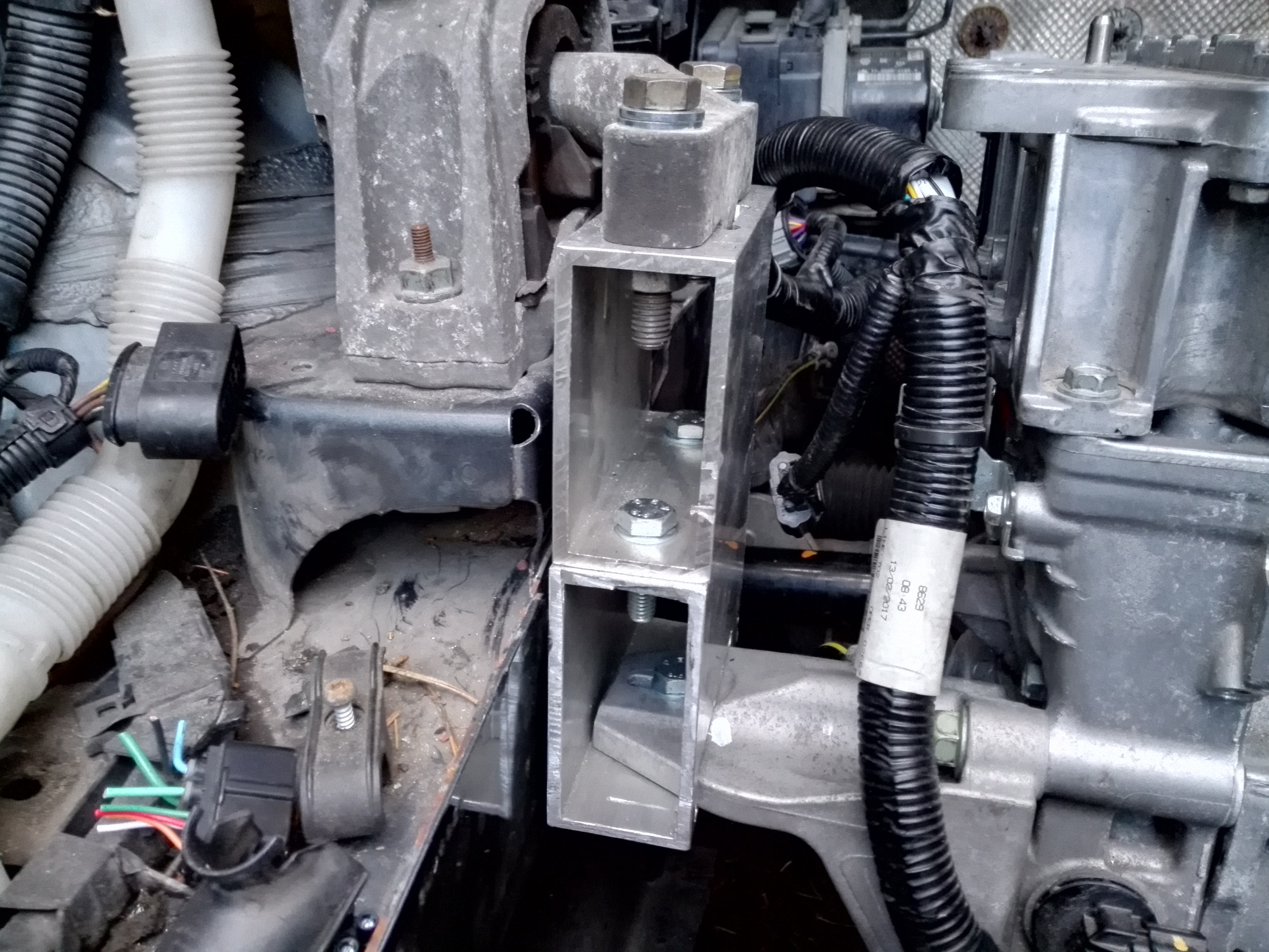

So this weekend was great. I had both Arber and his family and my father over to help me get back on track with the Touran conversion.
We test-mounted one battery brick (1/2 Leaf pack) under the car with no greater problems. The other half is residing in the boot right now. My dad could not stop working until we had this done at 23:00
The adapter plates between motor and transmission are pretty much sorted. I use two 300x80x40x4 profiles to cover most of the distance. They are connected by U-profiles mainly for water proofing. Then comes the actual transmission plates which we made with the jigsaw It is only 15mm and we found out the hard way that it better be 25mm - the shaft coupler is about 5-8mm too long. So I went to a random steel working company today and found a 100x460x8 aluminum plate in the scrap. Will saw it in half and thereby add the extra distance.
Mechanically I just need to make a motor mount and the drive drain is in, yay

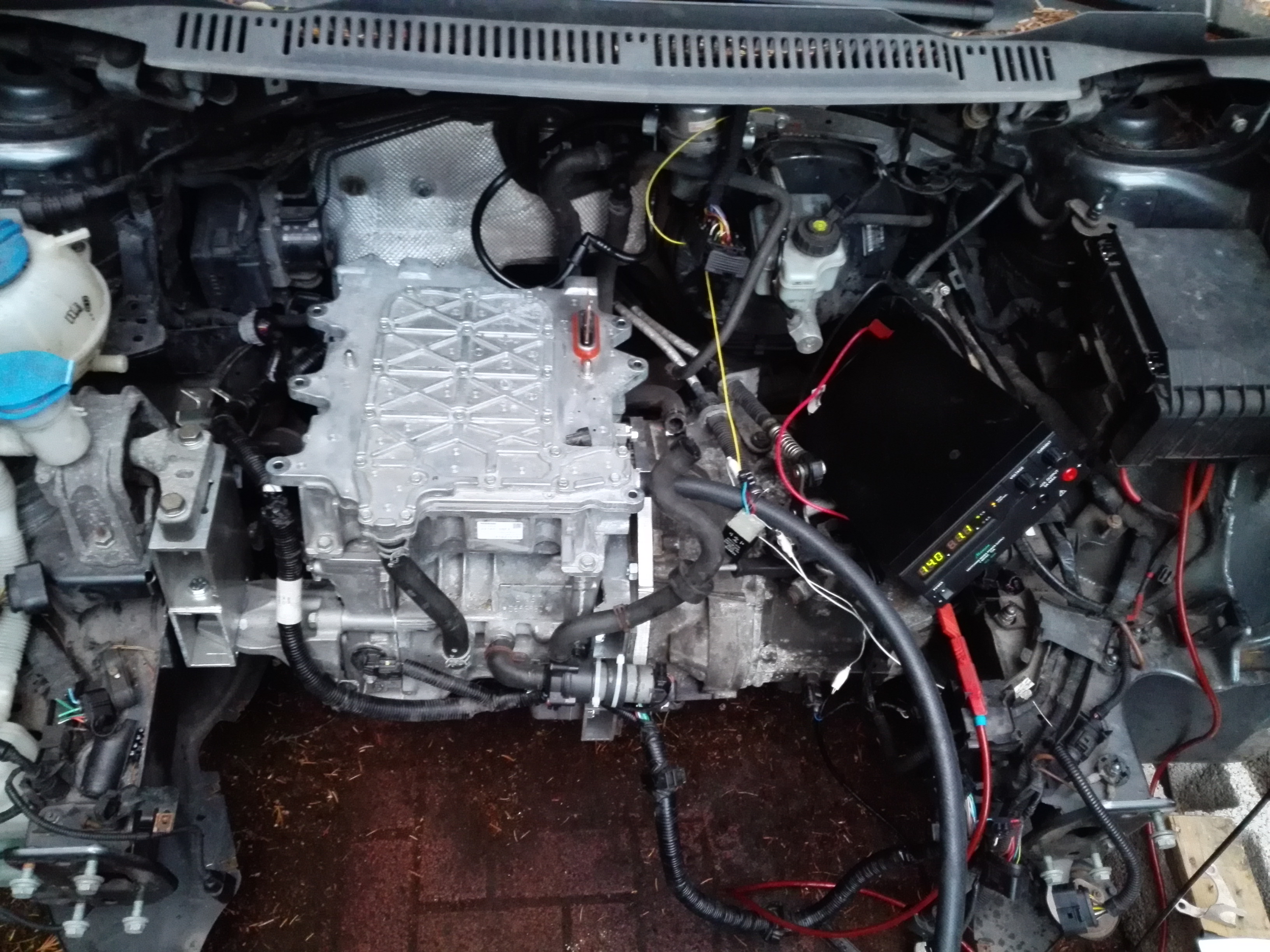

And transmission is in.
Now need to make a motor mount, connect up the drive shafts, make some temporary DC cables and off we go

You can cut that mount near the hole and make a hole higher up. As long as mount is flat under. Then buy one 6mm flat piece of steel cca 100mm x [whatever vertical] and get it bent under bottom. Fit one end in the mount and another down at the motor mount in such a way it will carry motor even if a bolt falls off.
Side mounts are only to stasbilize motor. Real bi*$#h it to fit the rear mount in. Does your rear mount come with transmission?
A
A
- Posts: 5873
- Has thanked: 172 times
- Been thanked: 1083 times
Well I believe I've sorta done just that, see below He who can't weld uses profiles and screws
Yes the rear mount is attached to the transmission, easy peasy.
I've installed the Leaf wire harness and connected it up to switched 12V and GND. Only CAN missing. I might tap into it at the power steering. Inverter is powered, I can connect to the wifi.
Also installed a coolant pump from Mercedes, it starts to run with the key switch. Haven't decided on what radiator to use yet.
Also rigged up the vacuum pump to be controlled by the new "ECU", works beautifully.
More annoyingly the car has developed and airbag fault. I wonder if my messing around caused it
Tomorrow I should be ready to spin some wheels.
