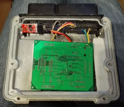

So I'm planning to put either a BeagleBone or a small embedded MCU into the original ECUs case. That way I have access to quite a few relevant signals and a nice waterproof case.
Hmm, to be honest maybe it's a bad idea to have throttle processed by a Linux machine?
EDIT: just thought about it further, I think I'll just use an Olimex STM32-H103. I have a good code base for it.

Well, here's an open ECU :D Seen that board before ?
So far I've hooked up throttle, vacuum sensor and CAN bus. It runs almost stock inverter firmware ;) I can play around with the rev counter and more importantly I can put throttle on CAN bus.
Now I have to find out why it throws a low oil pressure error as soon as revs exceed 1000rpm or so.
I'm thinking it's either a bit on the CAN bus or the oil pressure switch is looped through to the display unit. Anyone?

Yes the Dashboard receve the oil pressure information as on the old vw.
I think if there is no information you may have an alarm over 1000 rpm.

Yes, found it today :)
The alarm indeed starts only above some rpm. But there is also a reverse alarm: if you pull the signal to ground (=oil pressure ok) at 0 rpm you get a STOP! message also. So I either have to live with this or pull the signal to ground selectively with my custom "ECU"
