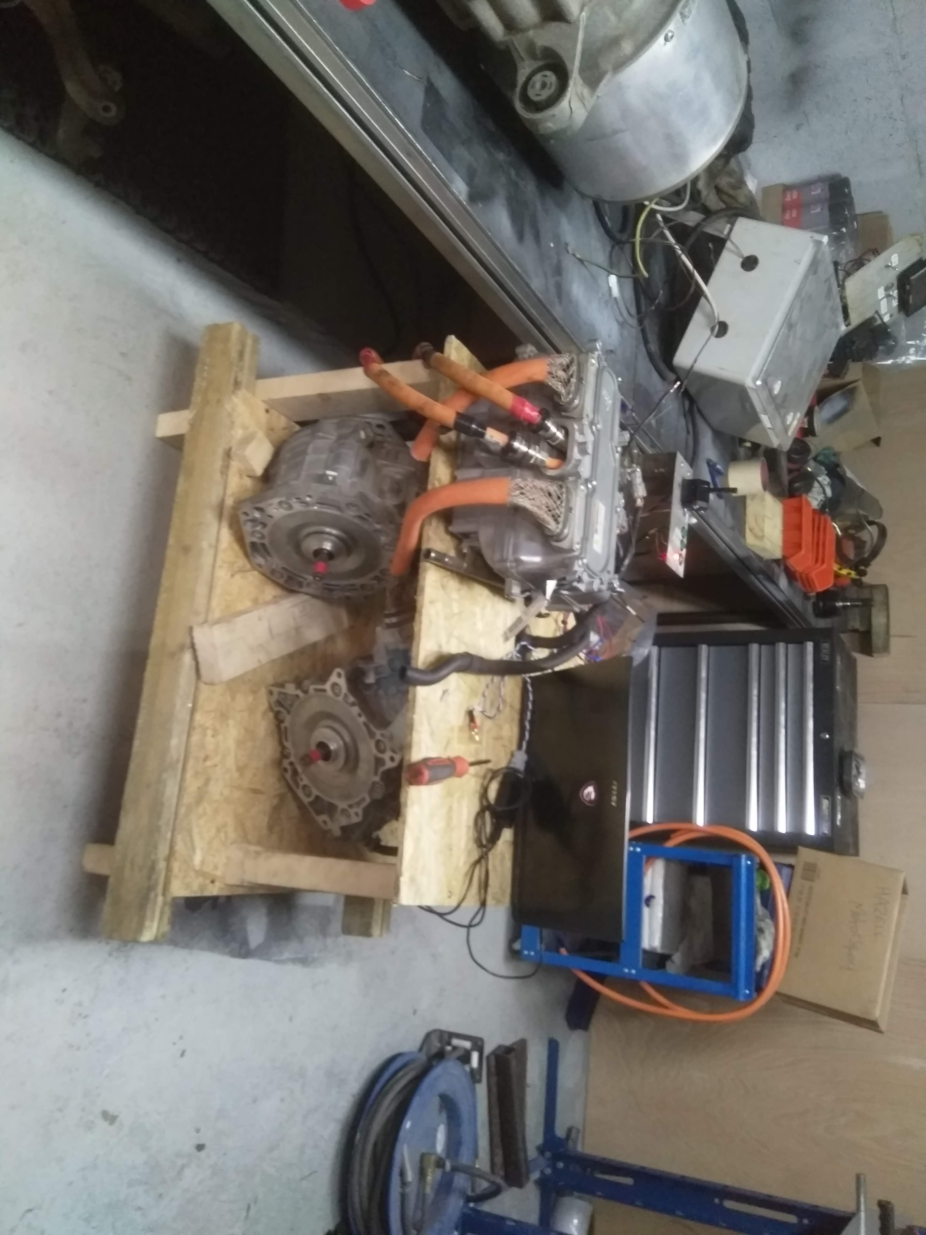

I have Mitsubishi Outlander rear motor and front inverter in my workshop with resr inverter incoming.
I have 9kW VW Passat battery for testing here.
Also i have my CAN tools, EVTV CAN DUE and Canalyst II so i can talk to my devices.
I would like to get to testing, but i dont have Outlander anywhere i know...
I see motor PIDs for torque are:
288_FrTrq,Front Trq,220288,(A*256+B-10000)/10,-200,200,Nm,
289_RrTrq,Rear Trq,220289,(A*256+B-10000)/10,-200,200,Nm,
28B_GenTrq,Gen Trq,22028B,(A*256+B-10000)/10,-200,200,Nm,
But that is only reporting no? Does someone have command ID for torque?
@Dilbert can you tell what mesages you use to get the front and rear inverter running?
tnx

You checked the link i provided?
287_FrTrqReq,Front Trq Req,220287,(A*256+B-10000)/10,-200,200,Nm,
287_RrTrqReq,Rear Trq Req,220287,(C*256+D-10000)/10,-200,200,Nm,
287_GenTrqReq,Generator Trq Req,220287,(E*256+F-10000)/10,-200,200,Nm,
287_G,287_G,220287,G,0,255,Cnt,
287_H,287_H,220287,G,0,255,Cnt,
I hope to have more info to share soon, but yes it spins real easy.
Main issues are:
-all battery limits are to be done by external control
-Torque is direction relevant, so going forward, positive is motoring and negative is regen. In reverse rotation other way around.
-Direction is not selected but done via reversing torque sign, see above.
Working together with Phil, Pemtek here on the forum, to get a VCU designed and programmed to make control of these motors easier. Also will be integrating DCDC Charger and BMS functions.
Be careful, these motors have VERY low inertia any torque command (even 1Nm) will make them spin up and climb to max RPM (13K rpm for the front motor). Currently the full command sets are still t be discovered so we can have a level of safety and knowledge before fully disclosing all info.

First i went on and measured the motor.
I measure 50mH one the phases. I gather Lebowski will work with 230uH per phase
Resistance is 0.38Ohm from U to V, so cca 180mOhm per phase, but i found out you must multiply this dependent on inverter frequency. I use 3x the value at 6kHz so 188mOhm per phase. This is for someone who wants to use it with Lebowski brain. I need to confirm this stll. Stay tuned.

got all motors spinning with OEM inverters
There are so many quirks to controlling these, it will take quite some work getting a usable control software written.
Hope to get a rear motor fitted to a test vehicle soon.
