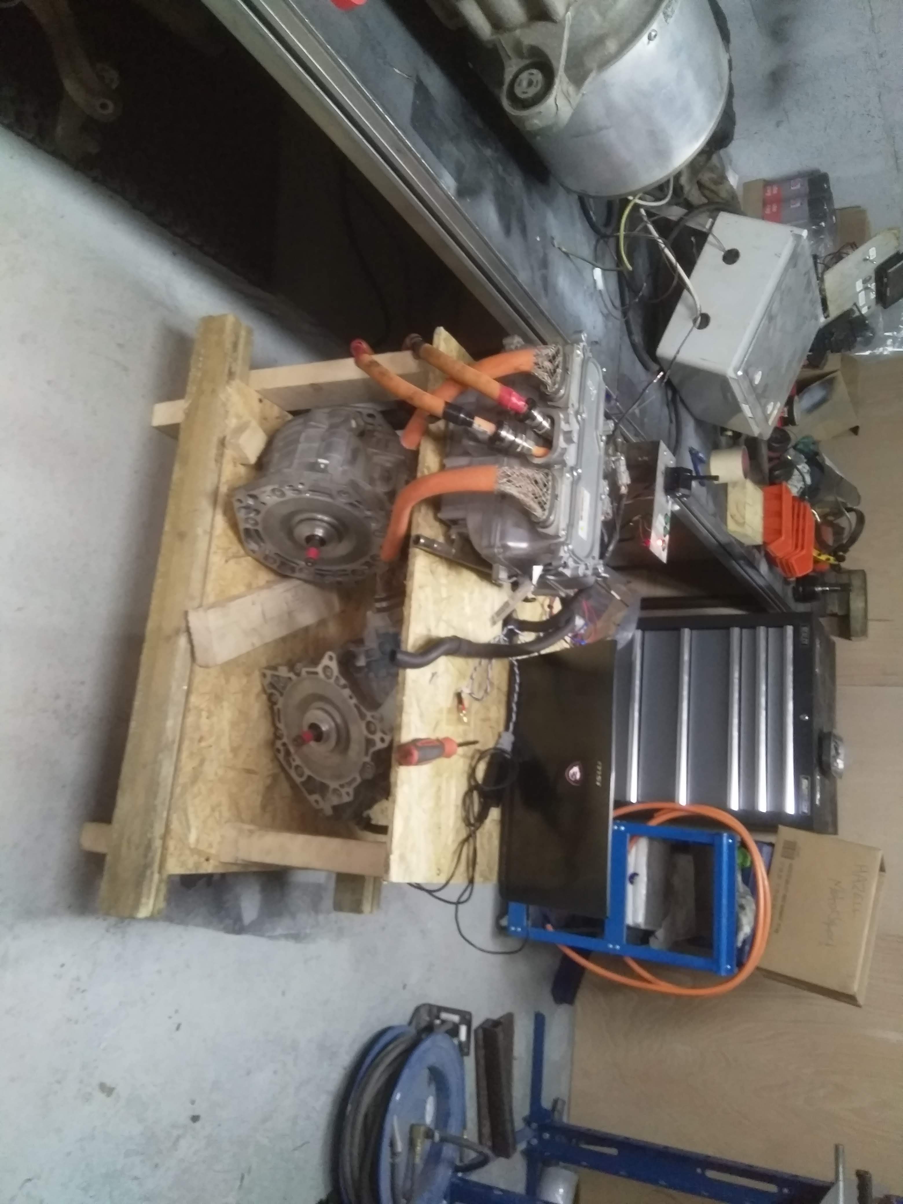

I have Mitsubishi Outlander rear motor and front inverter in my workshop with resr inverter incoming.
I have 9kW VW Passat battery for testing here.
Also i have my CAN tools, EVTV CAN DUE and Canalyst II so i can talk to my devices.
I would like to get to testing, but i dont have Outlander anywhere i know...
I see motor PIDs for torque are:
288_FrTrq,Front Trq,220288,(A*256+B-10000)/10,-200,200,Nm,
289_RrTrq,Rear Trq,220289,(A*256+B-10000)/10,-200,200,Nm,
28B_GenTrq,Gen Trq,22028B,(A*256+B-10000)/10,-200,200,Nm,
But that is only reporting no? Does someone have command ID for torque?
@Dilbert can you tell what mesages you use to get the front and rear inverter running?
tnx

You checked the link i provided?
I hope to have more info to share soon, but yes it spins real easy.
Main issues are:
-all battery limits are to be done by external control
-Torque is direction relevant, so going forward, positive is motoring and negative is regen. In reverse rotation other way around.
-Direction is not selected but done via reversing torque sign, see above.
Working together with Phil, Pemtek here on the forum, to get a VCU designed and programmed to make control of these motors easier. Also will be integrating DCDC Charger and BMS functions.
Be careful, these motors have VERY low inertia any torque command (even 1Nm) will make them spin up and climb to max RPM (13K rpm for the front motor). Currently the full command sets are still t be discovered so we can have a level of safety and knowledge before fully disclosing all info.
287_FrTrqReq,Front Trq Req,220287,(A*256+B-10000)/10,-200,200,Nm,
287_RrTrqReq,Rear Trq Req,220287,(C*256+D-10000)/10,-200,200,Nm,
287_GenTrqReq,Generator Trq Req,220287,(E*256+F-10000)/10,-200,200,Nm,
287_G,287_G,220287,G,0,255,Cnt,

Just build it into a car, the rear motor and inverter will work.
I do not have any specs on the motor. But why spin it with different inverters? The OE inverter works fine to do this unless you want to push the limits of the motor.
As far as i am aware there is a speed limit in the firmware, however a motor spinning at 9-13K rpm is not really a safe thing to have around.

First i went on and measured the motor.
I measure 50mH one the phases. I gather Lebowski will work with 230uH per phase
Resistance is 0.38Ohm from U to V, so cca 180mOhm per phase, but i found out you must multiply this dependent on inverter frequency. I use 3x the value at 6kHz so 188mOhm per phase. This is for someone who wants to use it with Lebowski brain. I need to confirm this stll. Stay tuned.

got all motors spinning with OEM inverters
There are so many quirks to controlling these, it will take quite some work getting a usable control software written.
Hope to get a rear motor fitted to a test vehicle soon.

Hello All,
Have just got a rear motor and inverter. Came with the resolver cable and a bunch of HV cables so that's handy.
Looks like the Vehicle connector is out of stock on digikey and apparently obsolete according to mouser... Anyone found any spares (or happen to have any lying around?)
Will get a test setup going and join in the Reverse Engineering fun.
- Posts: 3796
- Has thanked: 166 times
- Been thanked: 413 times
I have the same problem. I am thinking of cutting the harness off and extending wires out of inverter through my own grommet. It's only like 6 wires. Then I would put a standard sealed connector on them.
Wouldn't look as nice as original, but it would be functional.
Has anyone had luck with 3D printing connectors? Not sure if the resolution and accuracy will be high enough, but I'll give it a go. Would be useful if anyone can identify an alternative female pin which fits the male pins, I don't have many lying around.
Also, split my motor off today to try and measure the splines. Looks like it's 20mm with 18 splines. Then went on a hunt for a clutch disk similar. Seems the Suzuki Jimny SJ410 (1.0 litre) has that size. Don't suppose anyone here would happen to have one of those to hand?
I've also got some fairly good measurements of a drive which I'll use to start drawing up an adaptor. This is going on a VW beetle gearbox.
