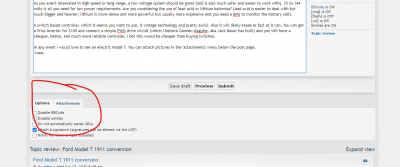

In any event I would love to see an electric Model T. You can attach pictures in the 'attachments' menu below the post page. -Isaac
