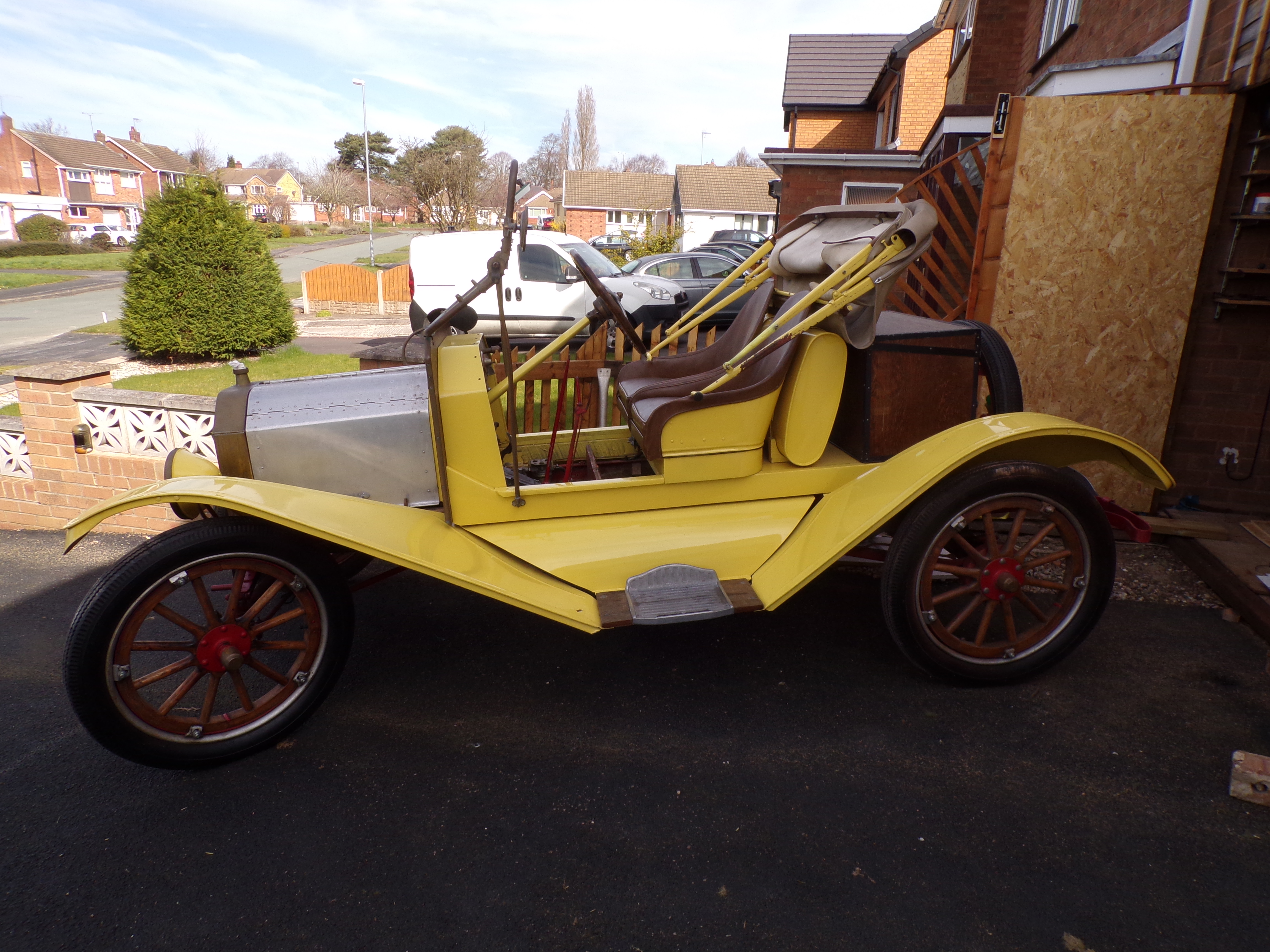

Hi, I have a beautiful vintage car, she is lovely in all aspects except for her ugly emissions, and so I want to convert her to EV, she is over 100 years old and with wooden wheels so speed is not top of list, nor is efficiency and nor is range, maybe most 30 miles, I have looked at most systems but many far too expensive for my needs, I cannot understand why there is little economical choice of motor and control, all I really want, is a 8kw to 10kw motor, DC, preferably brushed, 3 gear switch ie 2 or 3 or all 5 batteries, direct drive or belt/chain, through the existing gear box which is 85% eff in forward, I know this sounds clunky, but she is already clunky so no difference there then, need the existing gear box, to retain as much as possible, the original features but also it contains the, 6 volt dynamo and the foot brake, any offers of help would be very much appreciated, I would show a picture, but I am new on here and don't quite understand how to, maybe my age, I am 78

here is my Ford model T
