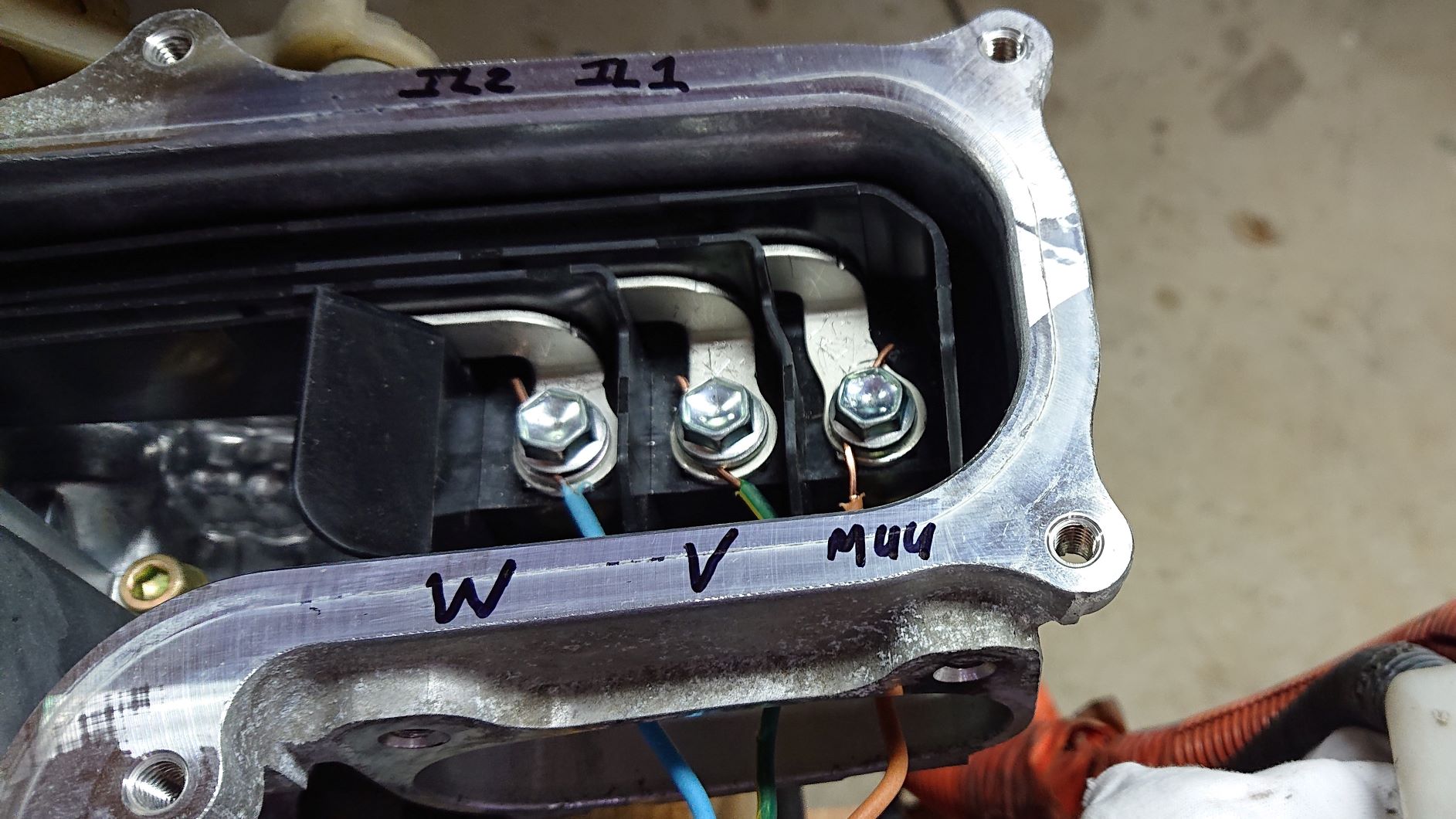

Even though I have Mg1 spinning under throttle control and 2amps current on 12 volt setup, I would like to proceed and verify Il1 and Il2 locations along with PWM outputs. Can I use the Sine procedures in Foc?
Here is the setup before "Pinswap", and would like to test the new configuration in Foc mode.
Before pinswap
Before pinswap

Got Foc set up on the bench, and trying to verify pinswap functions.
AFAIK, pinswap is only in FOC firmware. So I have noted my currents (that need swapping) along with PWM signals.
If I do any of the pinswap drop down selections in Foc mode, no modifications appear at inverter for currents or pwm.. (after update, refresh and restart of board)
I had to physically swop cables last time round.
Since I'm planning on bumping up voltage, and using original prius connections, I can't go swopping cables around.
Any ideas? What am I missing?
ZooKeeper
Posts: 526
Location: USA
Has thanked: 8 times
Post by ZooKeeper »
I am not sure what, if any, pinswaps are needed for the Prius Gen2 inverter powering the Gen2 transaxle. My guess is only the current sensors as the MG2 connections between the Inverter and motor are as in the vehicle I presume??

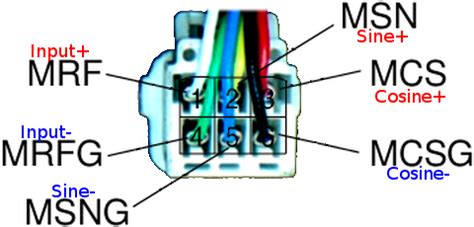

Been thanked: 64 times
Post by RetroZero »
imwoody36 wrote: Thu Jul 16, 2020 10:13 pm greetings everyone,
Ive a question about resolver connections.
I believe these are the colors and signals for the gen2 prius MG1 resolver( and if anybody has MG2 connections I can easily find the colors by the attached photo)
Any chance of putting up a picture of MG2 resolver wiring diagram please?
ZooKeeper
Posts: 526
Location: USA
Post by ZooKeeper »
RetroZero wrote: Mon Aug 31, 2020 5:42 pm Any chance of putting up a picture of MG2 resolver wiring diagram please?
Prius Encoder/Resolver
