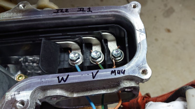

Got Foc set up on the bench, and trying to verify pinswap functions.
AFAIK, pinswap is only in FOC firmware. So I have noted my currents (that need swapping) along with PWM signals.
If I do any of the pinswap drop down selections in Foc mode, no modifications appear at inverter for currents or pwm.. (after update, refresh and restart of board)
I had to physically swop cables last time round.
Since I'm planning on bumping up voltage, and using original prius connections, I can't go swopping cables around.
Any ideas? What am I missing?
I am not sure what, if any, pinswaps are needed for the Prius Gen2 inverter powering the Gen2 transaxle. My guess is only the current sensors as the MG2 connections between the Inverter and motor are as in the vehicle I presume??

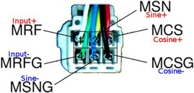

Any chance of putting up a picture of MG2 resolver wiring diagram please?
