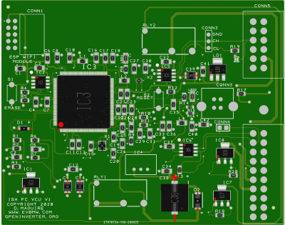

Are you sure about R19 in the ISA CAN version? Doesn't it have to be between CAN H and CAN L ?
Posts: 3663
Has thanked: 11 times
Been thanked: 344 times
Wow I am a moron! Nice catch. Updated.

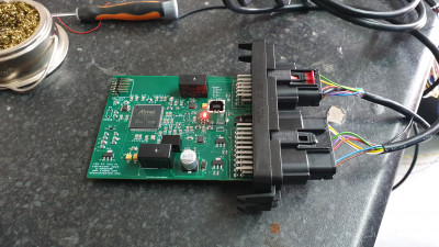

In production at JLC.

Posts: 3663

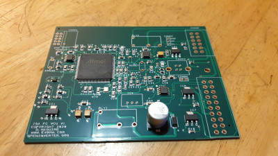

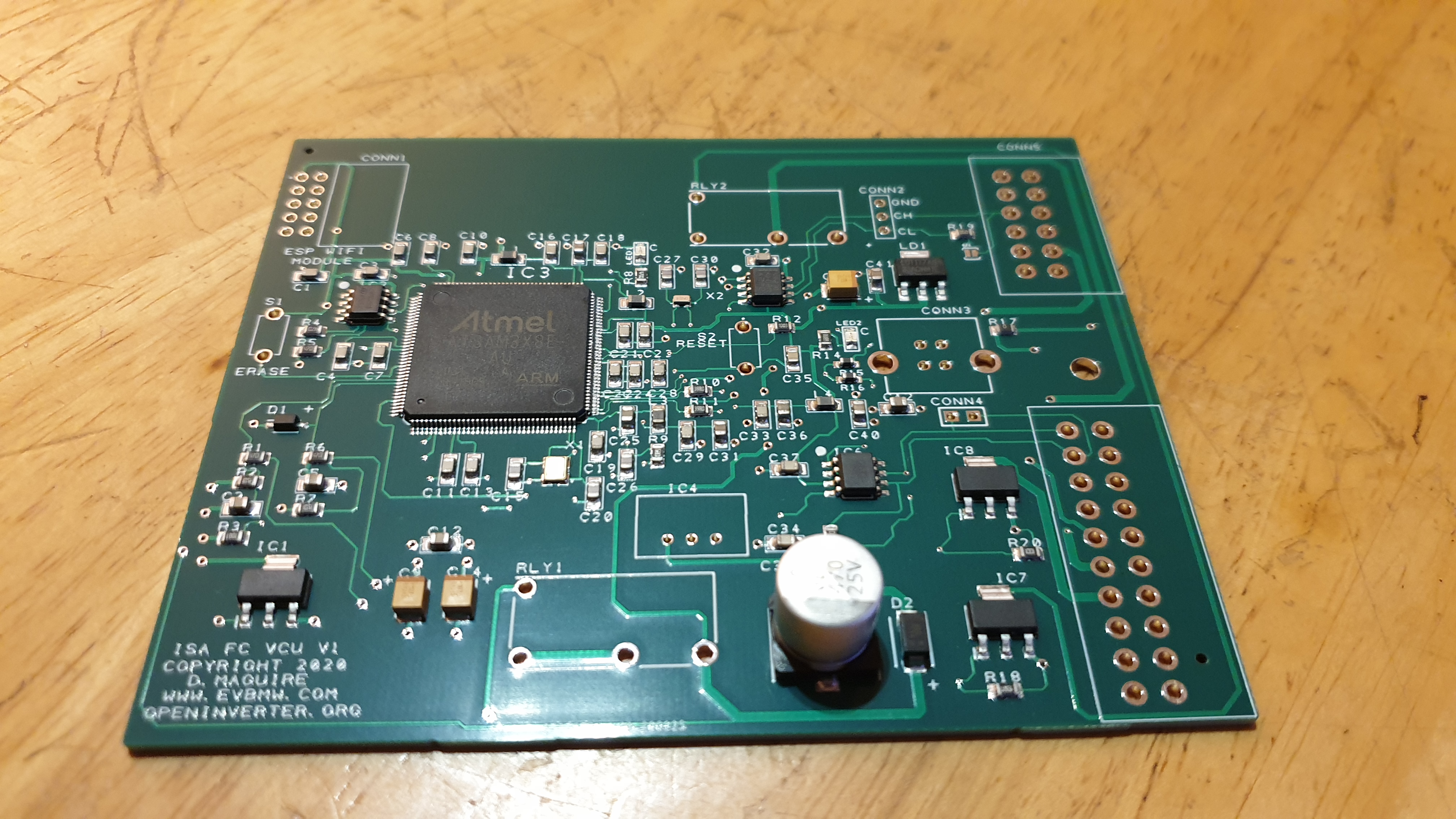

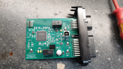

Boards just arrived from JLC. Once tested will be available in the webshop.
Posts: 3663
Looking good on the bench. Pinout attached.
