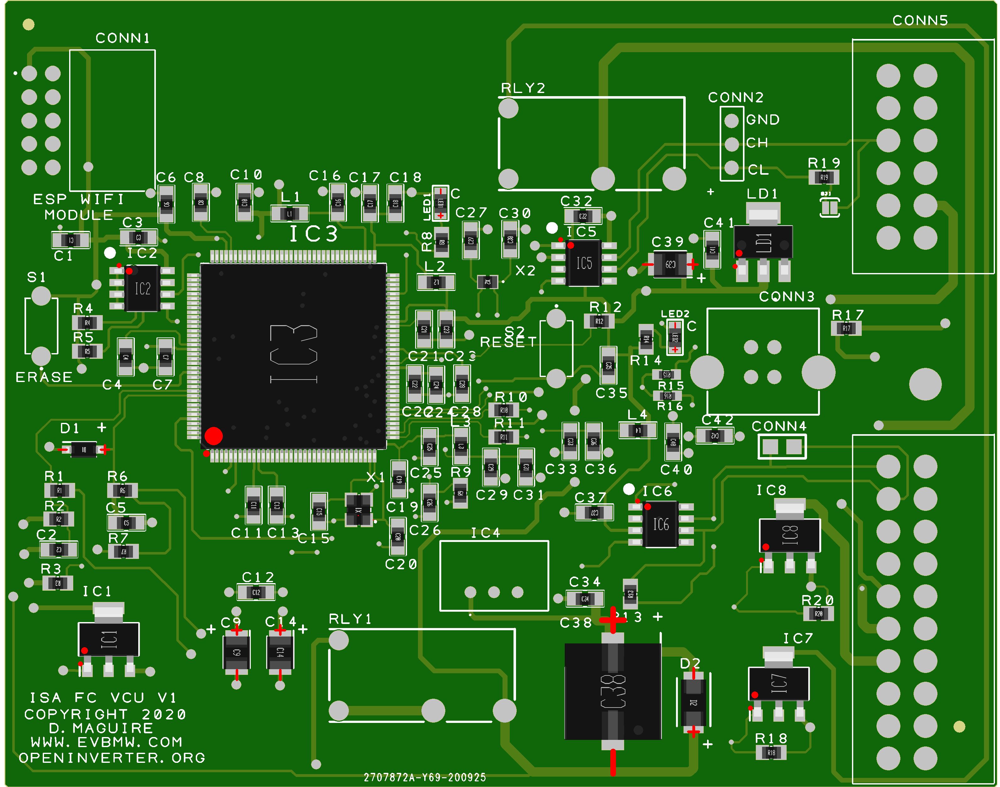

Are you sure about R19 in the ISA CAN version? Doesn't it have to be between CAN H and CAN L ?
Posts: 4007
Been thanked: 1139 times
Wow I am a moron! Nice catch. Updated.

Isaac96
Posts: 656
Post by Isaac96 »
Sebuś wrote: Thu Sep 24, 2020 8:11 am I have CHAdeMO (PCB v1). I produced them quite a long time ago. Does v1 work? I want to install them in Fluence (equivalent to Leaf gen.1).
I need 15kW-20kW charging max. Can version v1 be used for this? What are the problems and why was V2 created?
As Damien said, V2 uses the ISA shunt to deal with HV measurement - this improves accuracy, precision and safety (no silly HV wires running into the mainboard).
V2 also has a SAM3X processor - far more space for whatever extra functions are needed. So the V2 software will not work with V1. The old v1 software might do the job for you.

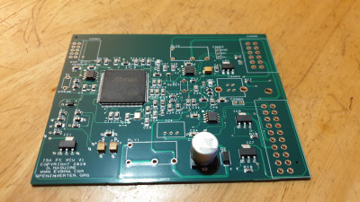

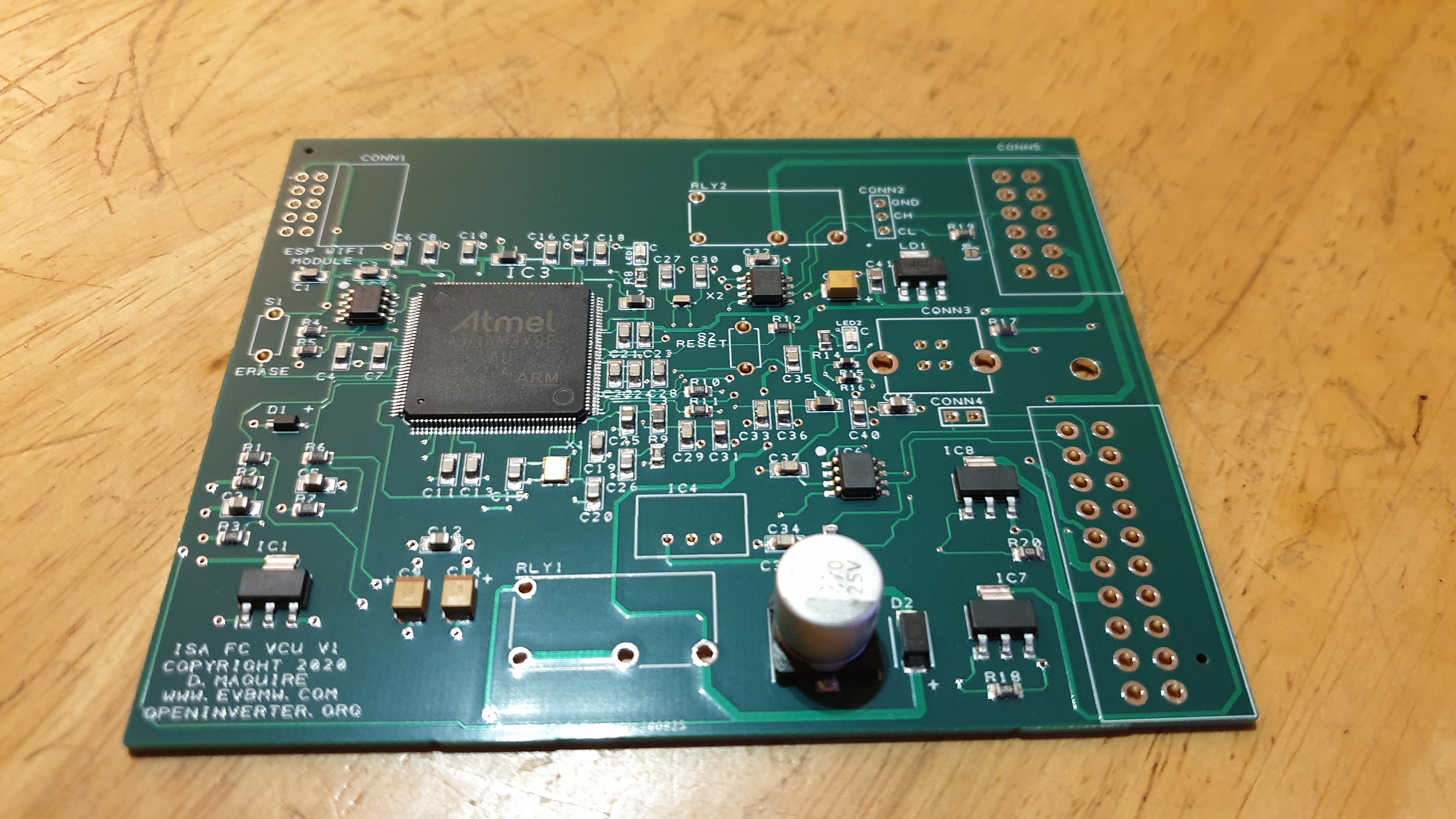

Posts: 4007
In production at JLC.
Isaac96
Posts: 656
Post by Isaac96 »
Great! I'll be testing the latest code revision (0.7) as soon as I get my coolant system back together, then that will be published.
Posts: 4007

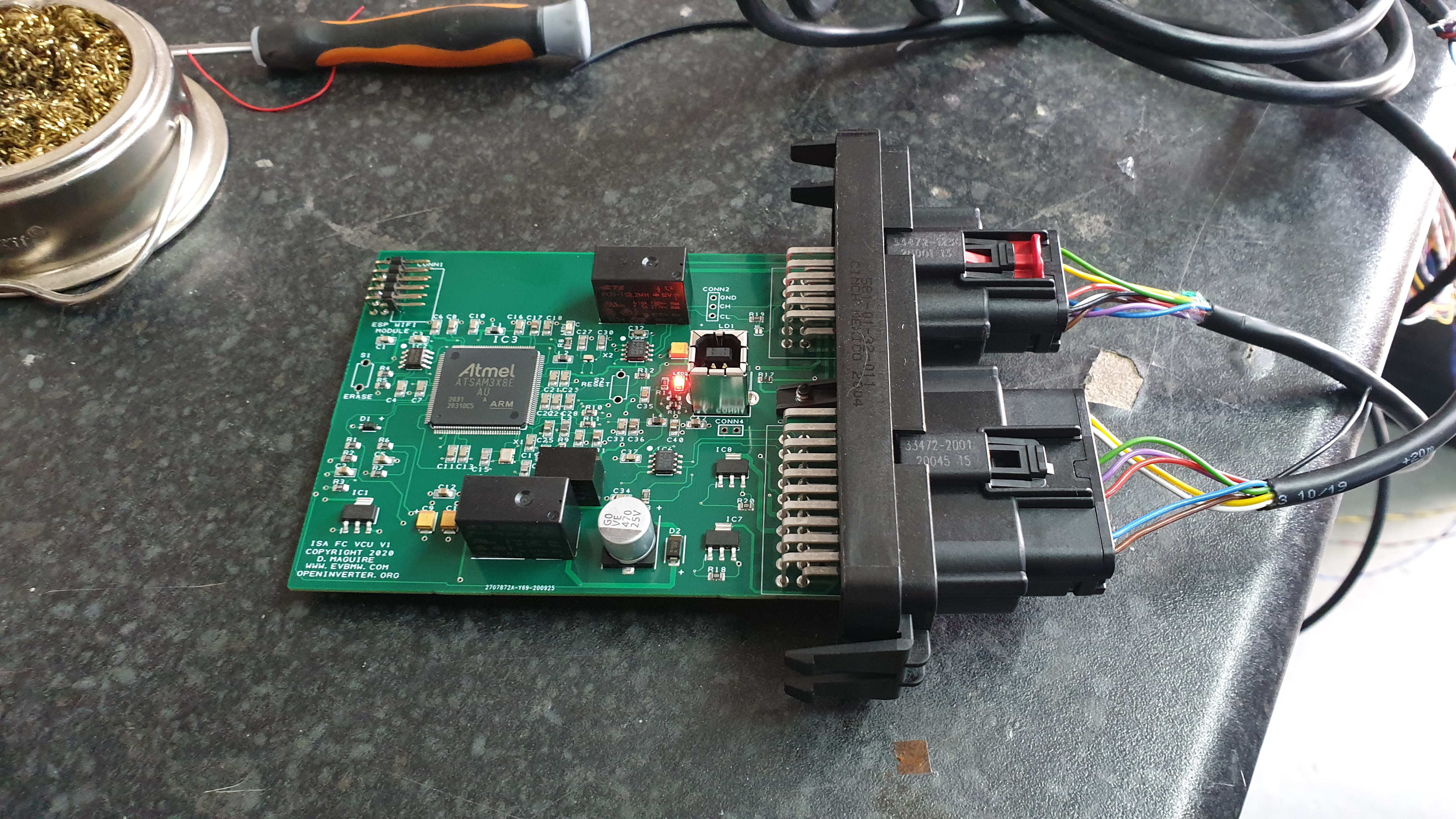

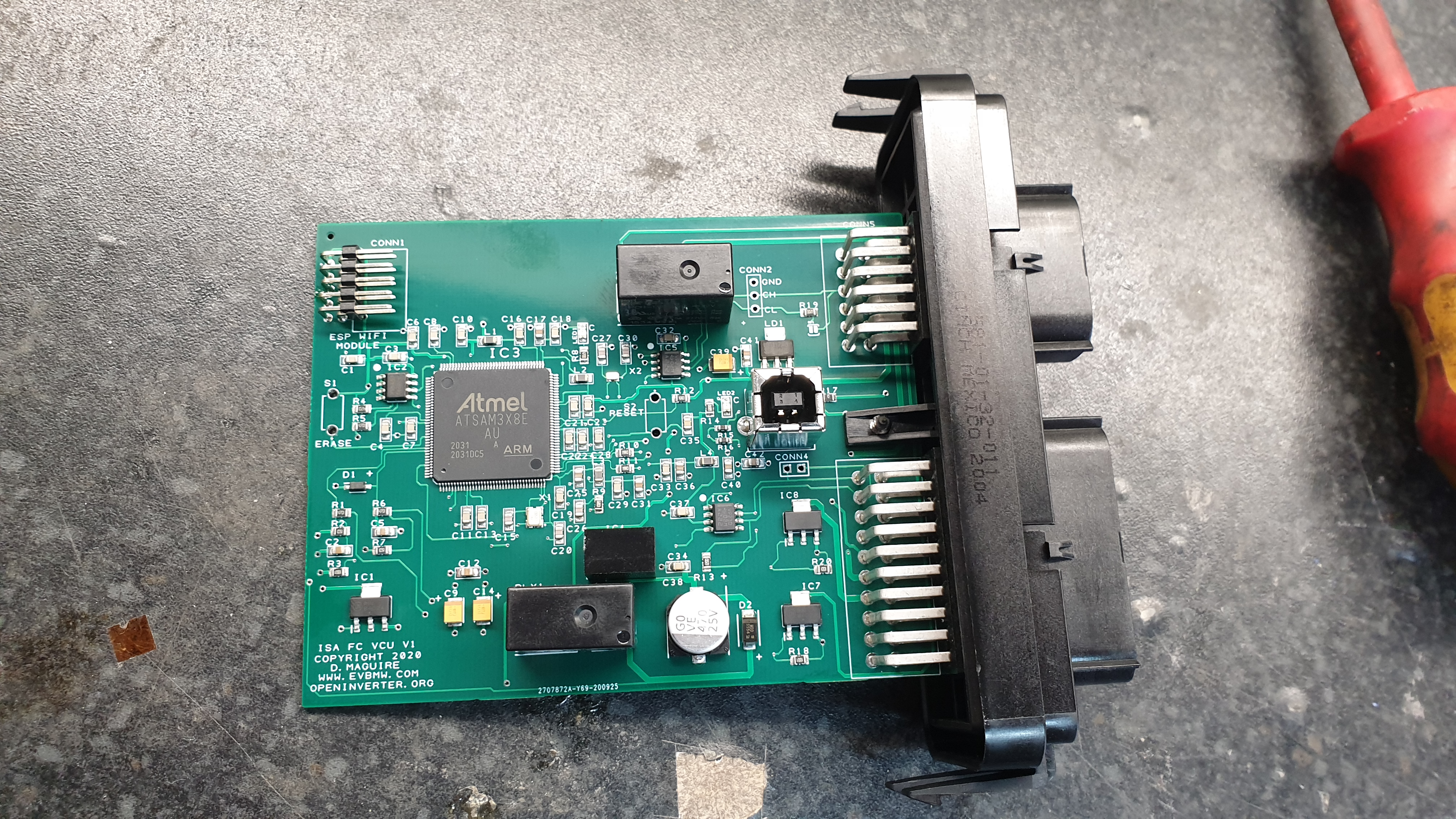

Boards just arrived from JLC. Once tested will be available in the webshop.
Posts: 4007
Looking good on the bench. Pinout attached.
Chademo_ISA_VCU_V1_Pinout.pdf
(47.38 KiB) Downloaded 576 times
