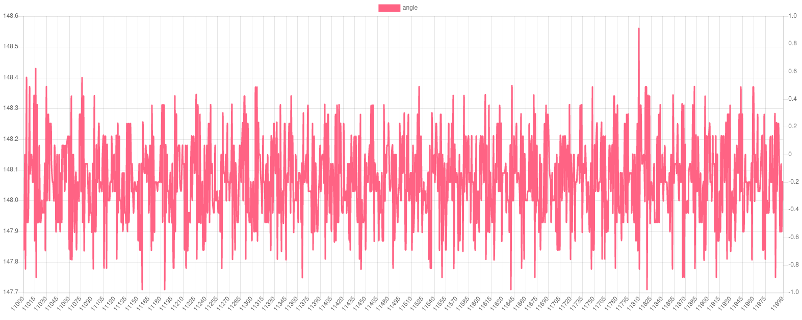

Alright, first off here is the plot I took in Touran. You can see jitter is just 0.7°. And that is with PA0 still configured as input with pull down.
Then I flashed the software attached in my previous post to my test board without seeing any improvement. Still 20mV dips and angle jitter around 5°.

I have changed the injected sequence from 0, 6, 7 to 6, 6, 7
The result is indeed a cleaner angle plot and about 1.5° jitter on my test board. With 10k/1nF low pass that is.
Also played with sample times, increased them to 13.5 clocks but that didn't make any difference.

Improvement when using 1k/10nF instead - 0.7° jitter

Excellent!!
Now the results.
First only logging angle to sample every data point possible.
Zoom at first spike.
Zoom at 8th spike.
Remember some points are logged twice, hence the flats.
