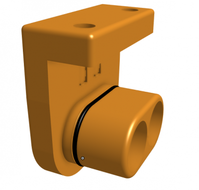

3D printed connectors work fine, the pins mate to the standard Dupont style 2.54mm connectors.
Main issue will be getting it to be waterproof which will take some application of sealant.

Will also design some blanks/gland plates for the auxiliary power, DC and Motor ports.
I've got a rough design drawn up of the motor flange, will print this out to check the accuracy.

If I made a few of these, would anyone be interested in some? Can either make with Cable Glands (can only really fit M12), as blanks, or custom.
This is the first design so need to trial and iterate, but any recommendations gladly accepted! Obviously for development purposes only!

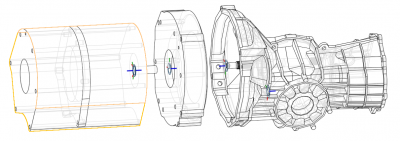

I've been working on a coupling to a VW gearbox:
I can foresee the driveshaft coupling being a challenge with the splines - anyone have any advice on this? I'm hoping to find a suitable clutch plate (still waiting for the Suzuki Jimny one to arrive) but don't want to have to have a custom shaft coupling made if I can avoid it. Although I did consider whether a low cost way to achieve this would be by laser cutting the splines from thick plate.
Kevin Sharpe
Posts: 1339
Location: Ireland and US
Been thanked: 8 times
Post by Kevin Sharpe »
ScottS wrote: Sun Jun 21, 2020 1:05 am I can foresee the driveshaft coupling being a challenge with the splines - anyone have any advice on this?
iirc the last coupler we had made was 80 euro and just required the gearbox and motor at the engineering workshop for a couple of days (they also made an adapter plate at the same time). Watch from 5:00 in this video;
viewtopic.php?f=11&t=30#p4751

Kevin Sharpe wrote: Sun Jun 21, 2020 6:14 am iirc the last coupler we had made was 80 euro and just required the gearbox and motor at the engineering workshop for a couple of days (they also made an adapter plate at the same time). Watch from 5:00 in this video;
That's really useful to know and a good price! Will have to try some machine shops around here then. Was it a specialist in anything in particular? Damian mentioned a Drive shaft shop.
Turns out though, that the Suzuki Jimny clutch does appear to fit! With a very small amount of play, perhaps 1 degree (1mm at outer edge of clutch). Not sure what is an allowable amount of play on a spline shaft, but from what I could see from a sample size of 1 YouTube video, it appears a fairly normal amount.

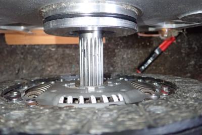

Been thanked: 7 times
Post by Mouse »
Thanks for making the Wiki page. :)
I tried a clutch plate from a Skoda Felicia 1.3 P/N 047141034 as it had the correct No of splines and matching ID / OD spline dimensions. However the spline profile is different so it won't go on the shaft. (Younger me might have hammered it on :lol: )
A stuck Skoda friction plate :cry:
ScottS wrote: Wed Jun 24, 2020 10:09 pm Turns out though, that the Suzuki Jimny clutch does appear to fit! With a very small amount of play, perhaps 1 degree (1mm at outer edge of clutch). Not sure what is an allowable amount of play on a spline shaft, but from what I could see from a sample size of 1 YouTube video, it appears a fairly normal amount.
Do you have a part number for that Suzuki Jimny clutch plate? All the online sellers list it as having 20 splines (motor 18) but it wouldn't be the first time I've mixed and matched things only to discover there were specifications misquoted across all the websites probably all referencing the same xrefrence data.
Also ~1 Deg at the clutch outer edge sounds about right from all the engines and boxes I've bodged together then travelled for 10s of thousands of miles trouble free. Certainly good enough for me to continue a project using something like this.
I had planned on making a resin cast of the shaft (as the motor is too big to easily lug about and risk dropping) and going to the local car breakers yard and matching it up with random things until I got a match. This also might be difficult to arrange under covid restrictions. But if you're found a matching clutch plate that might be the way to go forwards.
