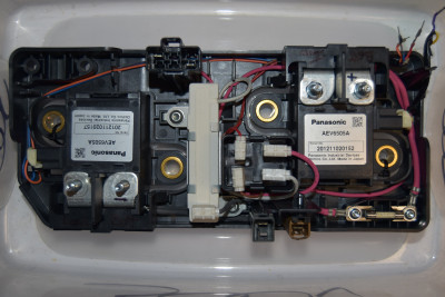

ZooKeeper
Posts: 526
Location: USA
Has thanked: 8 times
Re: Convert a 18 ft boat to electric
Post by ZooKeeper »
Leaf Relays
Leaf Relays
Here is a relay board from a Leaf.
