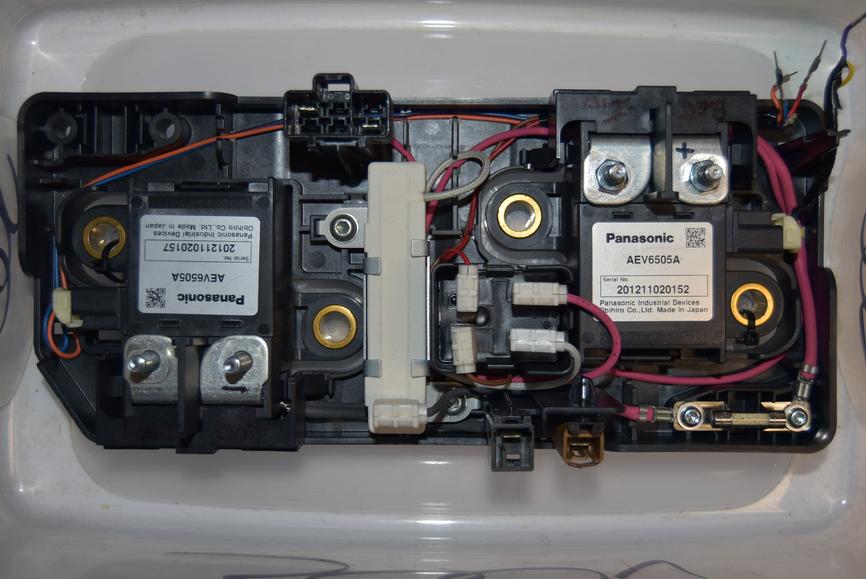

Hi all, I am planning to convert a Bow Rider 18ft ski boat to electric. I will be removing the Mercruiser 3L petrol engine 135 Hp and tank. Bought 2012 Leaf motor, inverter.Just started to get my head around wiring and controls.....but have a few questions, if anyone can help.
1. I am leaving the out drive Alpha One Leg and going to marry up the Leaf motor to the shaft.....will it work? Power of original engine to power of new motor? Not looking for high speed ,but good torque for take off. 24 kwh battery
2.Is the Pre charge resistor 100 watts and 100 ohms?
3. Size of main HV fuse.
Any advice will be welcome,

Another question do I need the second main contactor on the negitive supply and is this the right part no. for the contactor EV200AAANA 1618002-7

Re: Convert a 18 ft boat to electric
Sounds like a cool project!Colm Spain wrote: ↑Fri Dec 04, 2020 8:16 pm Hi all, I am planning to convert a Bow Rider 18ft ski boat to electric. I will be removing the Mercruiser 3L petrol engine 135 Hp and tank. Bought 2012 Leaf motor, inverter.Just started to get my head around wiring and controls.....but have a few questions, if anyone can help.
While I am certainly NOT an authority on the subject, some thoughts on the above and second HV relay question...1. I am leaving the out drive Alpha One Leg and going to marry up the Leaf motor to the shaft.....will it work? Power of original engine to power of new motor? Not looking for high speed ,but good torque for take off. 24 kwh battery
1) You may be able to take the drive plate off the engine and use the hub to verify fitment or make an adapter for the out drive.
2) The one I have, on a Leaf relay board, is 30 ohms
3) Depends on your power and voltage; Prius is like 125A, not sure about the Leaf
4) Most use a relay for both the HV + and HV-, I think doing so is VERY wise.
Leaf 24 kWh pack has a 225A fuse
Here is a relay board from a Leaf.
