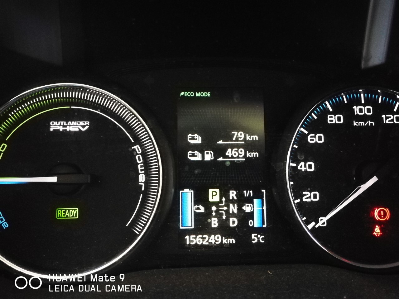

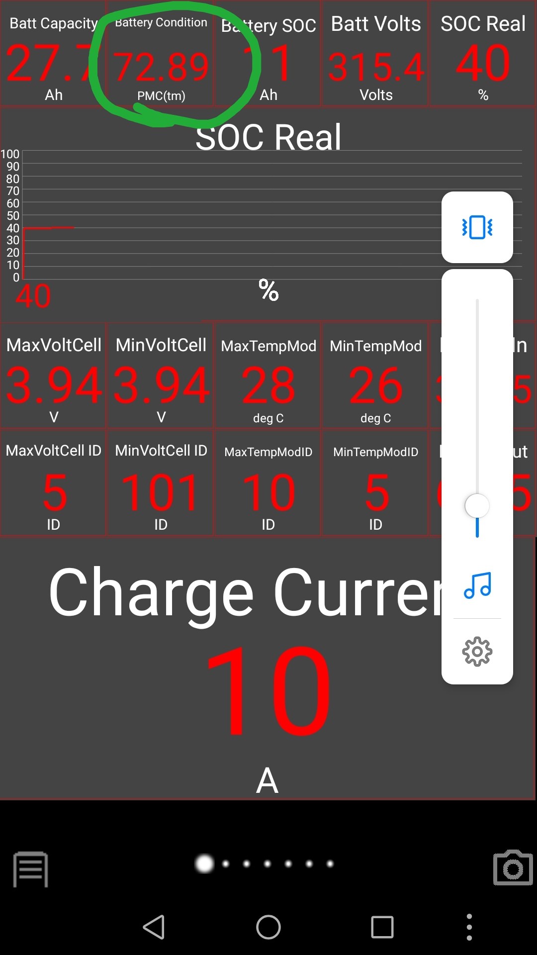

Here is an instant range extender for Mitsubishi Outlander Phev Owners.
Loooking forward who knows this!
Ok so the is a calculated Battery condition value wich will DECREASE with mileage the calculated Capacity of the battery!
For example my Outlander had 150.000 km a value of 72.9 percent PMC!
Now do this:
1.plug to charge the car
2.Switch on ignition.(not ACC)
Now do this:
3.disconnect 12 Volt minus of the Battery!
4.disconnect Charger plug from car.(all went dark)
5.Connect 12 Volt to Battery.(all come on incl. EV Error in display)
6.Switch IGN. off and on! (no error anymore)
7.Check your PMC percent value (99.9)
Now the BMU calculates like a new Battery ,so check the cellvoltages when it comes close to empty!

I tried it on mine and it works well, I have also monitored the lowest cell voltage when it was showing empty and it didn't drop below 3.71 volts on any cell.
