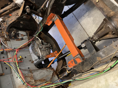

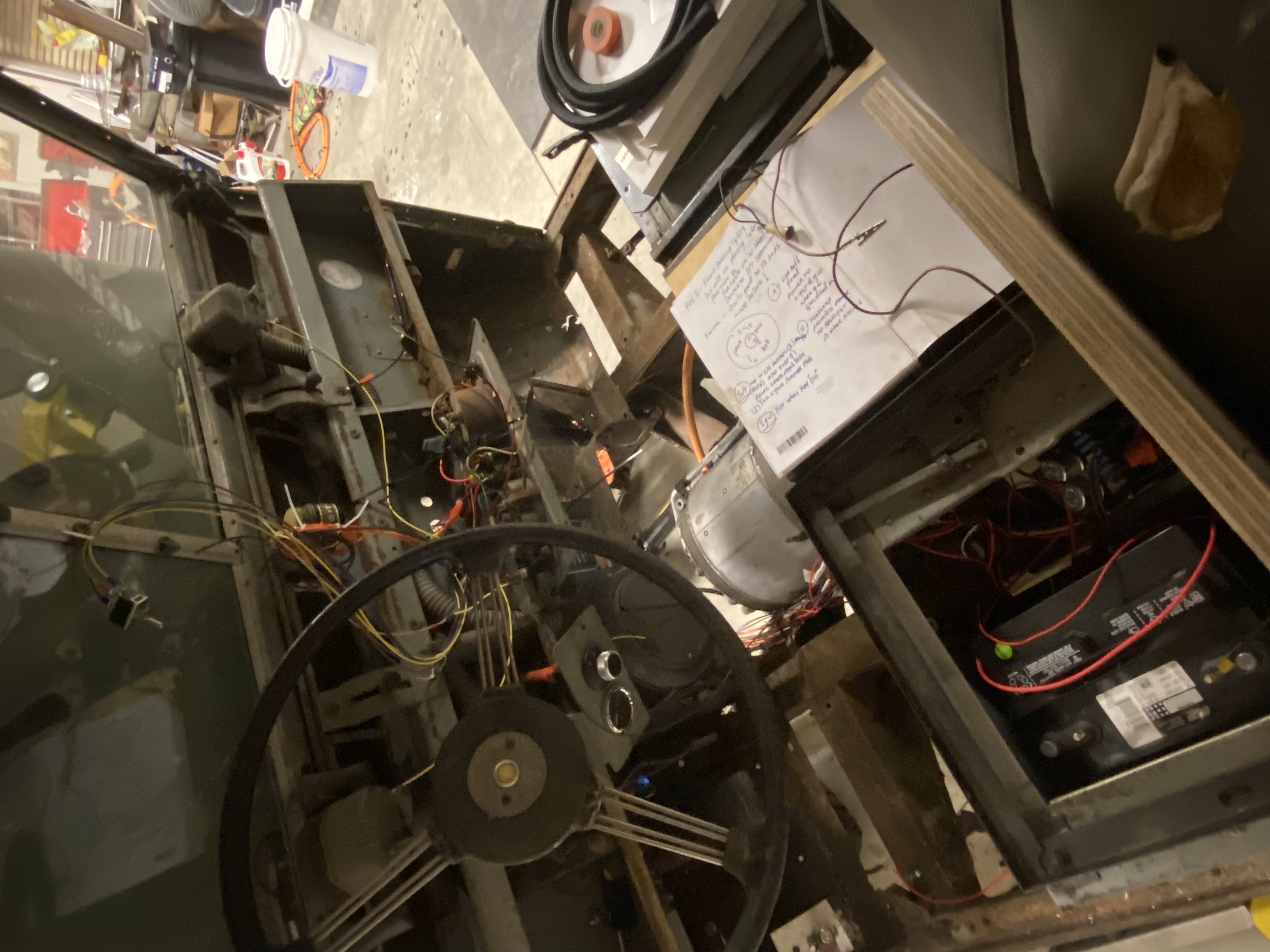

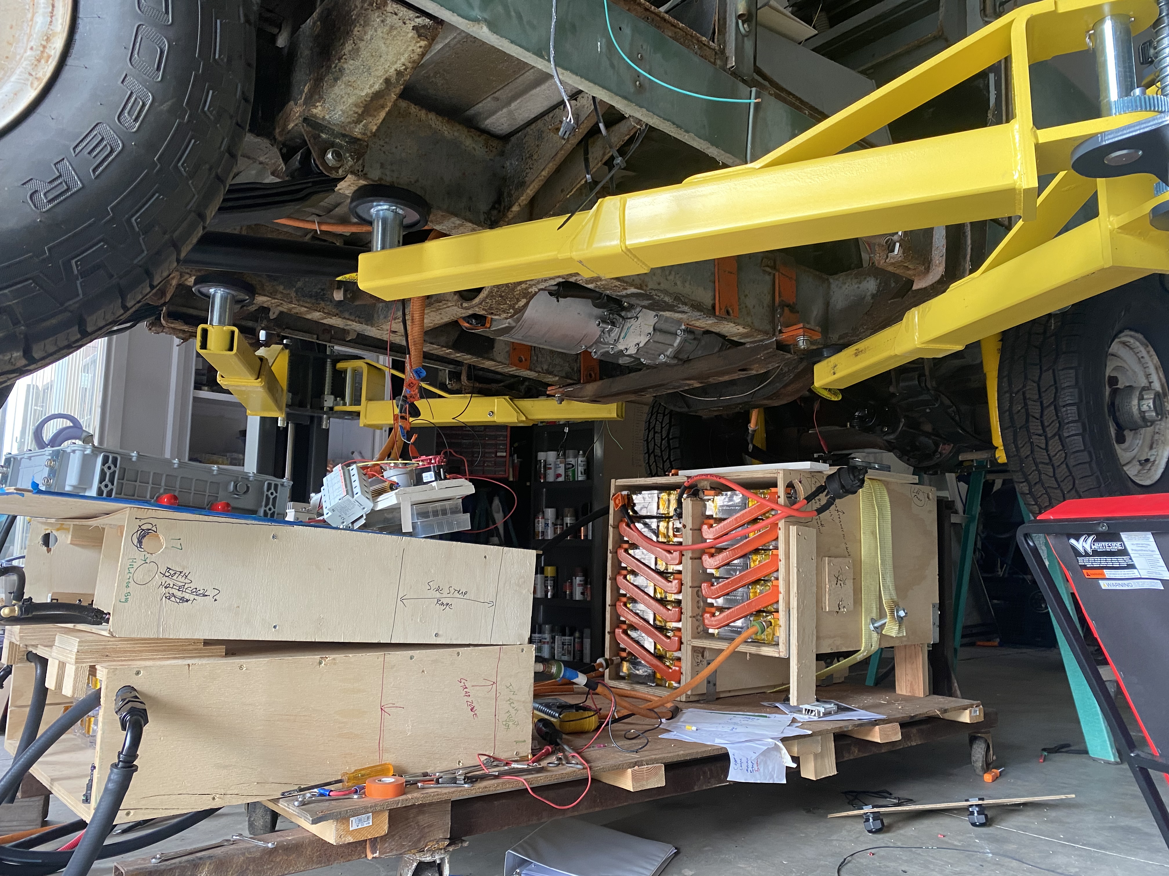

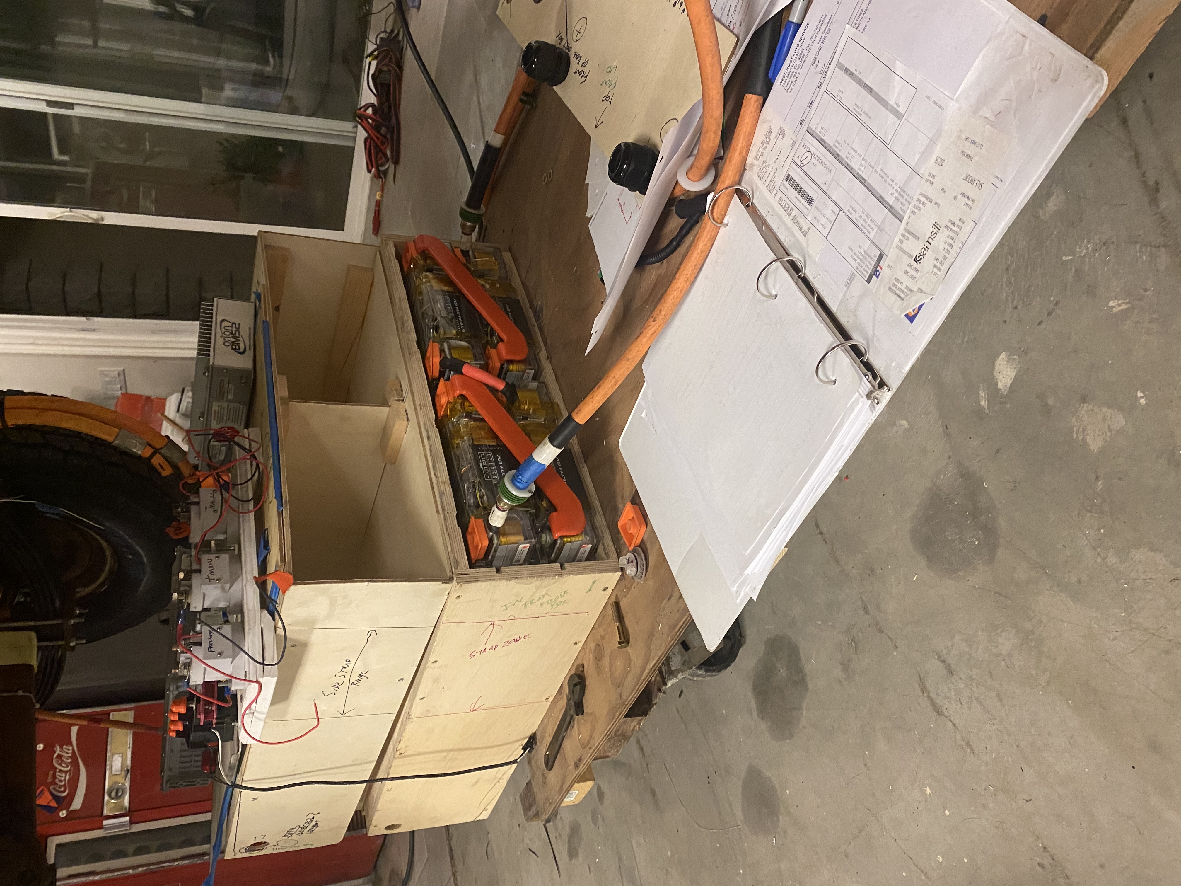

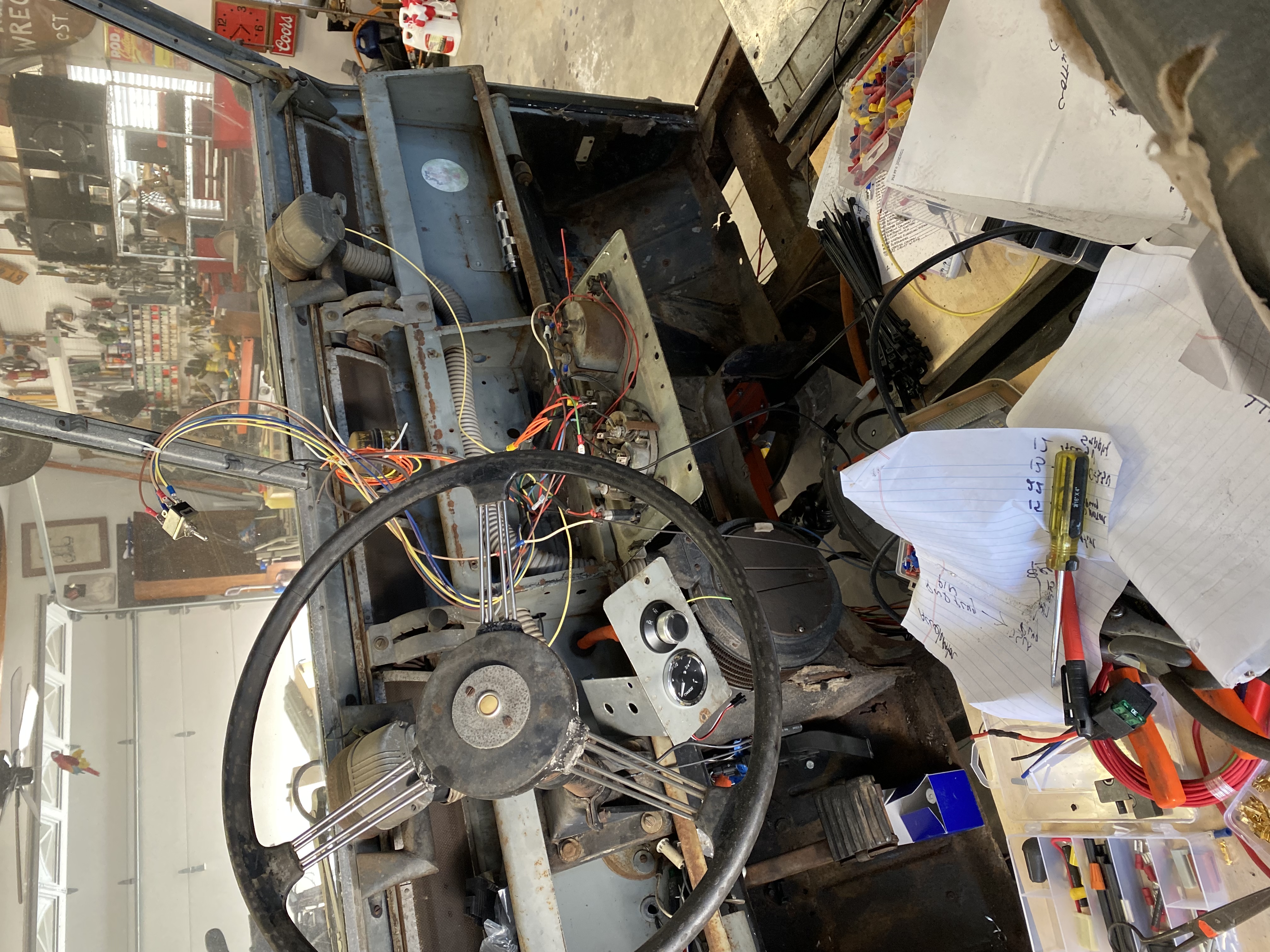

Im getting close. Pictures to follow. Im checking in here today because Im very close to a test fire. Motor has been modified with new gears from Zero EV by way of Amprevolt. Batteries are mounted into plywood battery boxes (version 3.0). Plumbing has been sorted. Low voltage wiring harness has been replaced. I have power to the negative contractor and precharge relay and was stuck on the Positive contractor not activating. After giving it a rest (Nap) I realized I was testing without any high voltage input and this is probably why the contractor won't activate. Back to the shop. Hopefully I can post a wheels spinning video soon.

Whelp, I hooked up 4 Tesla Modules for 95V, accessed the wi fi portal, made the changes to udcsw and udcmin and changed max voltage to 95. Turned the key switch and heard the click of the negative contractor and then the precharge relay.... then hit the "start" switch and ......
nuthin......
bummer....
not sure where to go from here... guess ill sleep on it again....
just saw the post at the top of the page that + rv is a typo for +12 volts..... lol. maybe someone can edit that diagram for future generations
More pics too! Notice the custom driveshaft 8-)

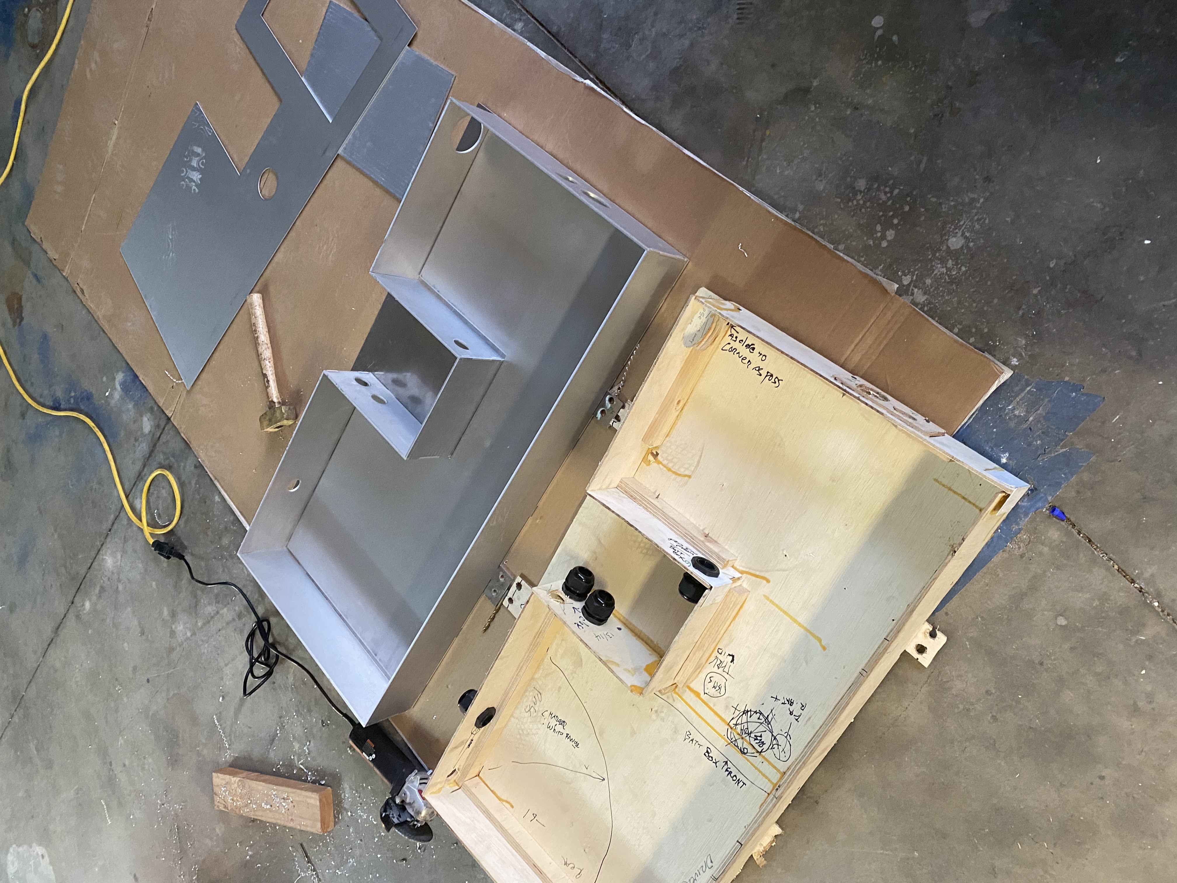

On a brighter note I got my parts from Send Cut Send for my control box .. looks pretty darn good.
