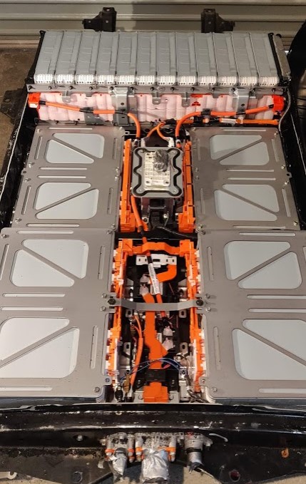

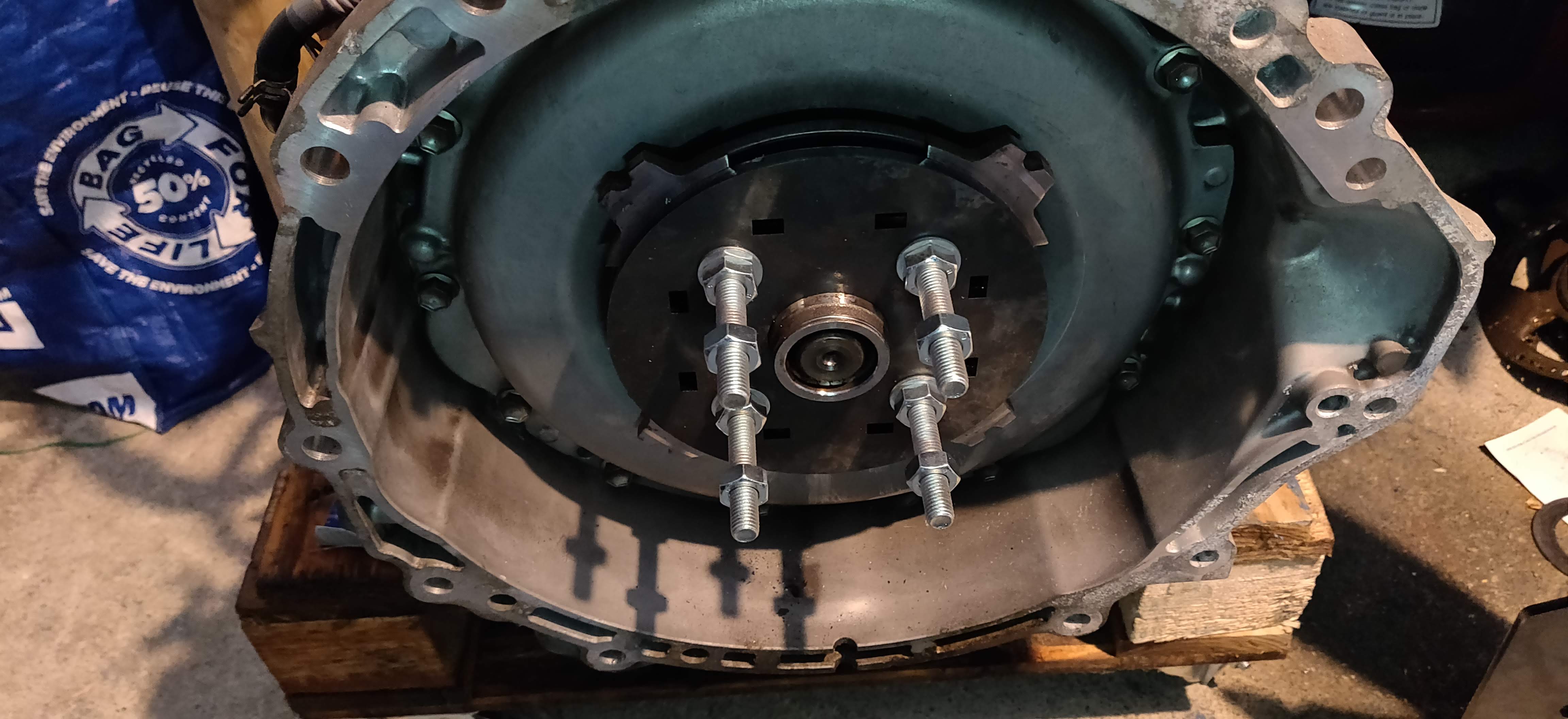

Hello,
I’d like to introduce my project. I’ve been watching Damian’s video’s for years now and decided it was time to have a go at a conversion. After attending the New Electric course in august I had the knowledge I needed to make a start. I bought the car with engine damage for €1,500 and since then I’ve been planning the build.
Spec
BMW E60 520d
Lexus GS450H gearbox and inverter
2019 40kWh Nissan Leaf battery
HV JB from the leaf
Opel/TRW electric power steering pump
The 12 module rack from the leaf fits nicely within the boot. The seats don’t fold so nothing lost there. Should only loose 400mm depth from the boot. Need to decide is this needs to be in a box or to just fit some sort of plate to protect the batteries and cover over with boot lining material.
Work completed
Leaf battery disassembled.
Re-used leaf HV junction box / contactors. Bench tested with VCU and ISA shunt
Lexus GS450H gearbox bench tested and spinning with EVBMW VCU running V7 Software.

Fit locking plate to gearbox
Test gearbox oil pump and replace pump bearings

Some progress with the locking plate over the weekend. I got parts laser cut to reduce any welding. This will allow me to get everything in place and to test fitment before welding. The bracket that will sit on the sub-frame is also adjustable as I've yet to pull the engine. I got one of the inverter brackets wrong and I will need to redo it but everything else slotted together nicely.
I will share the CAD drawings if anyone wants them.
