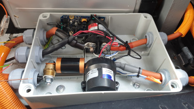

2017 LIM wired into the Grey Goose and tested working on AC. Next up integrating it into the VCU and canbus then DC experiments begin:)
