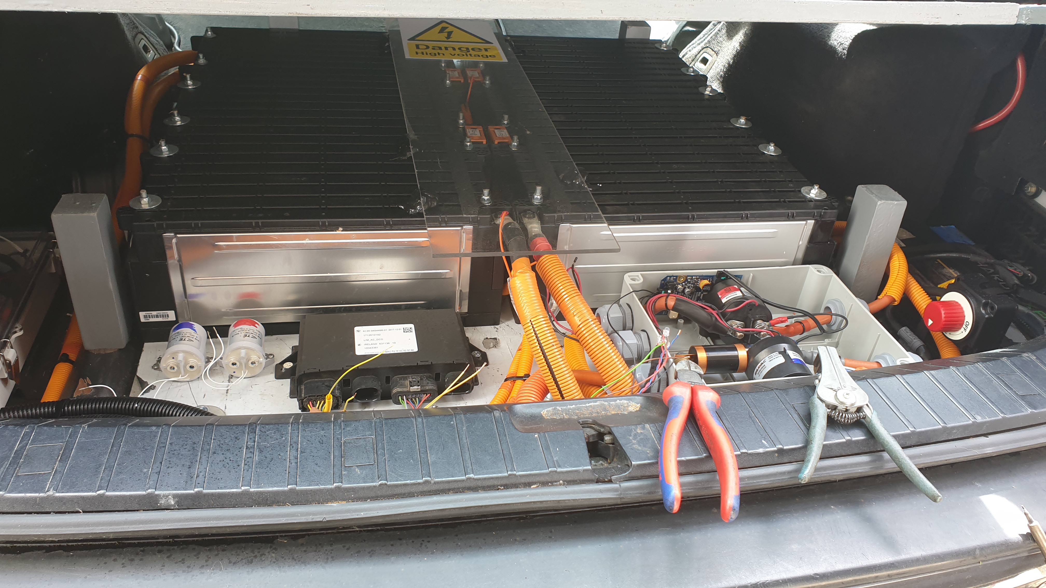

2017 LIM wired into the Grey Goose and tested working on AC. Next up integrating it into the VCU and canbus then DC experiments begin:)
Question : Can someone please tell me with LIM stands for?

Jack Bauer wrote: Sat May 29, 2021 5:38 pm Question : Can someone please tell me with LIM stands for?
ladegerät interface module perhaps?

By the way, the German BMW dealers call it "LIM Lade-Interface-Modul Steuergerät" => Charge interface module controller
