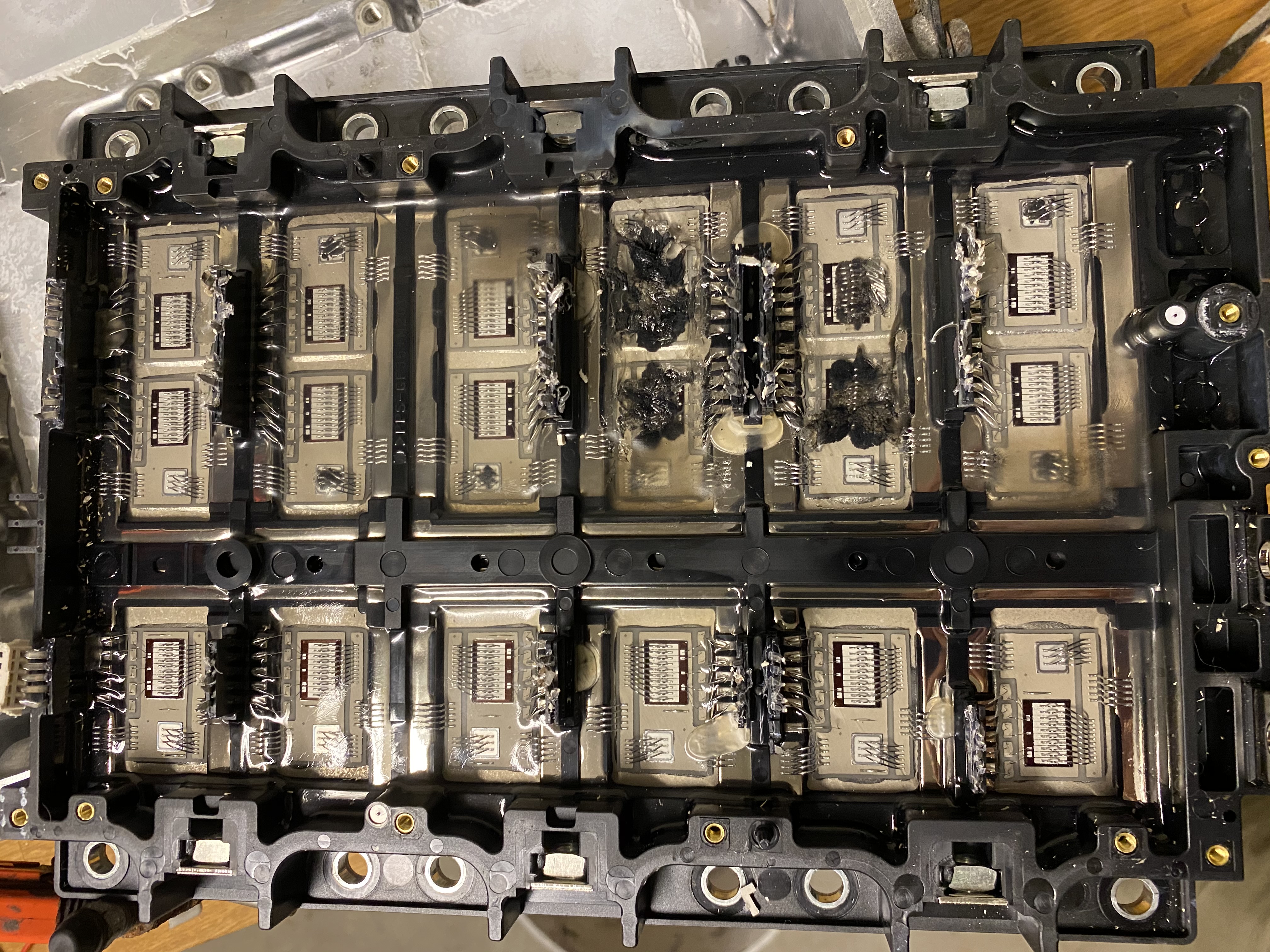

first one popped when revving the motor in my garage second one blew about 5 blocks down the road....
Yep, scoped the Damien card and its putting out 8.9khz.... hmmmmmm.....

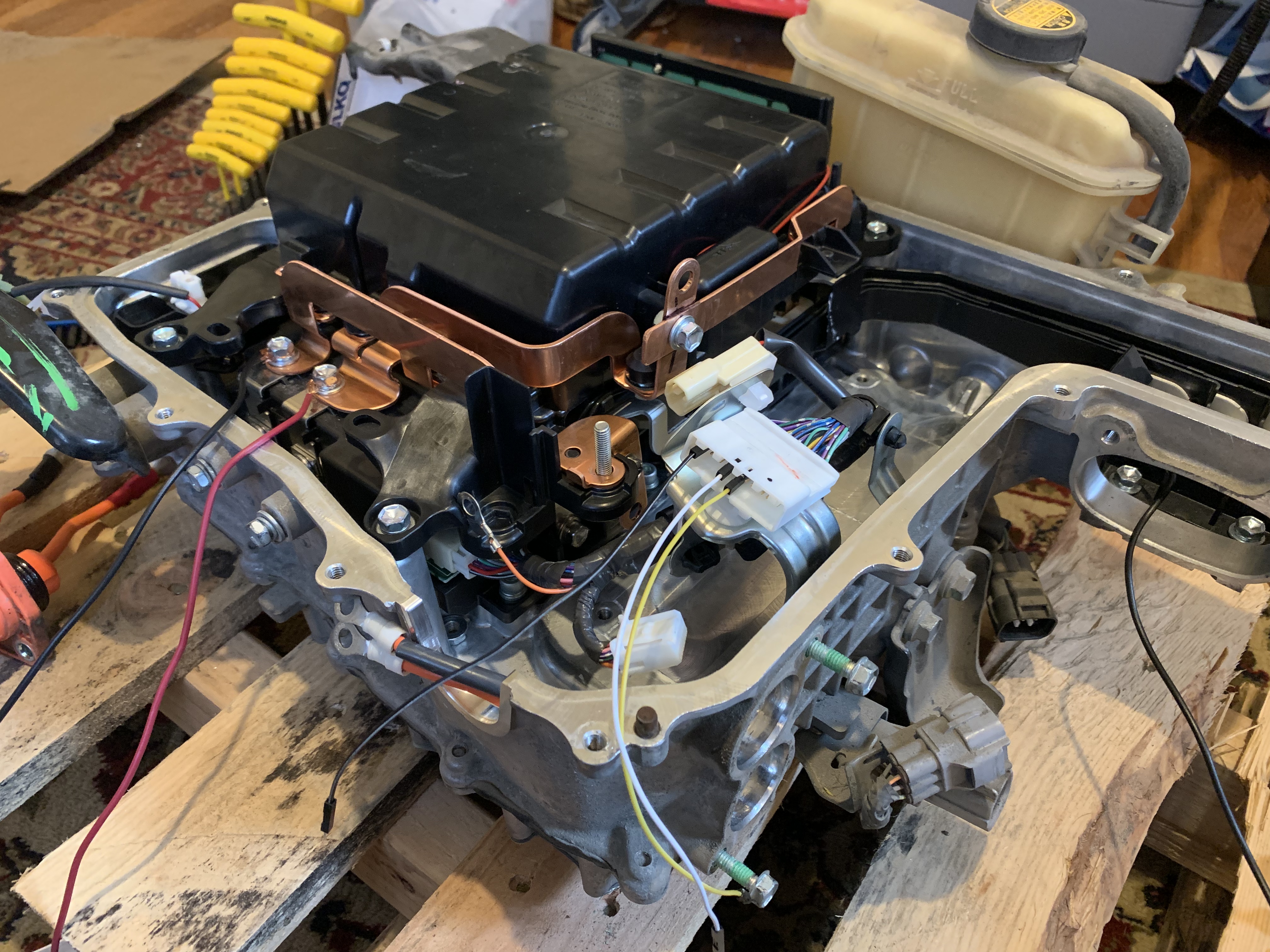

Awesome! lets see some pics of the inverter configuration! I think taking out the boost block and inductor is required for this to work as i popped a leg of mg1 trying to spin the motor at 4.4 khz.... I still have one more 100% intact inverter....
Ev8
Posts: 835
Has thanked: 44 times
Been thanked: 172 times
Re: Prius Gen2 Inverter DC Motor Controller
Post by Ev8 »
Will take some better pictures next time to lid is off, but yes no chance of keeping the boost inductor in there I’m afraid, basically the setup it all mg1 phases and mg2 phases and bolted to their own 4.5 x19 mm bush bars which are joined together by another bus bar which runs to the motor positive. As in my earlier photos but minis that stupid big diode idea,
Motor negative another bus bar that loops around the case to battery negative and picks up on the capacitor negative,
Battery positive a short bit of bus bar picking up on capacitor positive straight to inverter positive,
All capacitors linked to work together rather then being separated so some linked to boost converter and some linked to inverter

I just picked up an inverter to test it out as a DC motor controller. I'm currently building out the mechanical side of things (11" GE series wound motor), but am currently getting set up for bench tests.
I'm still getting up to speed on these inverters, but I do have an oscilloscope and a small amount of electronics background. I'd be happy to help test out the differences between the 8kHZ and 4.4kHz PWM signals, as well as try to figure out what's causing them to let out the smoke.
@Ev8, I would love it if you could describe the modifications you've done in a bit more detail, to make sure I'm testing the same thing. My understanding so far is:

And as a super quick update, after an afternoon of playing with it, I've been able to control power to a small lamp. I still need to join the 6 phases into 1 bus bar, but it's certainly looking promising.
I'm hoping to get the bus bars fabricated tomorrow and then will start working on an actual controller that I can use. Once that's done, I can start inspecting some of the waveforms.

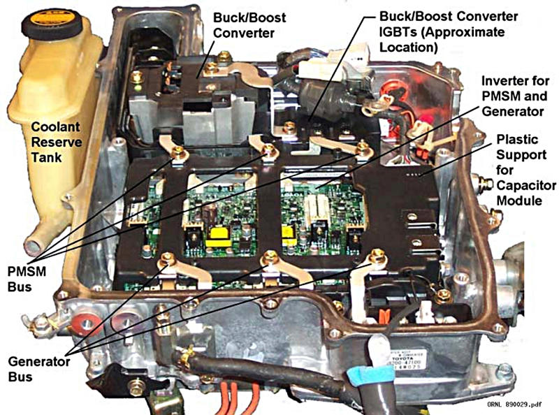

carsondarling wrote: Fri Jul 23, 2021 7:34 pm
  • Remove boost controller
  • Remove boost reactor
I don't know what these two parts are or look like.
Are they bolted in and can be unbolted and removed?
Can they be seen in your picture of the prius controller?

So boost components must be removed, the capacitor bus bars must be modified so all capacitors connect to the same dc bus at the main inverter brick
Posts: 1083
Has thanked: 479 times
Been thanked: 311 times
Post by MattsAwesomeStuff »
Ev8 wrote: Sun Aug 29, 2021 4:54 pmSo boost components must be removed, the capacitor bus bars must be modified so all capacitors connect to the same dc bus at the main inverter brick
Added that image to the general Prius Gen 2 wiki... which is kind of a sloppy mess right now, with all the different specific instructions for boards no longer being made, etc.
