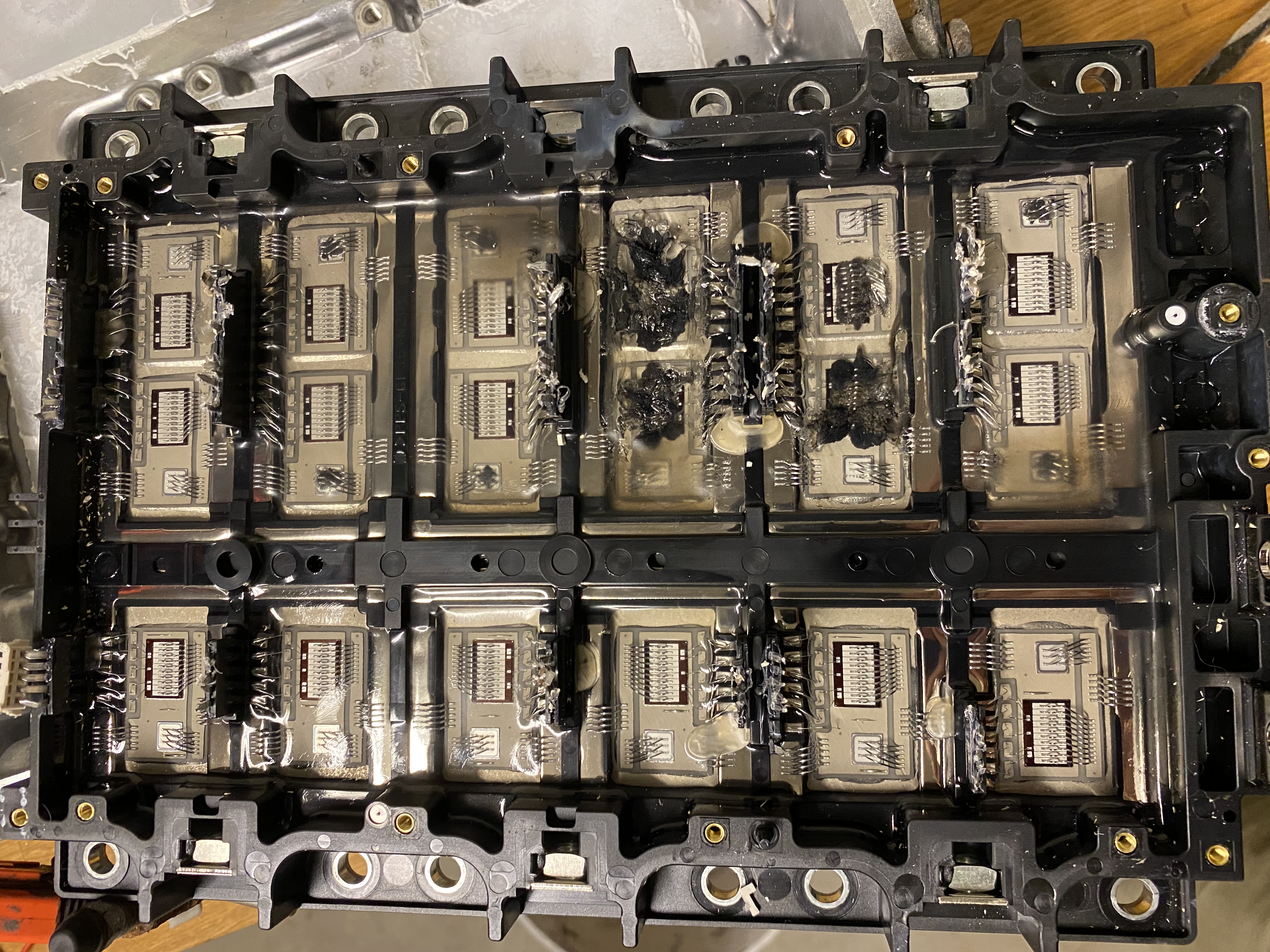

first one popped when revving the motor in my garage second one blew about 5 blocks down the road....
Yep, scoped the Damien card and its putting out 8.9khz.... hmmmmmm.....

60 miles of testing and tweeking complete, no sign of issues with the inverter. 4.4khz switching is a little bit like squeaky brakes though! One day I will try raising the frequency and see how things go

Awesome! lets see some pics of the inverter configuration! I think taking out the boost block and inductor is required for this to work as i popped a leg of mg1 trying to spin the motor at 4.4 khz.... I still have one more 100% intact inverter....
Re: Prius Gen2 Inverter DC Motor Controller
Will take some better pictures next time to lid is off, but yes no chance of keeping the boost inductor in there I’m afraid, basically the setup it all mg1 phases and mg2 phases and bolted to their own 4.5 x19 mm bush bars which are joined together by another bus bar which runs to the motor positive. As in my earlier photos but minis that stupid big diode idea,
Motor negative another bus bar that loops around the case to battery negative and picks up on the capacitor negative,
Battery positive a short bit of bus bar picking up on capacitor positive straight to inverter positive,
All capacitors linked to work together rather then being separated so some linked to boost converter and some linked to inverter
