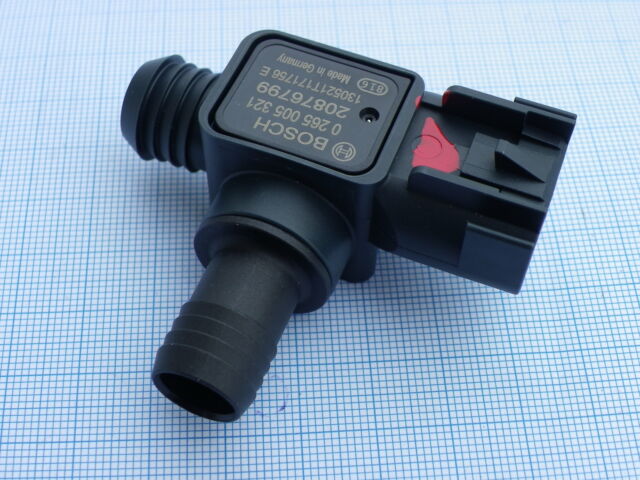

arber333 wrote: Fri Aug 13, 2021 7:45 pm
Cookie6000 wrote: Fri Aug 13, 2021 7:28 pm Since I got the VAG sensor working, the GM one went down the priority list. Once I have the cluttered bench cleared of multiple mini tasks, I'll get back to it. I am pretty sure it was something simple I was missing
I jusr ordered one GM sensor. Will publish what i find out.
I tested the unexplored Bosch (GM) 0265 005 321 vac sensor. It has integrated check valve so you just install input hose on one side and output hose on the other.
It seems it is a 5V unit. I got it with connector and a pigtail. So i supply 5V to yellow/orange (pin 3) and black/yellow (pin 2) wires and i got response on the yellow/violet (pin 1) wire. When at outside pressure you get 600mV but if you supply underpressure you get analog voltage response. My testing was limited to a hose and UP28 pump but i still got over 3V result. Hope it helps.
But I decided I will stick to my Volvo switch P/N 30645383 since it is really simple to use.
It is digital on off and it also has a check valve. Did i mention i can find it really cheap too...

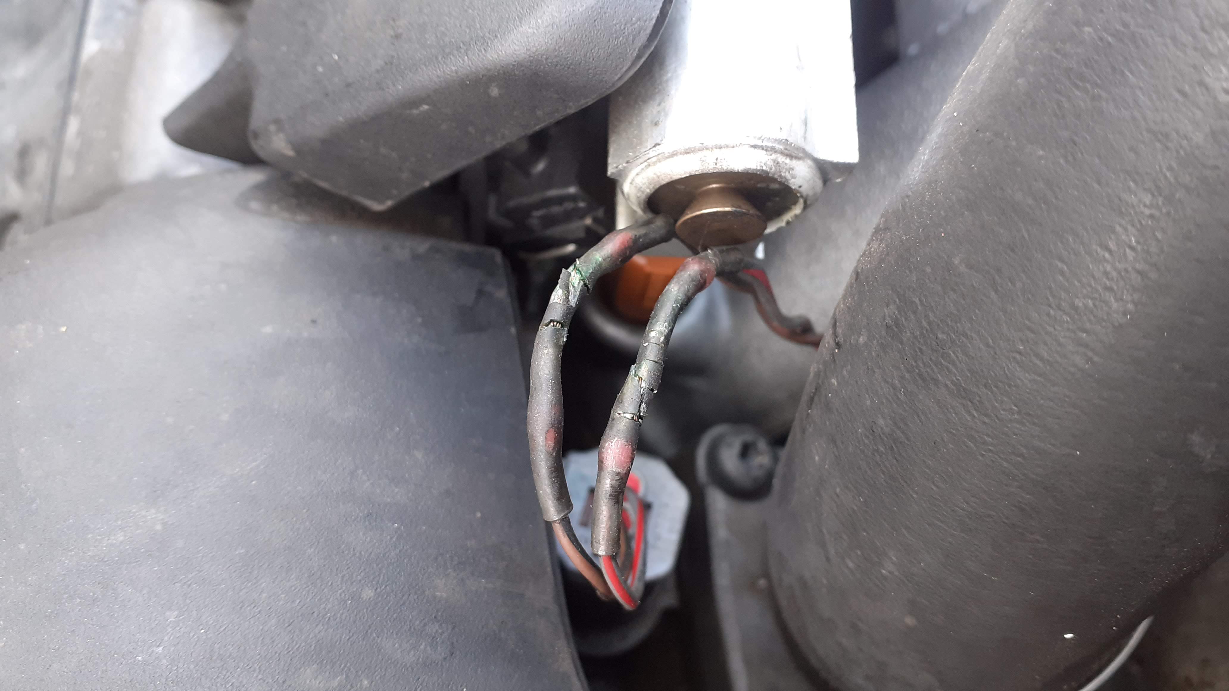

I can't recommend using those. This is what they looked like on my friend's Volvo V70 after just two years. It was used to connect a new pig tail for the temperature sensor.
It is not in a very hot place and still the tubing became brittle. The flux inside started to corrode the wires and the soldering connection was very poor, but that was not visible from the outside.
I had to cut the wire, clean the residue of the shrink tubing, solder and shrink tube it again. In the end it cost more time than it saved.
Maybe they're better when you can get them in decent quality, but I don't think you get that from Aliexpress.
Posts: 3580
Has thanked: 134 times
Been thanked: 342 times
crasbe wrote: Sat Jan 08, 2022 6:37 pm I can't recommend using those. This is what they looked like on my friend's Volvo V70 after just two years. It was used to connect a new pig tail for the temperature sensor.
Hm... that would be bad. I can only say i use them for 2 years now and i allways put them into a heatshrink sleeve or those white electrical tubes.
Havent had a problem up to date. Not saying there wouldnt be...

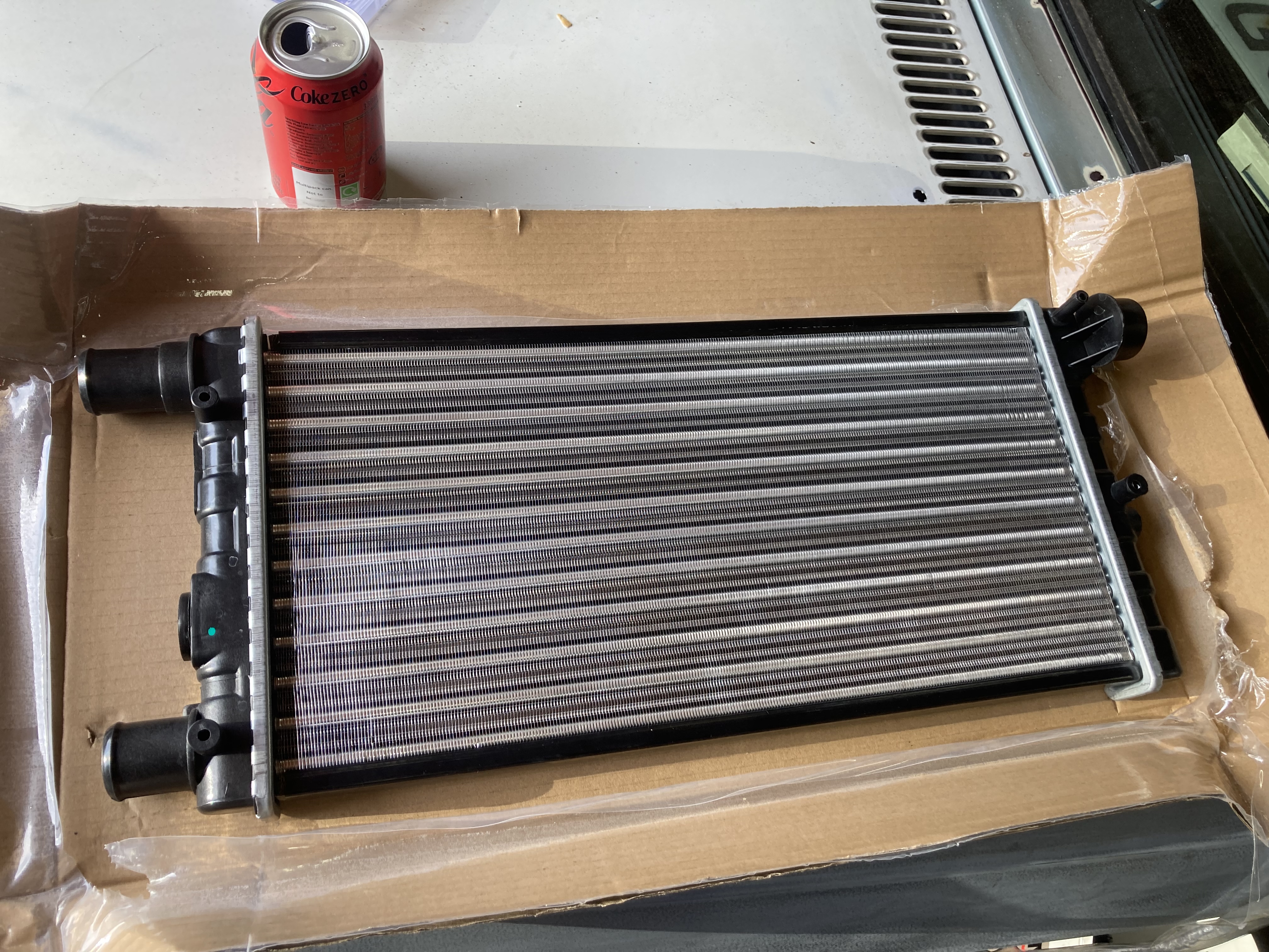

Not technically an ev part but I’ve discovered a useful size radiator for a conversion that can be bought new for as little as £35 (40euro)
Comes from a fiat cinquecento
Posts: 3580
Ev8 wrote: Thu Jun 16, 2022 6:53 pm Not technically an ev part but I’ve discovered a useful size radiator for a conversion that can be bought new for as little as £35 (40euro)
Yes i use the same fiat 500 radiator from 1988 in my peugeot to cool motor, inverter and chargers. 😎
Edit: mine has also integral coolant tank which i use to deair the system.
ohh this looks perfect, what year?
Ev8
Posts: 818
Has thanked: 43 times
Been thanked: 163 times
Post by Ev8 »
Was listed as
FIAT CINQUECENTO, SEICENTO, 600, KIT CAR 0.9 1.1 MANUAL RADIATOR 1991 TO 2010

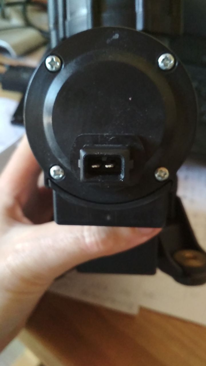

I have a MES-DEA 70/6E2, never use it.
Only have a paper from maker, connector it is just a 12v pin but i dont find the pinout.
somebody know which is the positive and negative here ?
