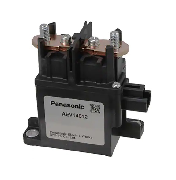

I know I am late to the party and this has been discovered already, I am just sharing, the contactors are identical Panasonic AEV14012 M25 specs claim them to be only 120A ?

FYI I've blown through a bunch of the resistors in these packs (through idiocy) to the point where I couldn't find any more. It's fairly easy to re-route the wiring outside to a different size/shape, with all the usual safety caveats.
- Posts: 3796
- Has thanked: 166 times
- Been thanked: 413 times
For use in place of resistor i would recommend NTC inrush limiters with a propper voltage rating.bobby_come_lately wrote: ↑Mon Jan 31, 2022 7:33 am FYI I've blown through a bunch of the resistors in these packs (through idiocy) to the point where I couldn't find any more. It's fairly easy to re-route the wiring outside to a different size/shape, with all the usual safety caveats.
https://eu.mouser.com/ProductDetail/Ame ... wDPQ%3D%3D
Out of interest, how have you been blowing the resistors? Pulling drive current without the main positive contactor pulled in?

Close - powering up DC-DC before it closed. Long story. Fixed it months ago now but cost me three resistors before I did.

I think someone (@Outlandishpanda maybe?) did get the contactors to close over canbus but I went with re-wiring it as it felt safer. I know there's a lot of scepticism about the OEM relay/contactors but I've been using mine without issue since September now.

I tried, but no, I couldn't get the S-BOX to close the contactors over CAN. I hard wired them to my BMS like bobby_come_lately.
I do use the current (ID 0x200), pack voltage (ID 0x210) and DC Bus voltage (ID 0x220) data from the S-BOX, which is fantastic quality and integrates well with SimpBMS. Except, the CSCs pop out an ID0x200 message occasionally which has to be actively ignored as I have the CSCs and S-BOX on the same CAN bus inside the pack.
