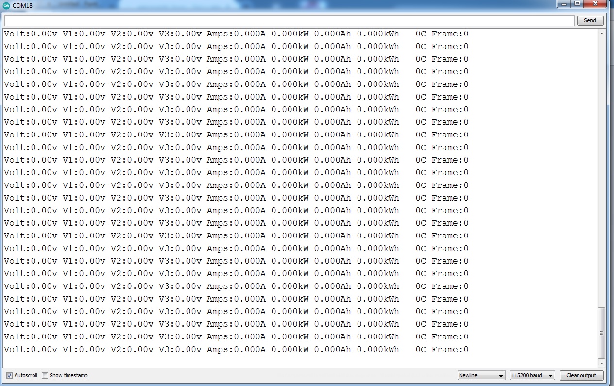

- CCSknowitall
- Posts: 109
- Been thanked: 30 times
Haven't been on in a while. I'm not as much as a know-it-all for CHAdeMO but will try to help.
Hope this helps. Try some other station manufacturers too, just in case!
In the above log there's no communications from the station, seems you have fixed your CAN termination issues since then.P.S.Mangelsdorf wrote: ↑Sat Jan 29, 2022 11:44 pm Second is a log on the command/station communication bus.
chademo bus attempt failed.csv
You're not requesting any current once the station has gone through cable check and precharge. You need to request current in order to have things start moving, and you need to do so within 6 seconds of contactors closing. Note that this station is saying it's delivering 5A in this log, I can almost guarantee that it is not in fact delivering current.P.S.Mangelsdorf wrote: ↑Sun Jan 30, 2022 8:24 pm I found part of my problem, but still no sucess charging.
I realized that the shunt and station communications are the same bus, so I had an extra termination resistor. I pulled that out, but still had issues.
I also double checked the soldering on the relays, and made sure they were connected.
This attempt was at an Electrify America station. I got all the way through the process right up to delivering power, and then it failed.
I got a CAN log and a screen capture, but for some reason its not letting me add the screen capture.
The web interface is still showing 0% SOC, which I think is the error. I did have the shunt installed backwards for a while. Could I have damaged the shunt, where it is still communicating but not measuring properly?

I went on and checked ISA output on serial monitor. It doesnt seem to output anything. I tried to innitialize it and hook it up to 14V for voltage measurement and 3A light bulb load for current. It doesnt seem to show anything. And i have two ISA sensors here that behave the same!!!Isaac96 wrote: ↑Tue May 03, 2022 3:03 pm Hmm. Going through isolation and getting contactors on means CAN is working up to that point.
Error 32 is just "EVSE_STATUS_STOPPED" -- nothing really helpful there, but it means the car didn't throw the error, the station did.
Hmm. When D2 turns on (goes to ground) it should pull IN2 low. Maybe that polarity is reversed? I had issues when creating the code with all sorts of different hardware (I used some years ago, then used Leaf VCU, then 'official' chademo controller. Lots of different configurations.)
Do you know an option to check if ithe sensors work?
All i get are 0s.
