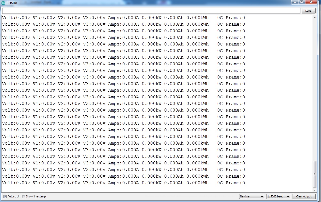

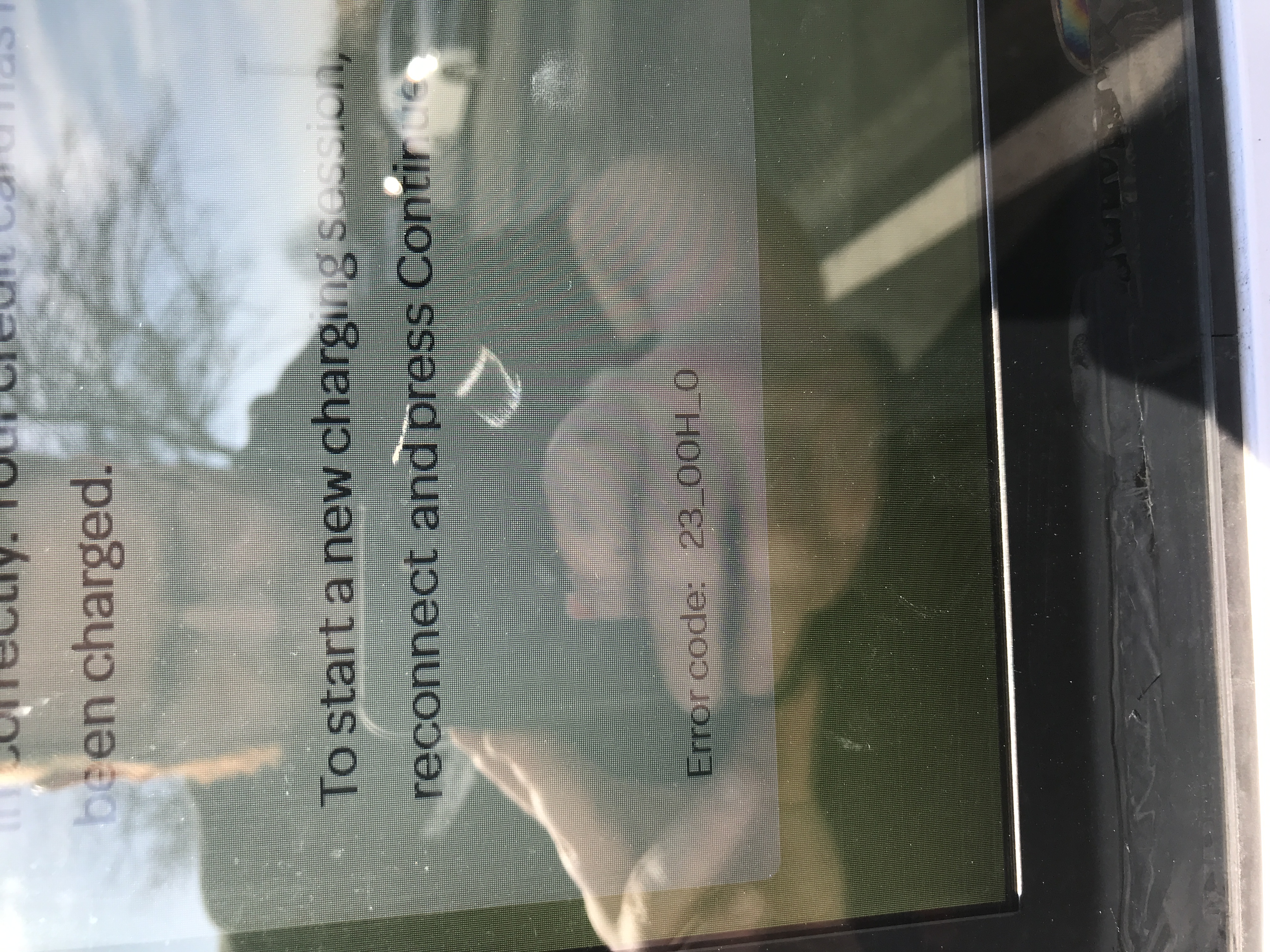

Ok so I tested several configurations and can't seem to find the issue, though I did have some interesting settings issues.
First, in all cases the error message from the Electrify America charger was 23_00H_0 This occurred after the station appeared to begin delivering power. Watching on the web interface, it appears the station does all of its checks (station side voltage rises, drops to zero, the rises back to the car's voltage), and I hear the contactors close in the car and the station, but then it throws the "Malfunction|Stop" error message in the web interface and the station says charging failed.
Second, I played around with the signs of various items from the shunt, and observed an interesting result.
- Regardless of the signs of Volts and Amps, the sign of kW stayed the same.
- Changing the setting for kW did not change the sign either.
- No matter what settings I use, I get negative kW when power is leaving the pack, and positive when it is entering (tested by running the motor with the car on jack stands). This seems like it should be what the controller wants, but I'm not sure at this point.
I can't seem to figure out what combination of signs the controller wants. Can anyone else that has this functioning tell me what they are seeing sign-wise in the web interface so I can attempt to match?

hmm is this again a case of the “wrong” orientation ? Might be worth flipping it just too see.P.S.Mangelsdorf wrote: ↑Sat Feb 12, 2022 2:24 pm
you’ve verified that the shunt is working properly, outside of the vcu? which it seems like so it’s just the vcu running itself?

I've flipped it around so at least in terms of current flow it is in the "right" orientation, just off of the + side of the pack instead of the -.
What's odd to me is that the power sign won't change even when I tell it to. The shunt is more than happy to swap the sign of the voltage and amperage reading when I tell it to, but power won't change.
Based on everything I can easily test, the shunt is working correctly. Voltage matches what I see from a multimeter, and amperage seems correct when running my level 1 charger.

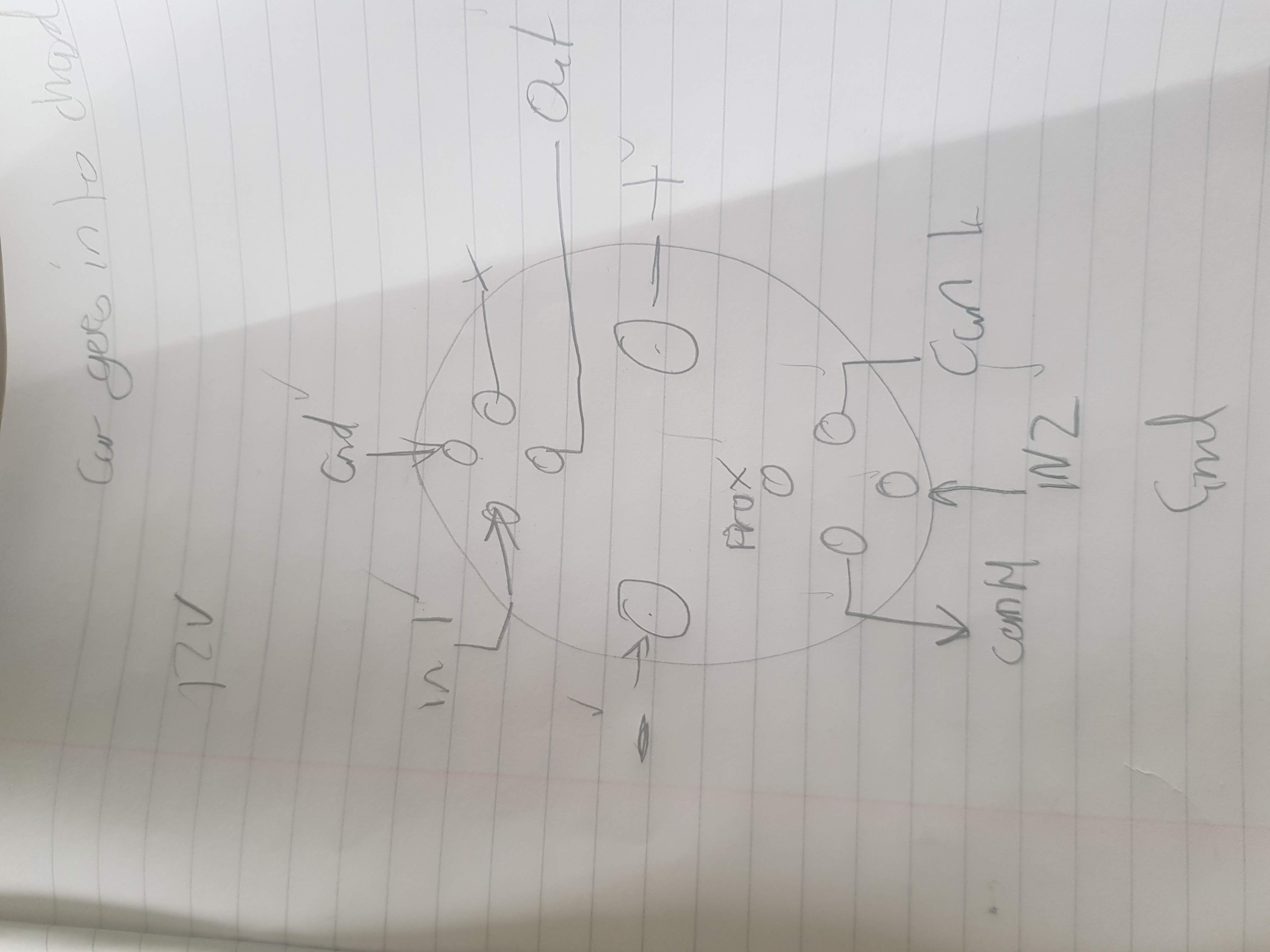

See attached sketch of my HV wiring.
To the best of my knowledge, there are no instructions for the STM32 version. I was hoping to put them together once I got this working.

Okay, wiring looking good. Shunt on the HV side should not cause any issues but it's always possible, that might be a last thing to change.P.S.Mangelsdorf wrote: ↑Mon Feb 14, 2022 3:34 pm

I went on and checked ISA output on serial monitor. It doesnt seem to output anything. I tried to innitialize it and hook it up to 14V for voltage measurement and 3A light bulb load for current. It doesnt seem to show anything. And i have two ISA sensors here that behave the same!!!Isaac96 wrote: ↑Tue May 03, 2022 3:03 pm Hmm. Going through isolation and getting contactors on means CAN is working up to that point.

Do you know an option to check if ithe sensors work?
All i get are 0s.

Well that is strange... i get plenty of raw CAN data on Canalyst and when i apply 12V battery or lamp load CAN data changes. Sensor works, its just that my VCU doesnt receive data...
- Posts: 656
Which CAN bus are you on? And which firmware version is this? I think I had ISA on one bus and the EVSE on the other bus just to avoid any issue with bus load (also so you can have ISA talking to the rest of the car).

I too am struggling to get chademo working, but notice my HV are opposite to yours.
Chademo doesn't seem to start sending 0x108 and 0x109 when I try it, my side is sending 0x100, 0x101 and 0x102. Station errors out communicating with the car.
So back home, if I apply 12v to start 1, my side starts sending out the can messages, if I replay the EVSE side I found online, and pull start 2 to ground my contactors close, it never gets this far at the station.
This is how my socket is wired looking at it. I've checked and double checked the wiring.
