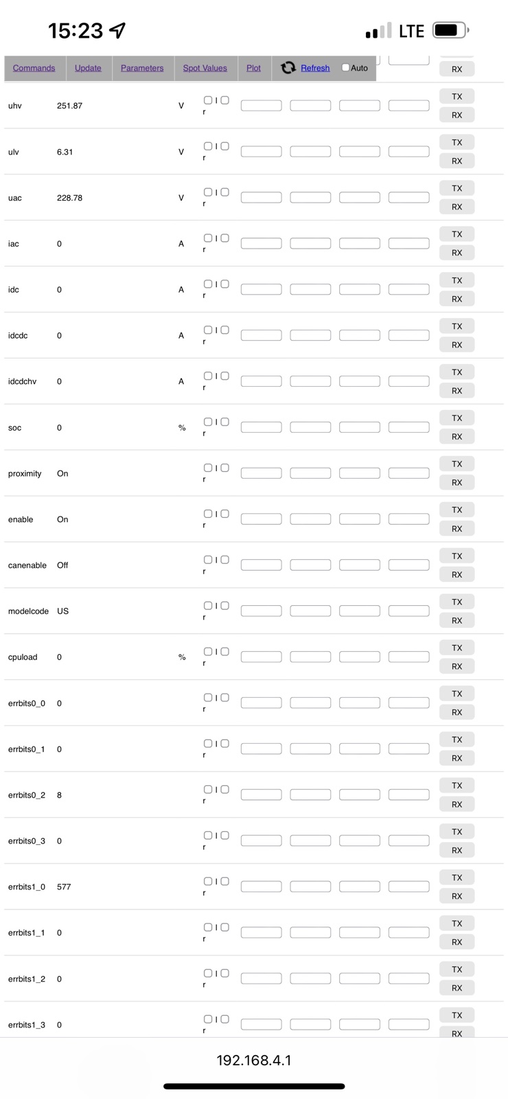

Hello !
I use stm32 version v2 board with commercial firmaware (demo version for 5 minutes) made by JLCPCB (US version PCS) and have some error bits.
errbits0_2 8 (PCS_a032 unused I think)
errbits1_0 577 (can't explain this errors)
Can you explain this errors for me ?
