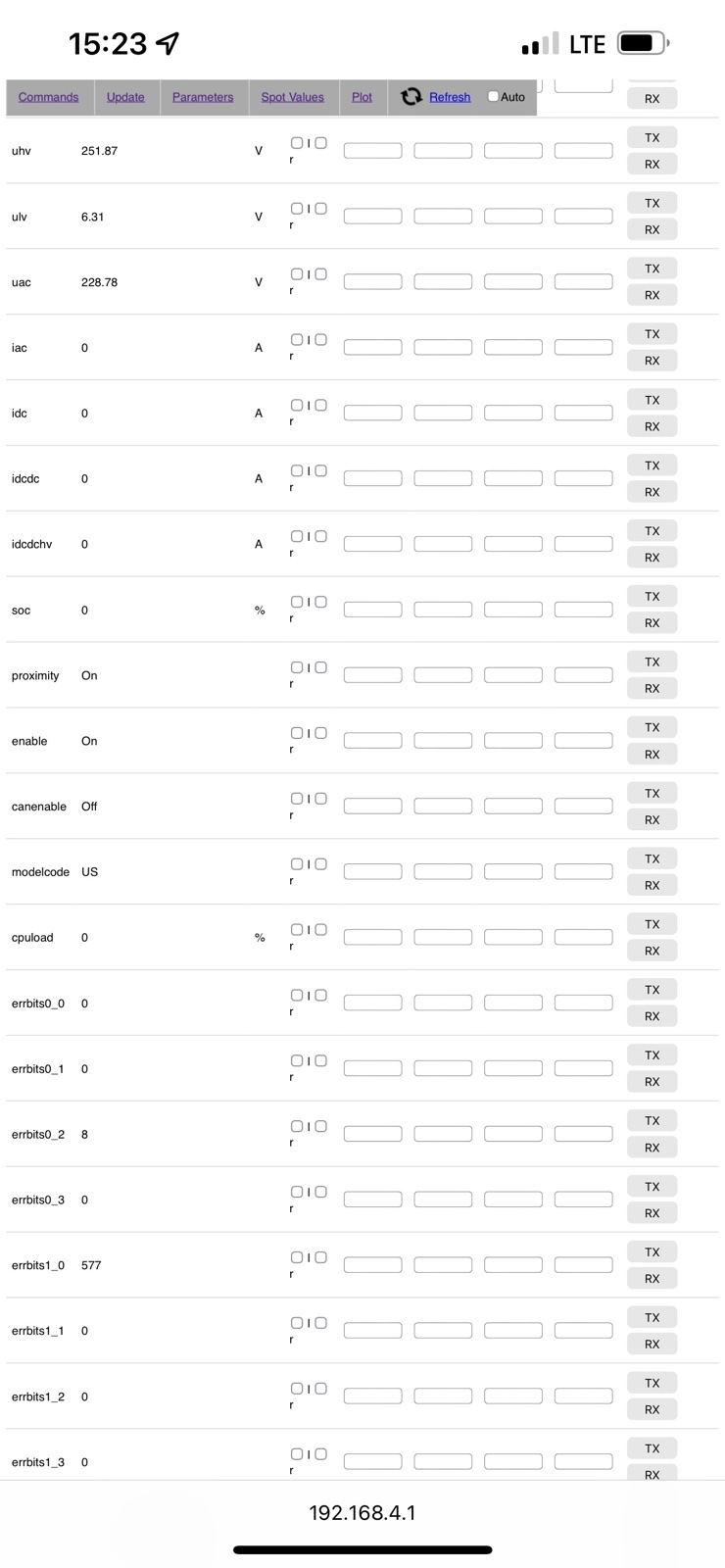

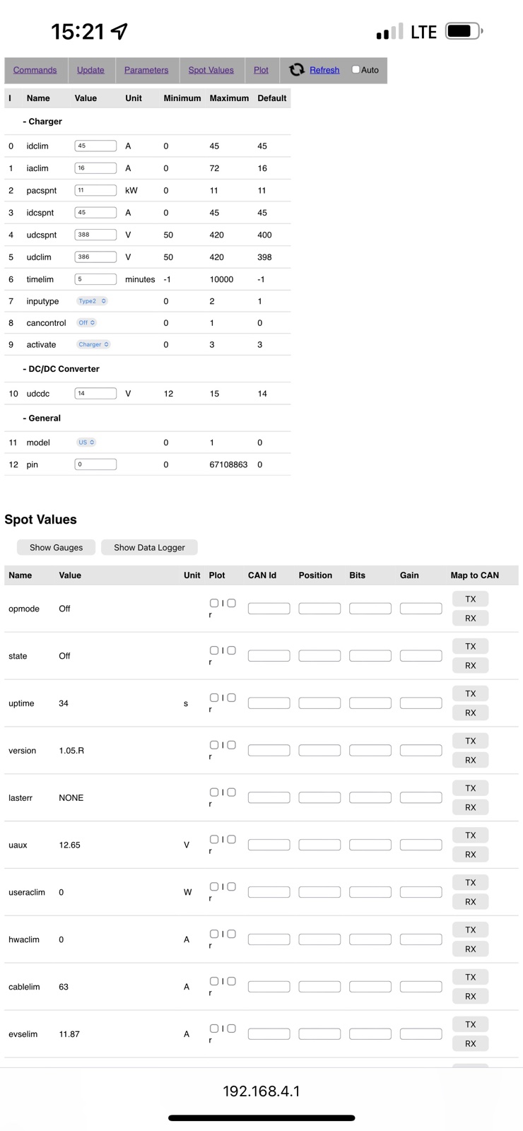

Hello !
I use stm32 version v2 board with commercial firmaware (demo version for 5 minutes) made by JLCPCB (US version PCS) and have some error bits.
errbits0_2 8 (PCS_a032 unused I think)
errbits1_0 577 (can't explain this errors)
Can you explain this errors for me ?
Wise
Posts: 23
Joined: Tue Jun 04, 2019 6:30 pm
Post by Wise »
Photos..
Wise
Posts: 23
Post by Wise »
Hello !
I concluded that my chargers have the wrong firmware with a modified DBC, could you read the firmware of your working charger? Or tell me in which direction I should move, I purchased 6 US chargers and none of them work
P.S.
I unpacked a rather old firmware from MODEL 3 and found the firmware of all modules there, including the PCS, but the firmware extension confuses me:
PCS_DCDC_charger_P3_A1_U1_CPU1_CRC.bhx
PCS_DCDC_charger_P3_A1_U1_CPU2_CRC.bhx
Tell me, is it just a firmware file or encrypted firmware
