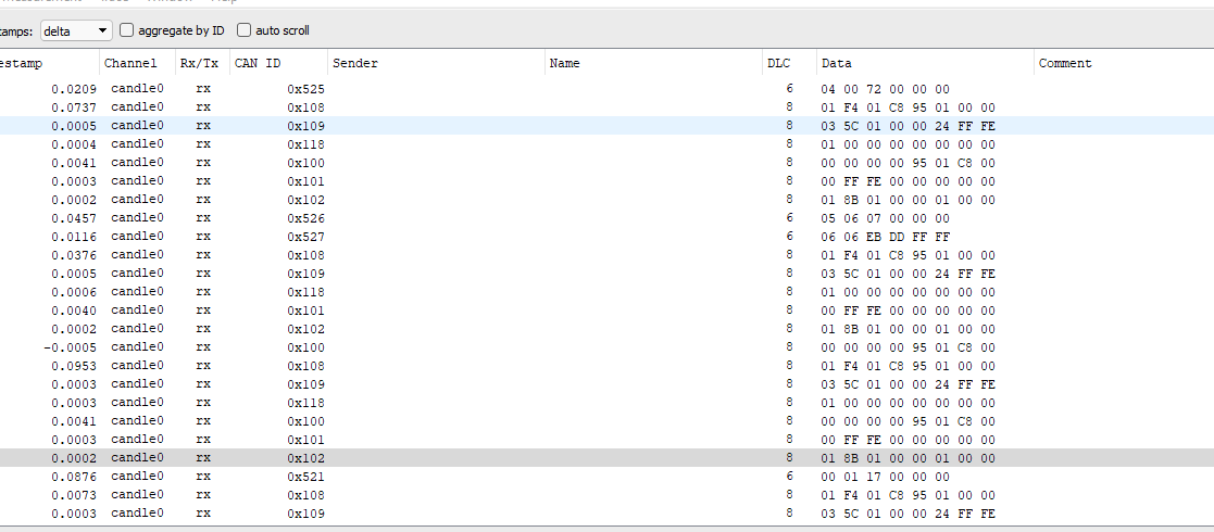

I took a quick CAN log today, unfortunately the software i'm using won't convert to an easily readable file. Here is a screenshot from after the isolation test and the contactors were closed. I need to read up on chademo protocol, but it seems like the controller isn't sending any current request.
Posts: 1884
Has thanked: 91 times
Been thanked: 517 times
Can your software load DBC files? Might be easier to debug with the frames interpreted
https://github.com/dalathegreat/leaf_ca ... AN_ALL.dbc

Post by Dusty4 »
Nope. I'm using Cangaroo, with a canable dongle.. I'll look into something a bit better.

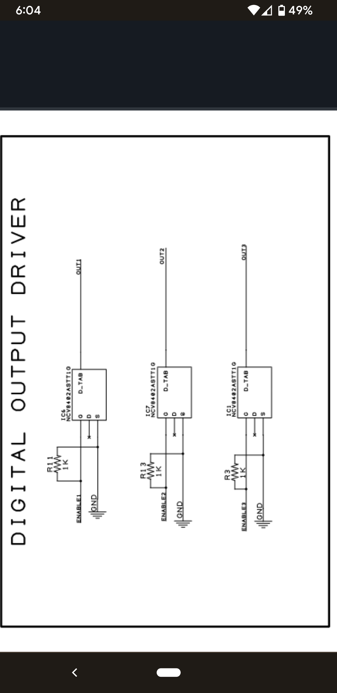

I have found a hardware fault, fitted to the board is a bsp75n low side driver and on the schematic is a ncv8402. The difference is the bsp75n has the source on the tab and the ncv8402 has the drain on the tab. I wondered why the the HV enable pin was earthed the all the time 😂.

Dusty4 wrote: Thu Jul 07, 2022 1:36 pm Nope. I'm using Cangaroo, with a canable dongle.. I'll look into something a bit better.
For can sniffing try https://www.savvycan.com/

Dusty4 wrote: Fri Jul 08, 2022 10:13 am I have found a hardware fault, fitted to the board is a bsp75n low side driver and on the schematic is a ncv8402. The difference is the bsp75n has the source on the tab and the ncv8402 has the drain on the tab. I wondered why the the HV enable pin was earthed the all the time 😂.
Yeah, this has happened before: https://openinverter.org/forum/viewtopi ... 749#p28749
Al Savage
2014 RAV4 EV
NissanDiesel
Dusty4
Posts: 85
Joined: Tue Dec 25, 2018 12:41 pm
Location: Western Australia
Has thanked: 11 times
Been thanked: 9 times
Post by Dusty4 »
Ah I see.. At least it's an easy fix.

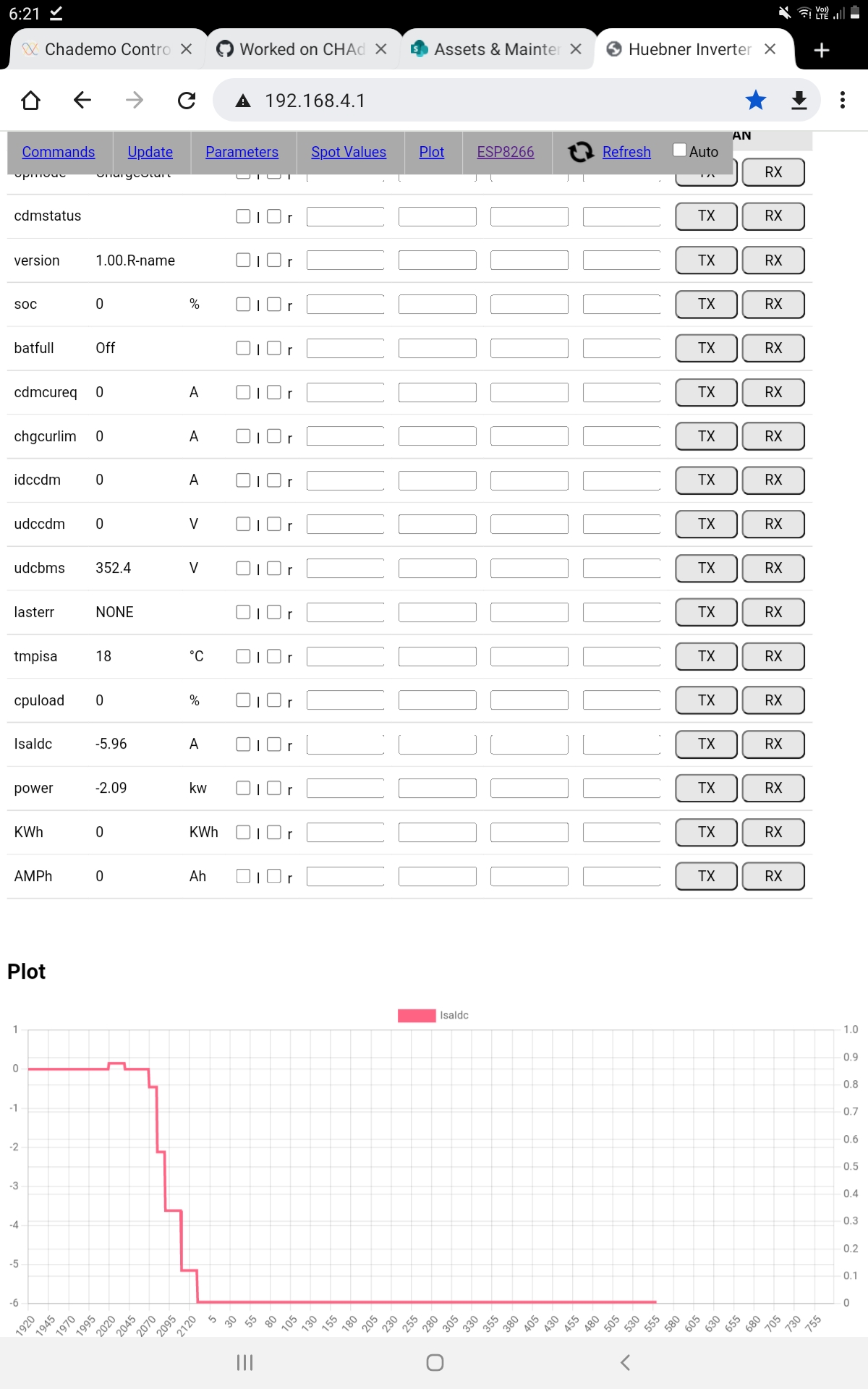

The same happened to me couple of posts back. I solved that by first changing ISA direction (simply turned it over) and later i reprogrammed it via CAN to show negative current when charging. It seems it works on all but one ultra fast EVSE.
Posts: 1884
The EVSE never reports any current flow, Im not sure that's the issue, but can give it a go. I'm wondering if I've got a dodgy pin in the inlet.
*EDIT* My shunt already reports positive for discharging and negative for charging.

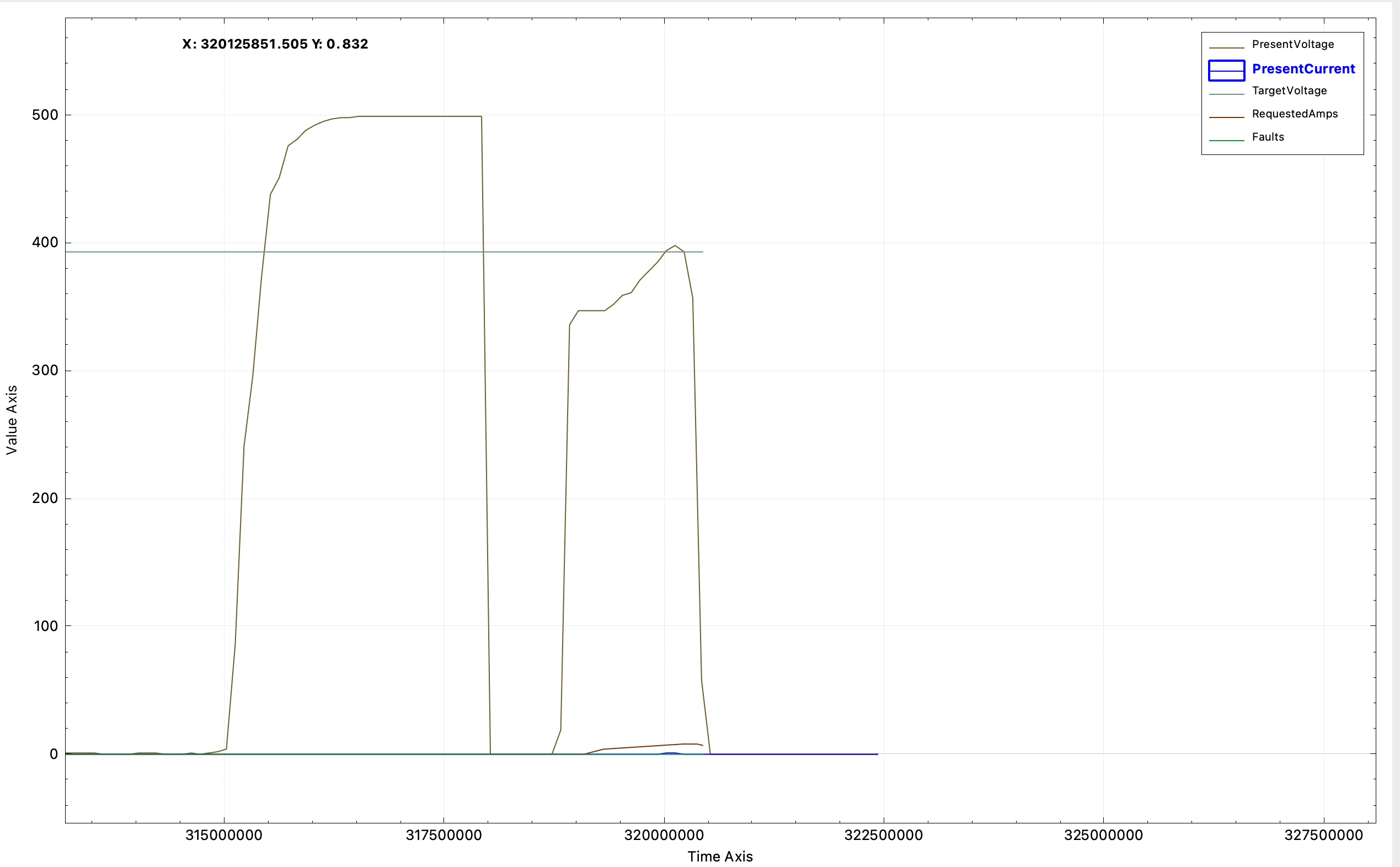

It's strange, the station matches my voltage then just goes right up after requesting a small amount of current. Sort of like the conactors have opened.
09:15:11.824 -> JLD505: 347.265v 0.04A 29.1Ah 0.0kW 9.8kWh OUT1:1 OUT2:1 OUT3:1 IN1:1 IN2:0 CHG T: 52
09:15:11.824 -> CAR: Protocol:2 Target Voltage: 393 Current Command: 4 Target Amps: 50 Faults: 0 Status: 1 kWh: 9.82 Time:0:0:53.8
09:15:11.824 -> EVSE: Measured Voltage: 347 Current: 0 Time remaining: 5400 Status: 101 Time:0:0:53.21
09:15:11.936 -> EVSE: Measured Voltage: 352 Current: 0 Time remaining: 5340 Status: 101 Time:0:0:53.121
09:15:12.048 -> EVSE: Measured Voltage: 359 Current: 0 Time remaining: 5340 Status: 101 Time:0:0:53.221
09:15:12.122 -> EVSE: Measured Voltage: 361 Current: 0 Time remaining: 5340 Status: 101 Time:0:0:53.321
09:15:12.229 -> EVSE: Measured Voltage: 371 Current: 0 Time remaining: 5340 Status: 101 Time:0:0:53.421
09:15:12.303 -> JLD505: 357.567v -0.39A 29.1Ah -0.1kW 9.8kWh OUT1:1 OUT2:1 OUT3:1 IN1:1 IN2:0 CHG T: 53
09:15:12.341 -> EVSE: Measured Voltage: 378 Current: 0 Time remaining: 5340 Status: 101 Time:0:0:53.521
09:15:12.454 -> EVSE: Measured Voltage: 385 Current: 0 Time remaining: 5340 Status: 101 Time:0:0:53.621
09:15:12.530 -> EVSE: Measured Voltage: 394 Current: 1 Time remaining: 5340 Status: 101 Time:0:0:53.721
09:15:12.638 -> EVSE: Measured Voltage: 398 Current: 1 Time remaining: 5340 Status: 101 Time:0:0:53.821
09:15:12.751 -> EVSE: Measured Voltage: 393 Current: 0 Time remaining: 5340 Status: 100111 Time:0:0:53.921
09:15:12.751 -> EVSE:stop charging.
Pain to debug, as it seems to work find at home, with 12v in pin 2 and gnd on pins 10 and 1.

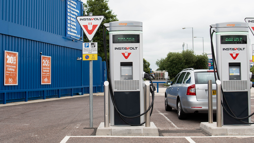

Rolled back to a known working version and I've managed to charge at the BP unit again.
I've come across an InstaVolt that seems to do things in an odd way, it grounds pin 10 first and then gives 12v to pin 2 and the code seems to start ramping current requests too early. Charge fails. Extract of log below and full log attached. I'll see if I can modify the code to work, after a few more successes on the BP to prove it wasn't a fluke.
(IN2 is active low)

14:31:07.345 -> JLD505: 348.100v 0.03A 29.0Ah 0.0kW 9.2kWh OUT1:0 OUT2:0 OUT3:1 IN1:0 IN2:0 POS:Op NEG:Op CHG T: 0
14:31:07.843 -> CAR: VCU Wake Up Time:0:1:35.491
14:31:07.843 -> JLD505: 348.097v 0.05A 29.0Ah 0.0kW 9.2kWh OUT1:0 OUT2:0 OUT3:1 IN1:0 IN2:0 POS:Op NEG:Op CHG T: 1
4:31:09.335 -> CAR: VCU Wake Up Time:0:1:36.991
14:31:09.335 -> JLD505: 348.092v 0.03A 29.0Ah 0.0kW 9.2kWh OUT1:0 OUT2:0 OUT3:1 IN1:0 IN2:0 POS:Op NEG:Op CHG T: 0
14:31:09.853 -> CAR: VCU Wake Up Time:0:1:37.491
14:31:09.853 -> JLD505: 348.098v 0.03A 29.0Ah 0.0kW 9.2kWh OUT1:0 OUT2:0 OUT3:1 IN1:1 IN2:0 POS:Op NEG:Op CHG T: 1
14:31:10.296 -> Starting Chademo process.
14:31:10.329 -> CAR: VCU Wake Up Time:0:1:37.991
14:31:10.329 -> JLD505: 348.100v 0.03A 29.0Ah 0.0kW 9.2kWh OUT1:0 OUT2:0 OUT3:1 IN1:1 IN2:0 POS:Op NEG:Op CHG T: 0
14:31:10.329 -> Chademo Mode: 12
14:31:10.329 -> Sent params to EVSE. Waiting.
14:31:10.364 -> CAR: Absolute MAX Voltage:400 Pack size: 18.00 Time:0:1:38.8
14:31:10.440 -> CAR: Charging Time Time:0:1:38.82
14:31:10.515 -> CAR: Protocol:1 Target Voltage: 393 Current Command: 16 Target Amps: 50 Faults: 0 Status: 0 kWh: 9.20 Time:0:1:38.158
14:31:10.587 -> CAR: Absolute MAX Voltage:400 Pack size: 18.00 Time:0:1:38.233
14:31:10.658 -> CAR: Charging Time Time:0:1:38.308
14:31:10.696 -> EVSE: MaxVoltage: 950 Max Current:125 Threshold Voltage:475 Time:0:1:38.336
14:31:10.696 -> EVSE: Measured Voltage: 0 Current: 0 Time remaining: 0 Status: 100000 Time:0:1:38.336
14:31:10.734 -> CAR: Protocol:2 Target Voltage: 393 Current Command: 15 Target Amps: 50 Faults: 0 Status: 1000 kWh: 9.20 Time:0:1:38.383
14:31:10.770 -> CAR:Charge enable ON
14:31:10.770 -> EVSE: MaxVoltage: 950 Max Current:125 Threshold Voltage:475 Time:0:1:38.436
14:31:10.770 -> EVSE: Measured Voltage: 0 Current: 0 Time remaining: 0 Status: 100000 Time:0:1:38.436

One thing you might need to double check is if the code logic matches the hardware in terms of IN1 and IN2. Depending on weather optocouplers are used or not the signal might be inverted. Can’t remember the exact details and probably is not the root cause since then probably it would not have worked at all but still worth checking.
Posts: 1884
Yea, checked and double checked these, Start 1 is connected to IN1 active high, and Start 2 is connected to IN2 active low. Will get more logs and try investigate what's going on.
Charging worked again on other units, but the Instavolts still refusing to go, same deal, they switch IN2 first, that doesn't prevent it carrying on to closing the contactors but current doesn't seem to flow despite requesting so.
Forgot my can logger again, doh.
12:10:16.010 -> CAR: Protocol:2 Target Voltage: 393 Current Command: 14 Target Amps: 50 Faults: 0 Status: 1 kWh: 6.61 Time:0:0:49.708
12:10:16.082 -> CAR: Absolute MAX Voltage:400 Pack size: 18.00 Time:0:0:49.783
12:10:16.117 -> EVSE: MaxVoltage: 950 Max Current:78 Threshold Voltage:475 Time:0:0:49.791
12:10:16.117 -> EVSE: Measured Voltage: 352 Current: 0 Time remaining: 0 Status: 100100 Time:0:0:49.791
12:10:16.154 -> CAR: Charging Time Time:0:0:49.857
12:10:16.192 -> EVSE: MaxVoltage: 950 Max Current:78 Threshold Voltage:475 Time:0:0:49.891
12:10:16.192 -> EVSE: Measured Voltage: 352 Current: 0 Time remaining: 0 Status: 100100 Time:0:0:49.892
12:10:16.230 -> CAR: Protocol:2 Target Voltage: 393 Current Command: 15 Target Amps: 50 Faults: 0 Status: 1 kWh: 6.61 Time:0:0:49.933
12:10:16.301 -> CAR: VCU Wake Up Time:0:0:49.991
12:10:16.301 -> JLD505: 351.301v -0.54A 24.7Ah -0.2kW 6.6kWh OUT1:1 OUT2:1 OUT3:1 IN1:1 IN2:0 POS:Cl NEG:Cl CHG T: 4
12:10:16.301 -> Chademo Mode: 6
12:10:16.301 -> EVSE: MaxVoltage: 950 Max Current:78 Threshold Voltage:475 Time:0:0:49.992
12:10:16.301 -> EVSE: Measured Voltage: 352 Current: 0 Time remaining: 0 Status: 100100 Time:0:0:49.992
12:10:16.336 -> CAR: Absolute MAX Voltage:400 Pack size: 18.00 Time:0:0:50.7
12:10:16.336 -> Stopping chademo process.
