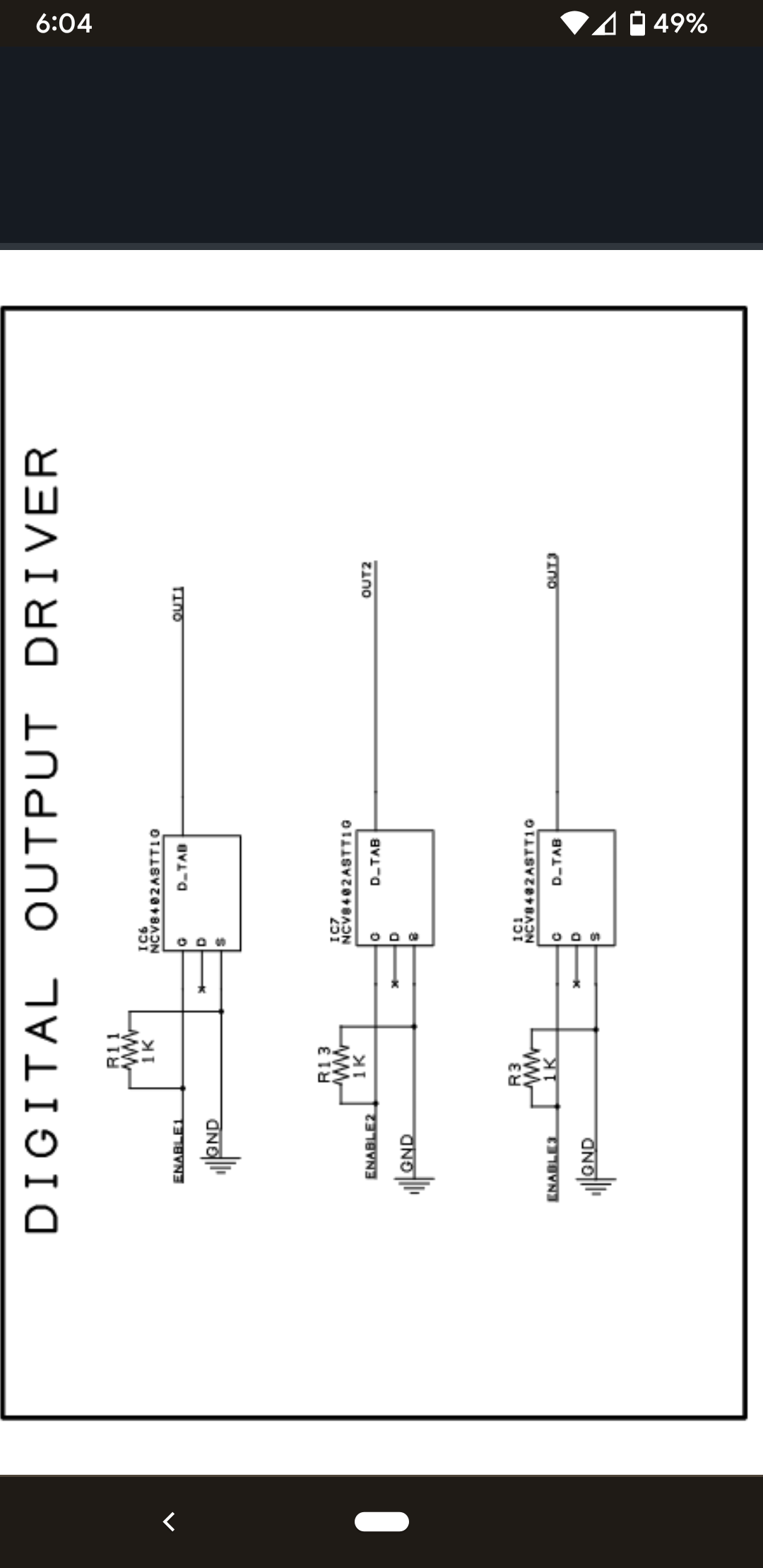

I have found a hardware fault, fitted to the board is a bsp75n low side driver and on the schematic is a ncv8402. The difference is the bsp75n has the source on the tab and the ncv8402 has the drain on the tab. I wondered why the the HV enable pin was earthed the all the time 😂.

Dusty4 wrote: Fri Jul 08, 2022 10:13 am I have found a hardware fault, fitted to the board is a bsp75n low side driver and on the schematic is a ncv8402. The difference is the bsp75n has the source on the tab and the ncv8402 has the drain on the tab. I wondered why the the HV enable pin was earthed the all the time 😂.
Yeah, this has happened before: https://openinverter.org/forum/viewtopi ... 749#p28749

Ah I see.. At least it's an easy fix.

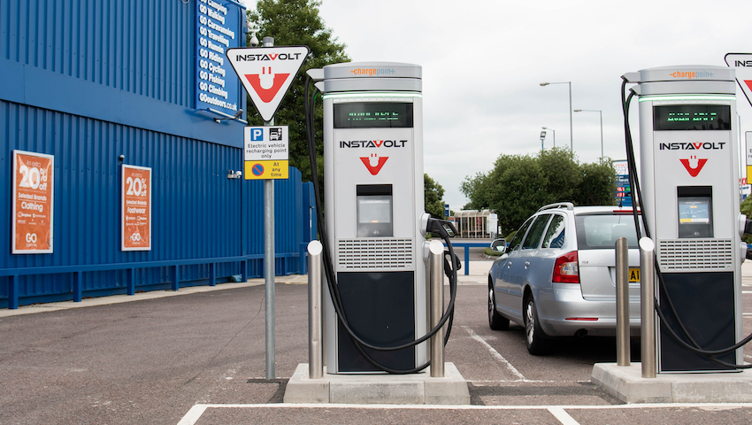

Still having Chademo issues, I've managed a couple of sessions, but more often than not I get failures.
I hear the lock in the connector click, then my chademo contactors click closed, then they open again after 5 seconds or so.
Any pointers?
EVSE:fault code 27 Abort, then EVSE:fault code 26 Abort. then EVSE:fault code 22 Abort.

Bigpie wrote: Sat Jul 16, 2022 9:11 am Still having Chademo issues, I've managed a couple of sessions, but more often than not I get failures.
Any pointers?
The same happened to me couple of posts back. I solved that by first changing ISA direction (simply turned it over) and later i reprogrammed it via CAN to show negative current when charging. It seems it works on all but one ultra fast EVSE.

It's strange, the station matches my voltage then just goes right up after requesting a small amount of current. Sort of like the conactors have opened.

Pain to debug, as it seems to work find at home, with 12v in pin 2 and gnd on pins 10 and 1.
Posts: 1782
Has thanked: 83 times
Been thanked: 429 times
Rolled back to a known working version and I've managed to charge at the BP unit again.
I've come across an InstaVolt that seems to do things in an odd way, it grounds pin 10 first and then gives 12v to pin 2 and the code seems to start ramping current requests too early. Charge fails. Extract of log below and full log attached. I'll see if I can modify the code to work, after a few more successes on the BP to prove it wasn't a fluke.
(IN2 is active low)

One thing you might need to double check is if the code logic matches the hardware in terms of IN1 and IN2. Depending on weather optocouplers are used or not the signal might be inverted. Can’t remember the exact details and probably is not the root cause since then probably it would not have worked at all but still worth checking.
Posts: 1782
Yea, checked and double checked these, Start 1 is connected to IN1 active high, and Start 2 is connected to IN2 active low. Will get more logs and try investigate what's going on.

12:10:16.010 -> CAR: Protocol:2 Target Voltage: 393 Current Command: 14 Target Amps: 50 Faults: 0 Status: 1 kWh: 6.61 Time:0:0:49.708
12:10:16.082 -> CAR: Absolute MAX Voltage:400 Pack size: 18.00 Time:0:0:49.783
12:10:16.117 -> EVSE: MaxVoltage: 950 Max Current:78 Threshold Voltage:475 Time:0:0:49.791
12:10:16.117 -> EVSE: Measured Voltage: 352 Current: 0 Time remaining: 0 Status: 100100 Time:0:0:49.791
12:10:16.154 -> CAR: Charging Time Time:0:0:49.857
12:10:16.192 -> EVSE: MaxVoltage: 950 Max Current:78 Threshold Voltage:475 Time:0:0:49.891
12:10:16.192 -> EVSE: Measured Voltage: 352 Current: 0 Time remaining: 0 Status: 100100 Time:0:0:49.892
12:10:16.230 -> CAR: Protocol:2 Target Voltage: 393 Current Command: 15 Target Amps: 50 Faults: 0 Status: 1 kWh: 6.61 Time:0:0:49.933
12:10:16.301 -> CAR: VCU Wake Up Time:0:0:49.991
12:10:16.301 -> JLD505: 351.301v -0.54A 24.7Ah -0.2kW 6.6kWh OUT1:1 OUT2:1 OUT3:1 IN1:1 IN2:0 POS:Cl NEG:Cl CHG T: 4
12:10:16.301 -> Chademo Mode: 6
12:10:16.301 -> EVSE: MaxVoltage: 950 Max Current:78 Threshold Voltage:475 Time:0:0:49.992
12:10:16.301 -> EVSE: Measured Voltage: 352 Current: 0 Time remaining: 0 Status: 100100 Time:0:0:49.992
12:10:16.336 -> CAR: Absolute MAX Voltage:400 Pack size: 18.00 Time:0:0:50.7
12:10:16.336 -> Stopping chademo process.
InstaVoltFail3.txt
