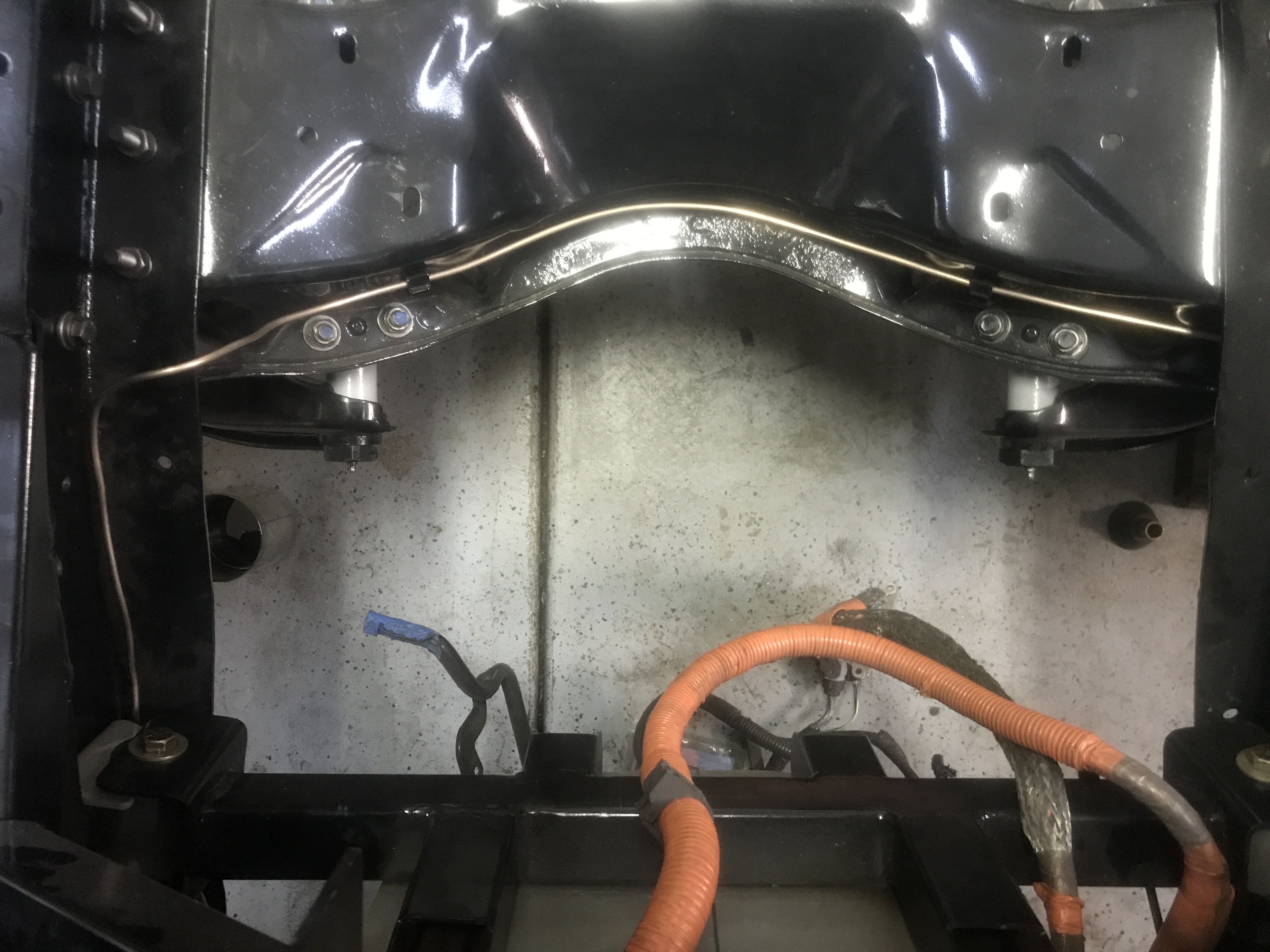

Gregski
Posts: 2755
Has thanked: 508 times
Been thanked: 1066 times
Post by Gregski »
plumbing brakes like a Boss!
nice sweeping curves
Gregski
Posts: 2755
Post by Gregski »
yeah I forgot to put a fitting on my best run, don't judge me
did I mention the nice sweeping curves
Gregski
Posts: 2755
Post by Gregski »
I think once I clamputize them they won't look so wild
and I ran out of line, I guess 15 feet was not enuff, so I gotta buy another spool to do the rear drum brake line run, not all the way back to the rear axle just to the transmission crossmember
