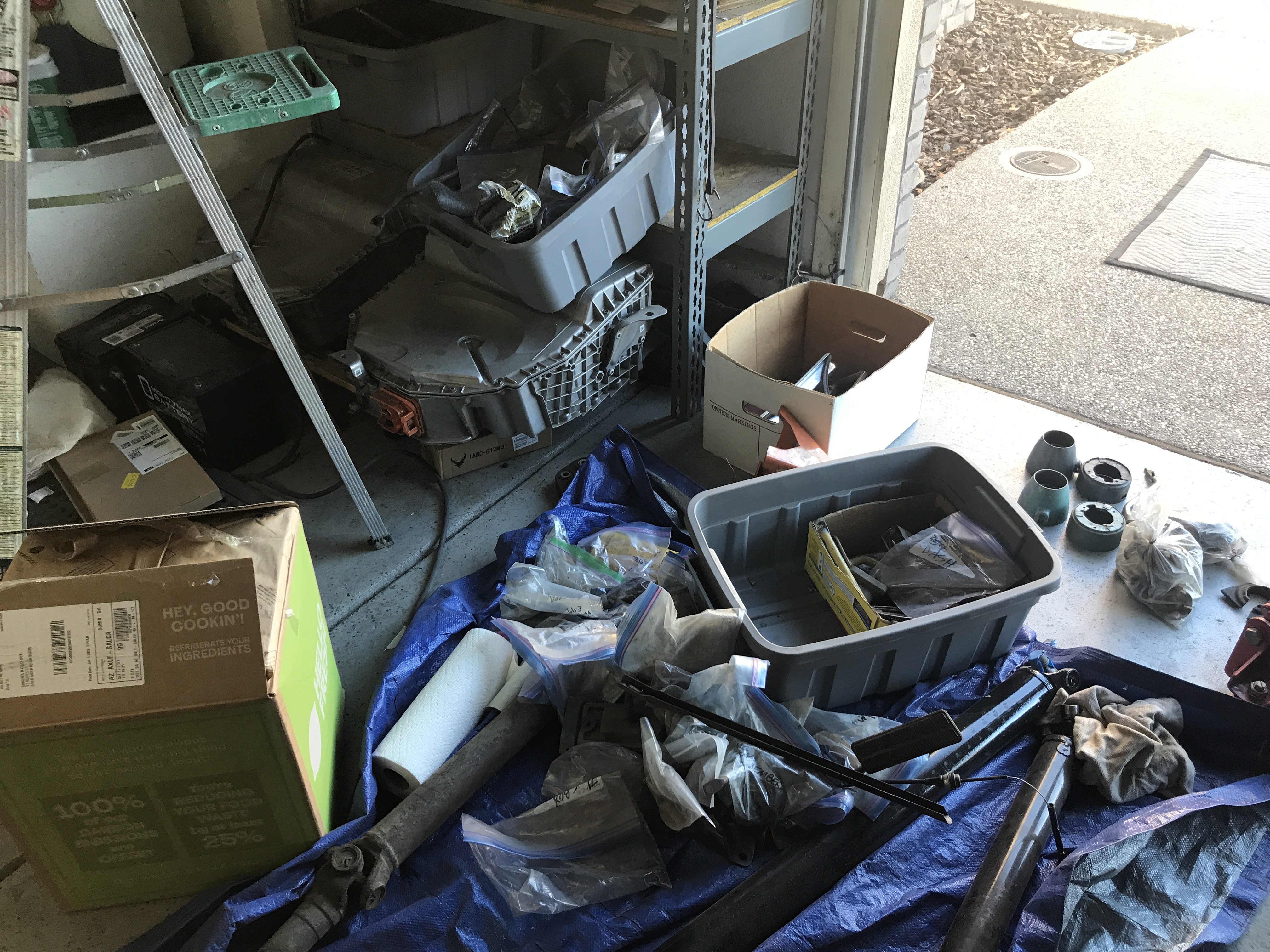

literally as soon as I took the bits above out of the oven I found the missing piece (at the bottom of the Atlantic)

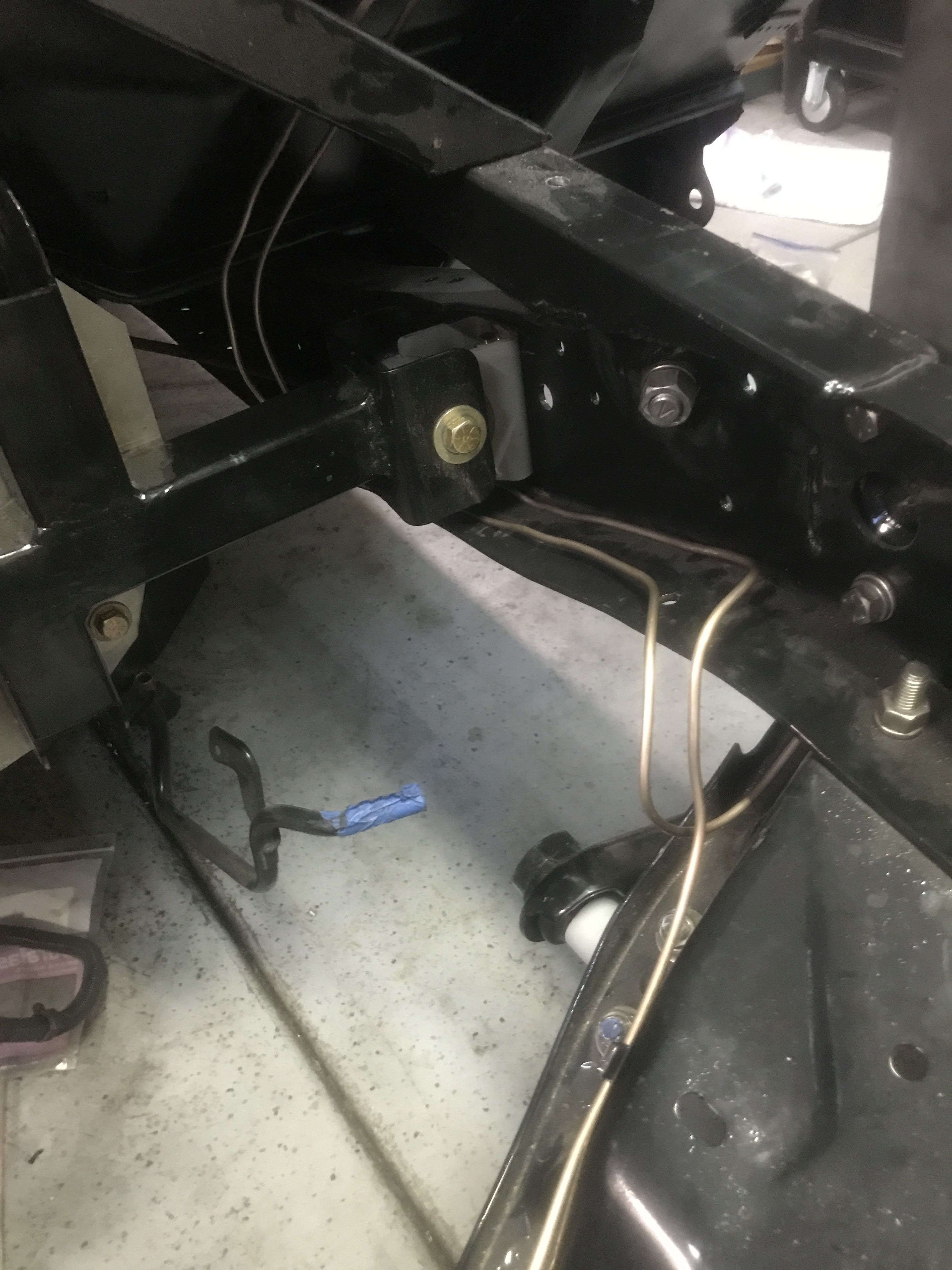

plumbing brakes like a Boss!
nice sweeping curves

yeah I forgot to put a fitting on my best run, don't judge me
did I mention the nice sweeping curves

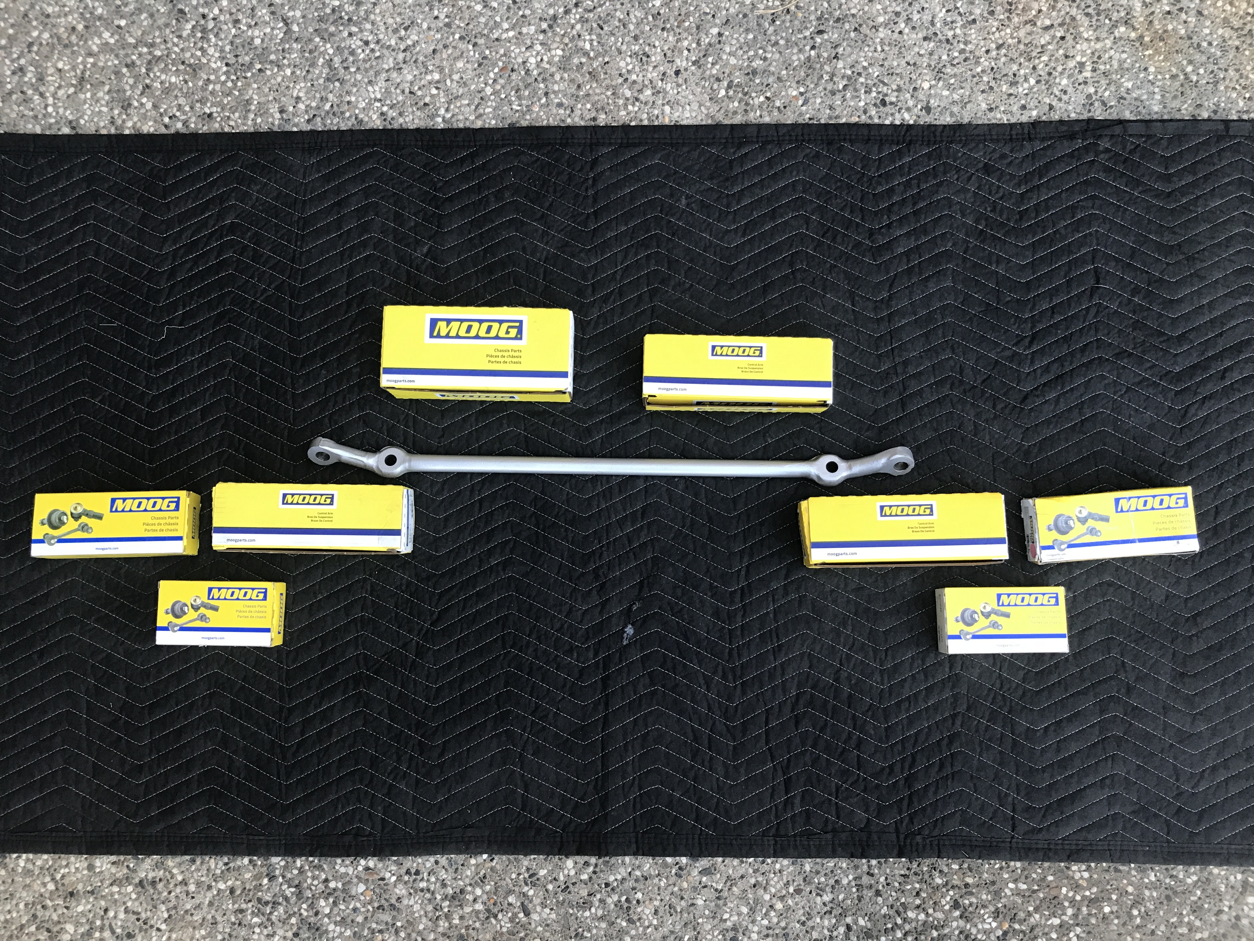

looks like my MOOG steering linkage parts from Rock Auto are on a US tour complements of FedEx
