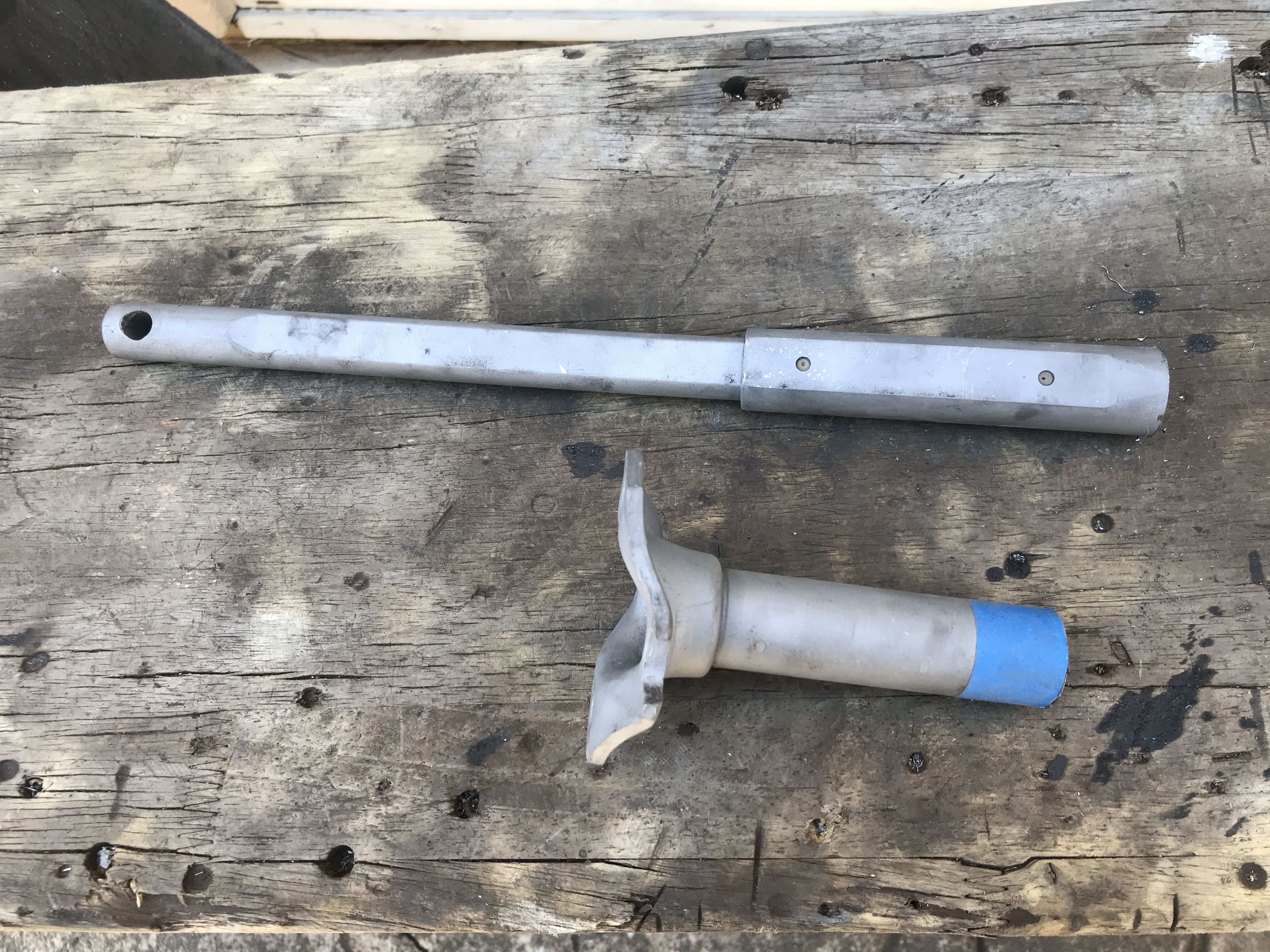

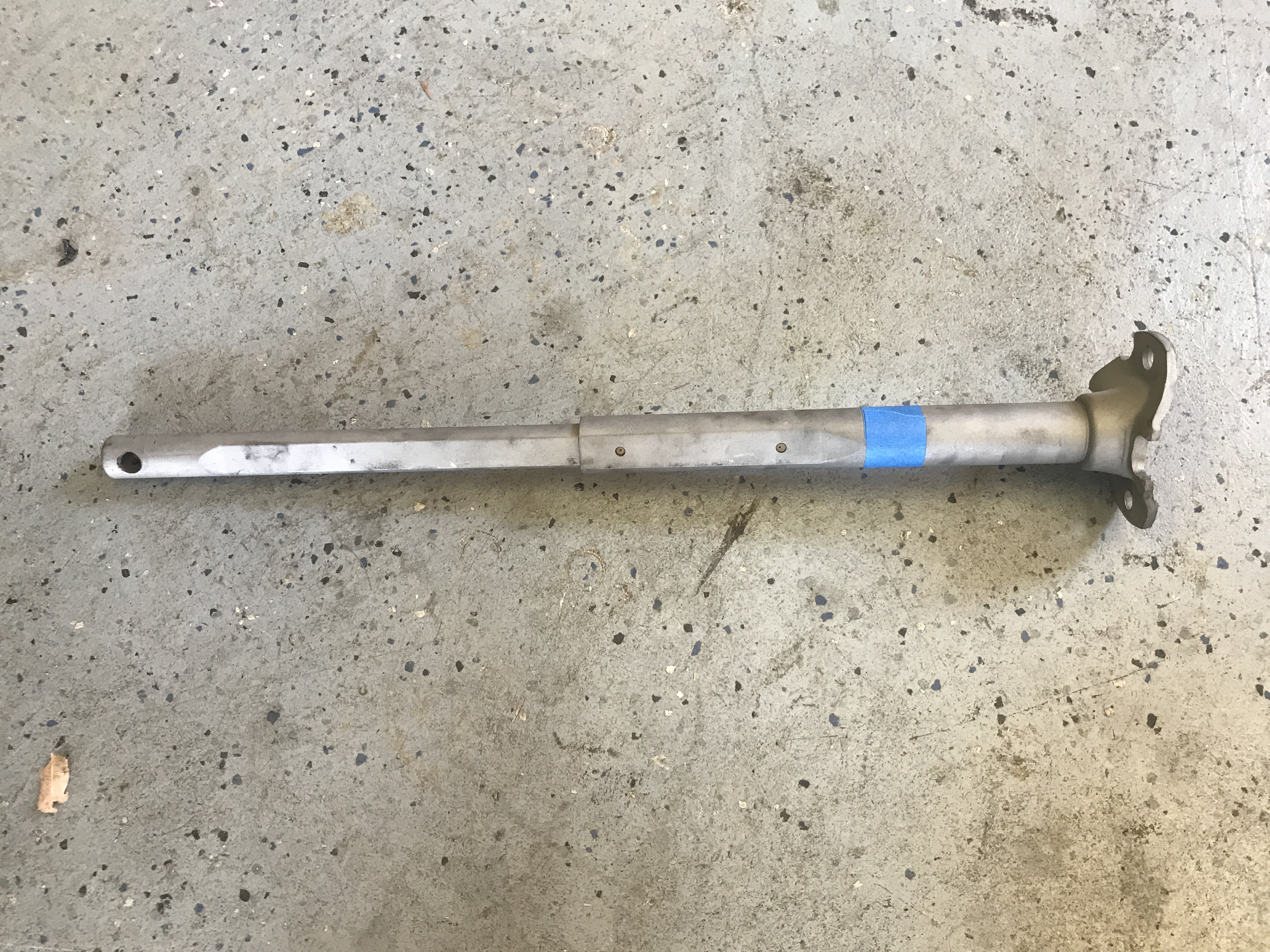

and after all that if I had to do it all over again I would not waste my time pulling it apart I would just cut it right at the join of the two cylinders, in order to expose the shaft
Pull-A-Parter 3000 complete kit with attachments also available in metric

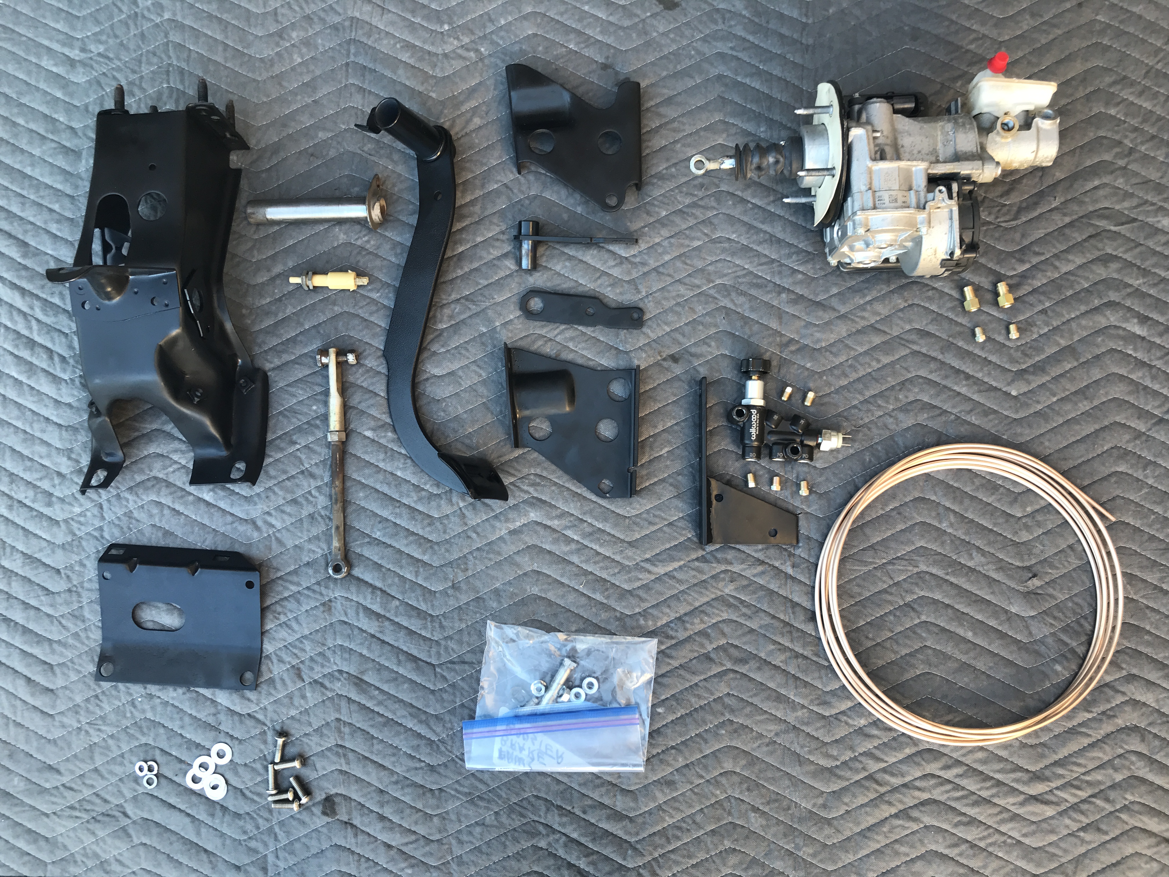

Tesla Honda CRV Model 3 electric power brake booster about to go on
nothin' to it but to do it!

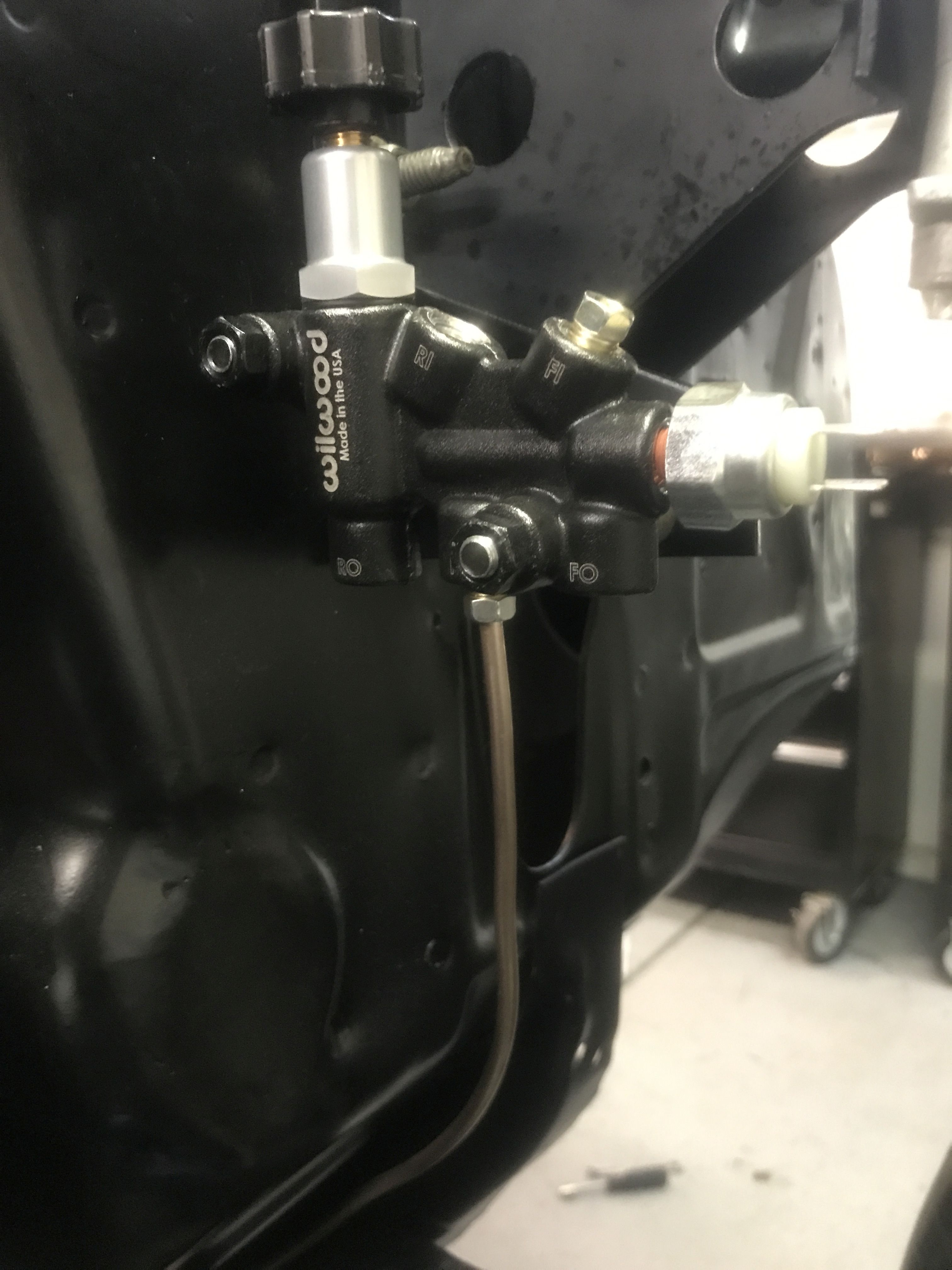

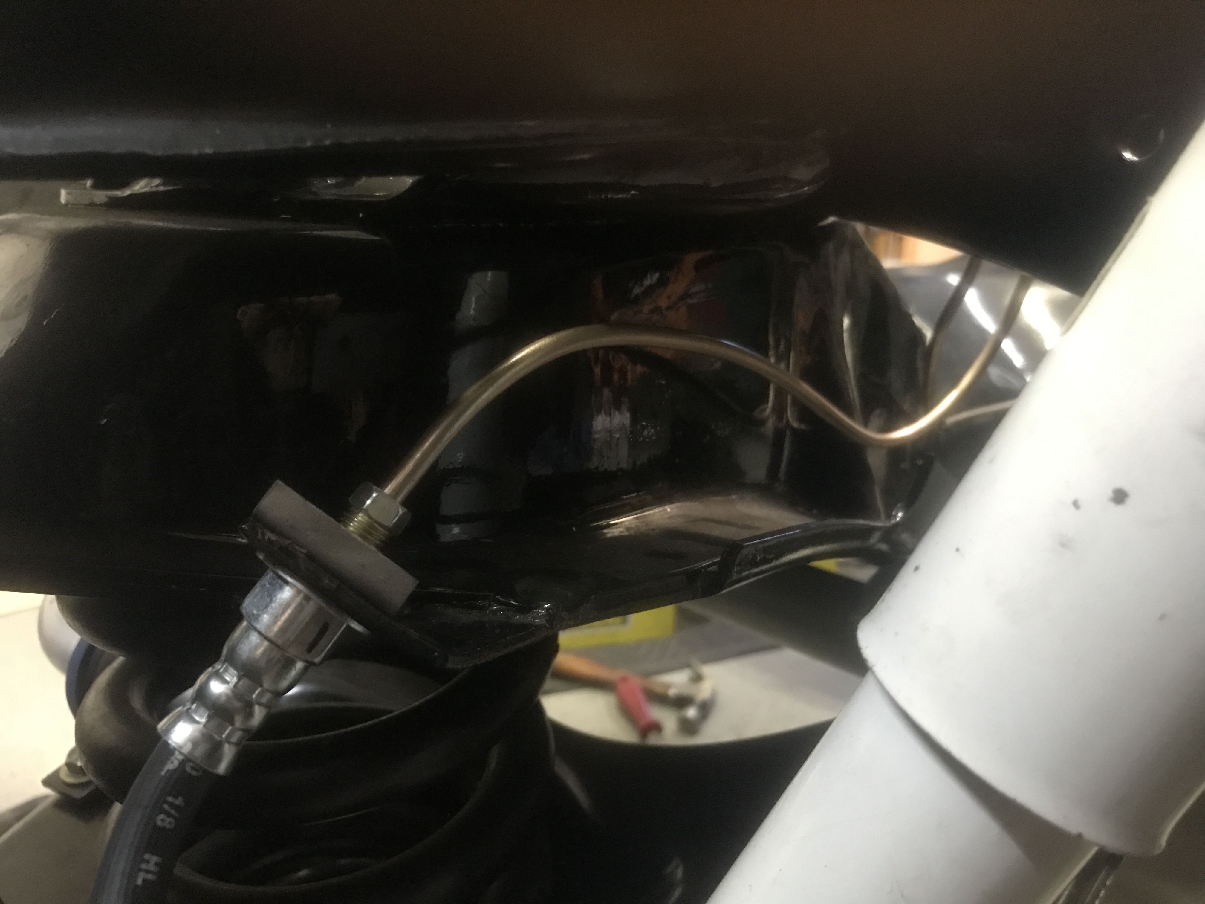

- larsrengersen
- Posts: 171
- Has thanked: 16 times
- Been thanked: 36 times
Must admit that I initially installed the brake lines that way.
However, I now believe swapping them would be the correct and preferred way with rear drum brakes.
If you swap them most fluid displacement will go to the rear in.
But I’m curious what you and others think since in the end you want most stopping power from the front discs but that is up to the valve to handle and residual pressure valve to support.
- Gregski
- Posts: 3161
- Has thanked: 631 times
- Been thanked: 1608 times
thank you for that feedback, really appreciate it, I think swapping those lines shouldn't be too difficult if need be, I believe that Honda CRV came with drums front and rearlarsrengersen wrote: ↑Tue Jul 12, 2022 7:57 pmMust admit that I initially installed the brake lines that way.

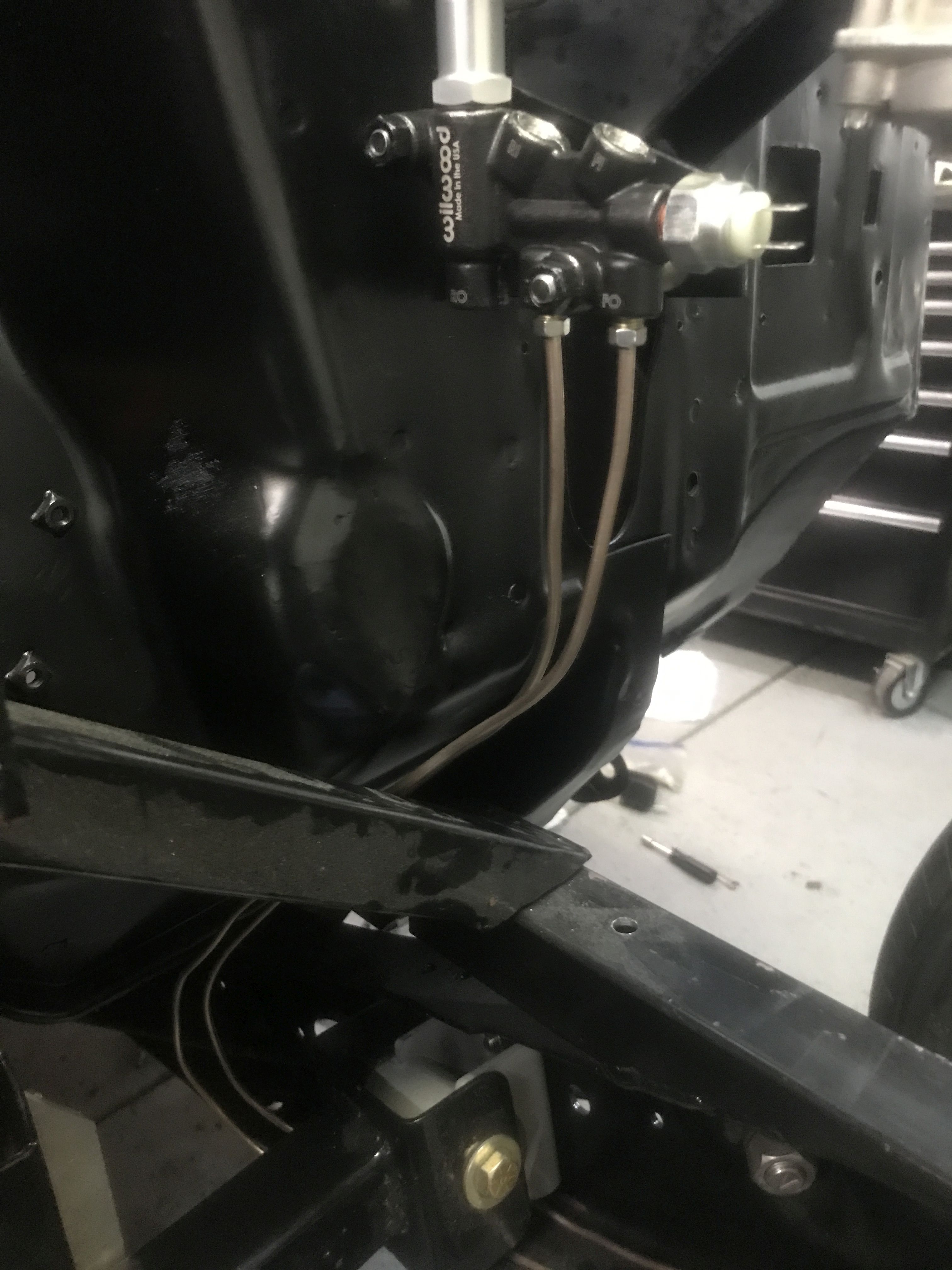

- Gregski
- Posts: 3161
good enuff for government work
and order has been restored

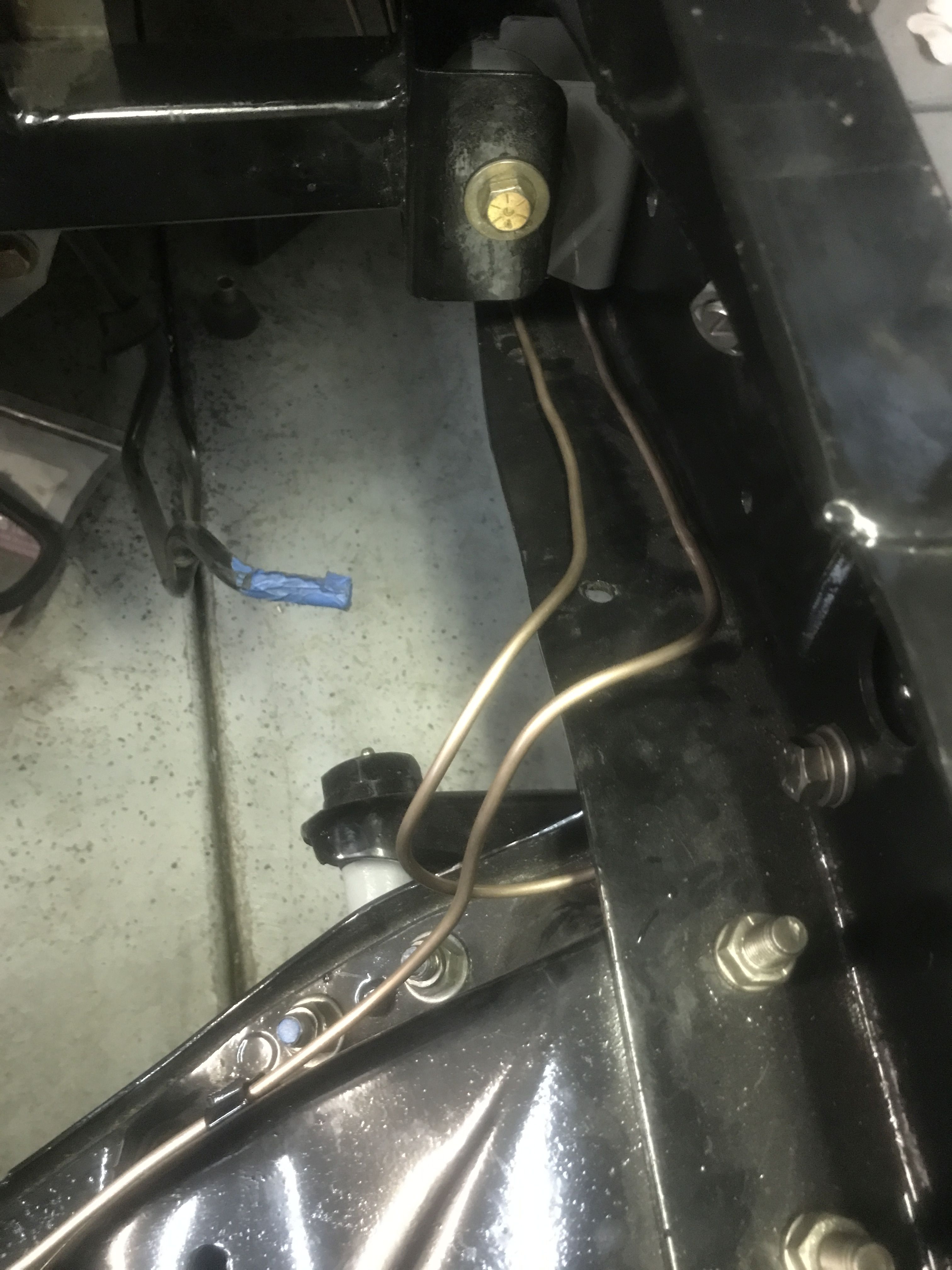

plumbing brakes like a Boss!
nice sweeping curves
- Gregski
- Posts: 3161
yeah I forgot to put a fitting on my best run, don't judge me
did I mention the nice sweeping curves

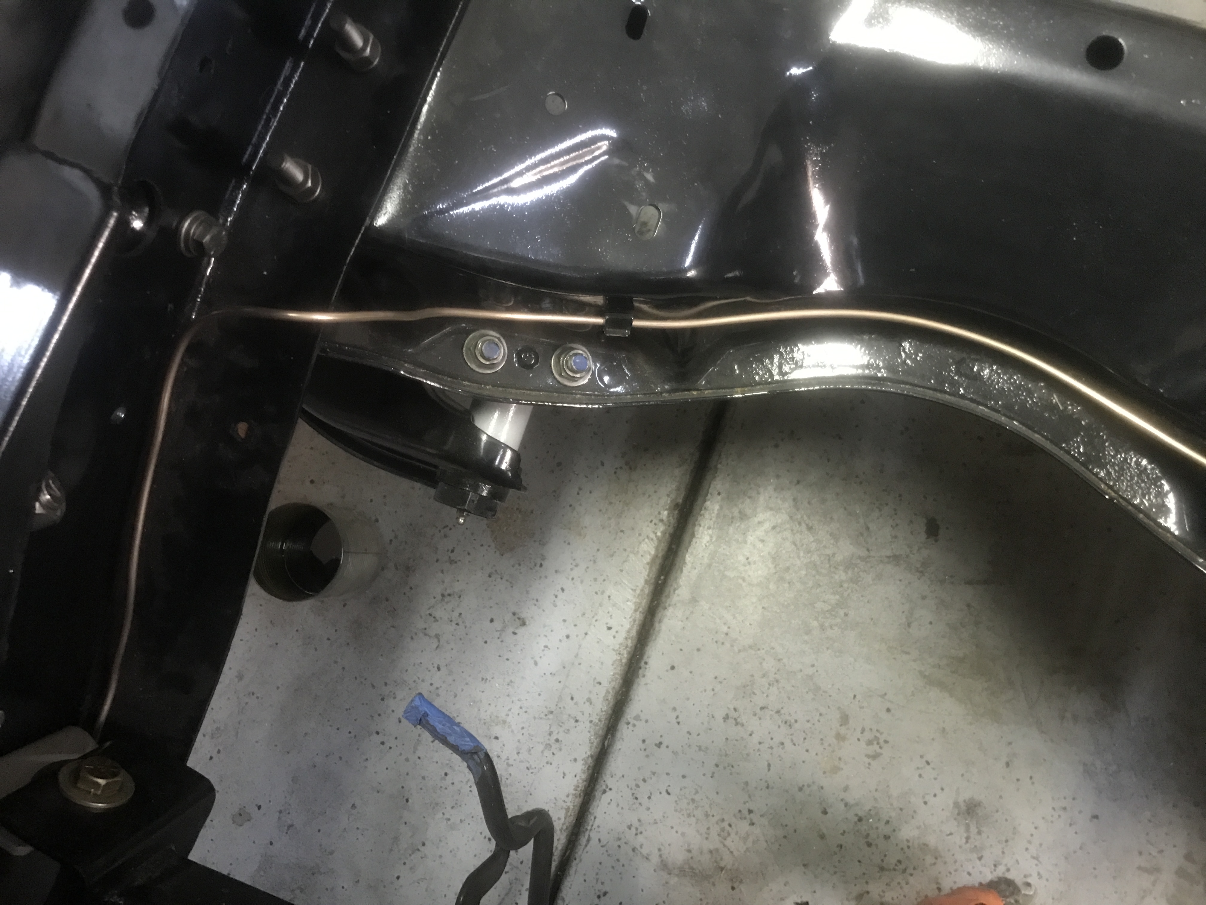

- Gregski
- Posts: 3161
I think once I clamputize them they won't look so wild
and I ran out of line, I guess 15 feet was not enuff, so I gotta buy another spool to do the rear drum brake line run, not all the way back to the rear axle just to the transmission crossmember

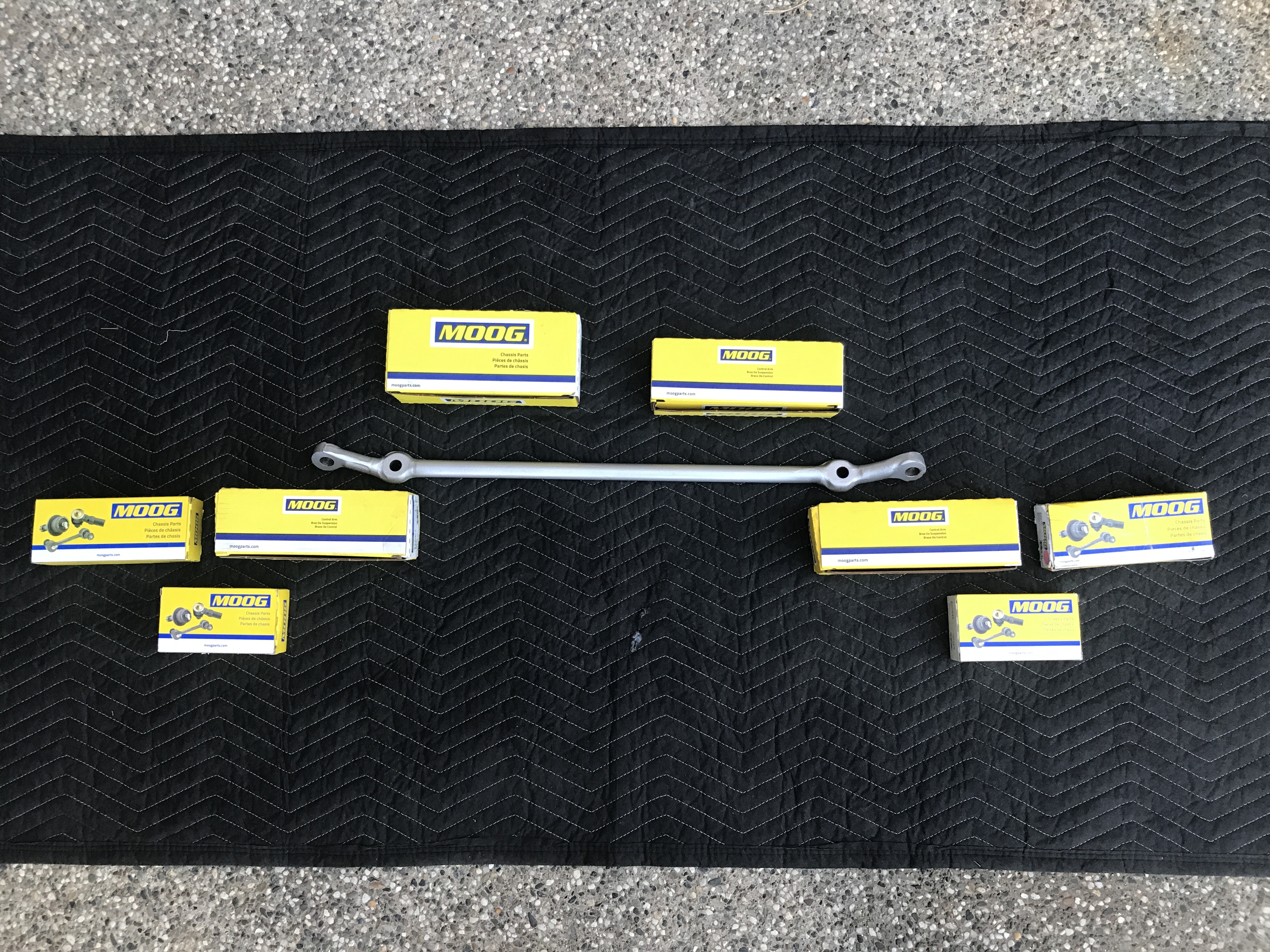

looks like my MOOG steering linkage parts from Rock Auto are on a US tour complements of FedEx
MASPETH, NY
KEASBEY, NJ
SNYDER TWP, PA
PORT CLINTON, OH
CHICAGO, IL
COUNTRYSIDE, IL
CAMDEN, MO
HIGGINS, TX
ENCINO, NM
NAVAJO NATION, AZ
NEEDLES, CA
BAKERSFIELD, CA
STOCKTON, CA
Shipment exception
Weather delay
MASPETH, NY
KEASBEY, NJ
SNYDER TWP, PA
PORT CLINTON, OH
CHICAGO, IL
COUNTRYSIDE, IL
CAMDEN, MO
HIGGINS, TX
ENCINO, NM
NAVAJO NATION, AZ
NEEDLES, CA
BAKERSFIELD, CA
STOCKTON, CA
Shipment exception
Weather delay

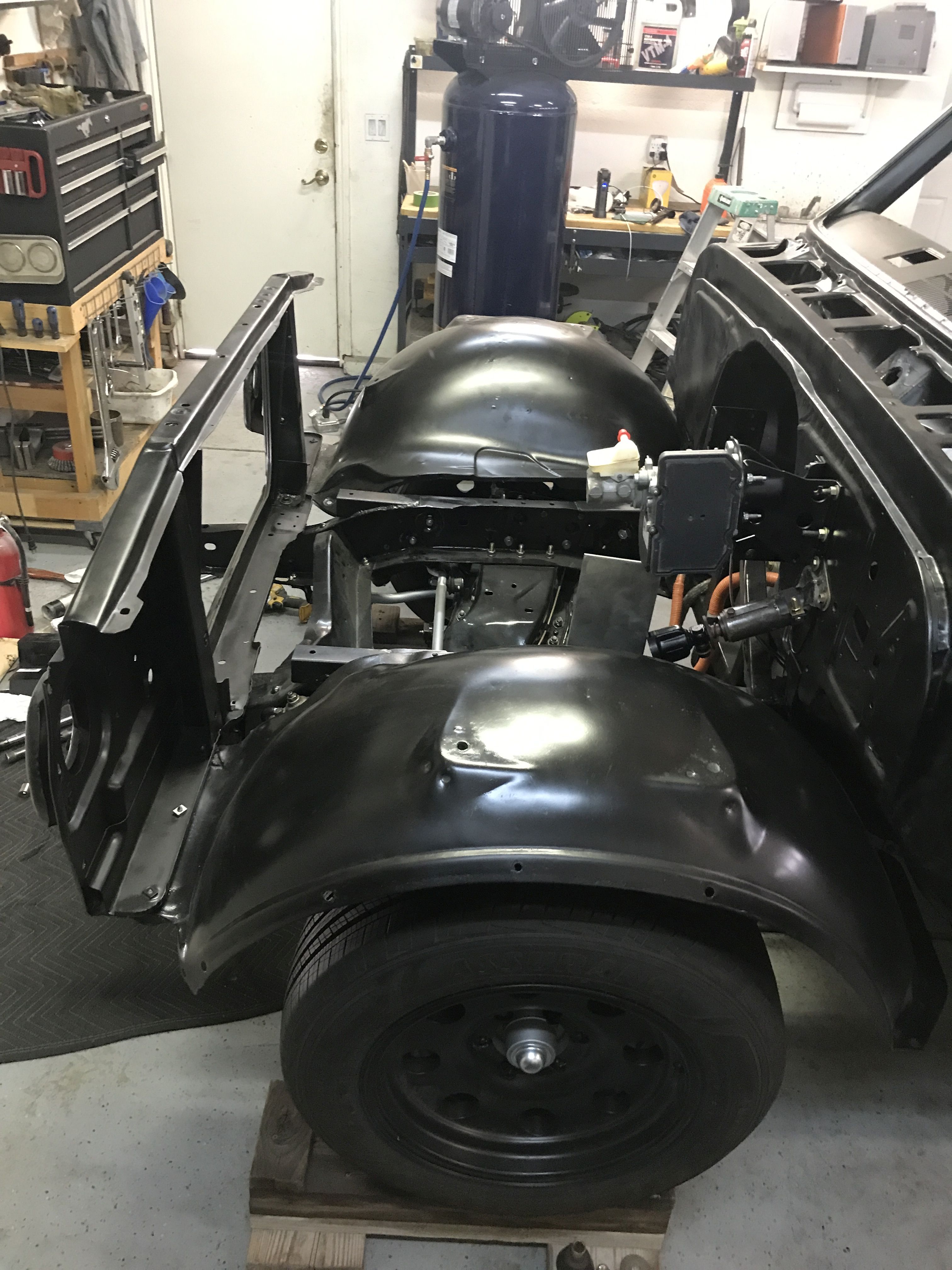

so I decided to install the new old steering column in just for mock up of the Prius electronic power steering
now we can determine the distance the Prius power steering mechanism needs to fill from the Chevy point A to the Chevy point B type of thing

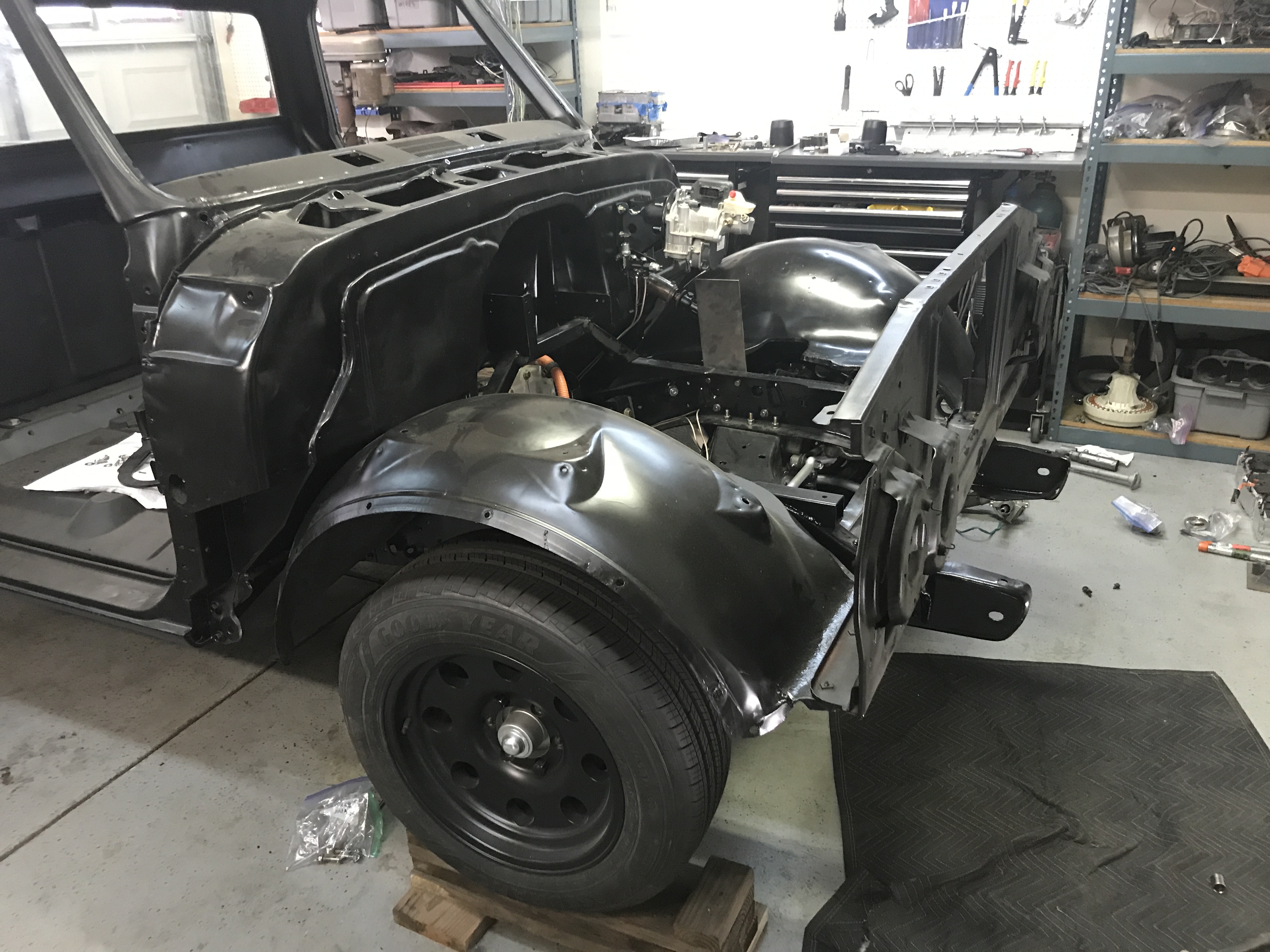

big day today, hope to accomplish quite a bit, install brand new steering linkage, and get the radiator core support and inner fenders back on, among 7 million other little things, you know how it goes...
American version of the rack n pinion steering jobbie thingie
- Gregski
- Posts: 3161
so with a help of a friend got the steering linkage on, the inner fender, and the radiator core support

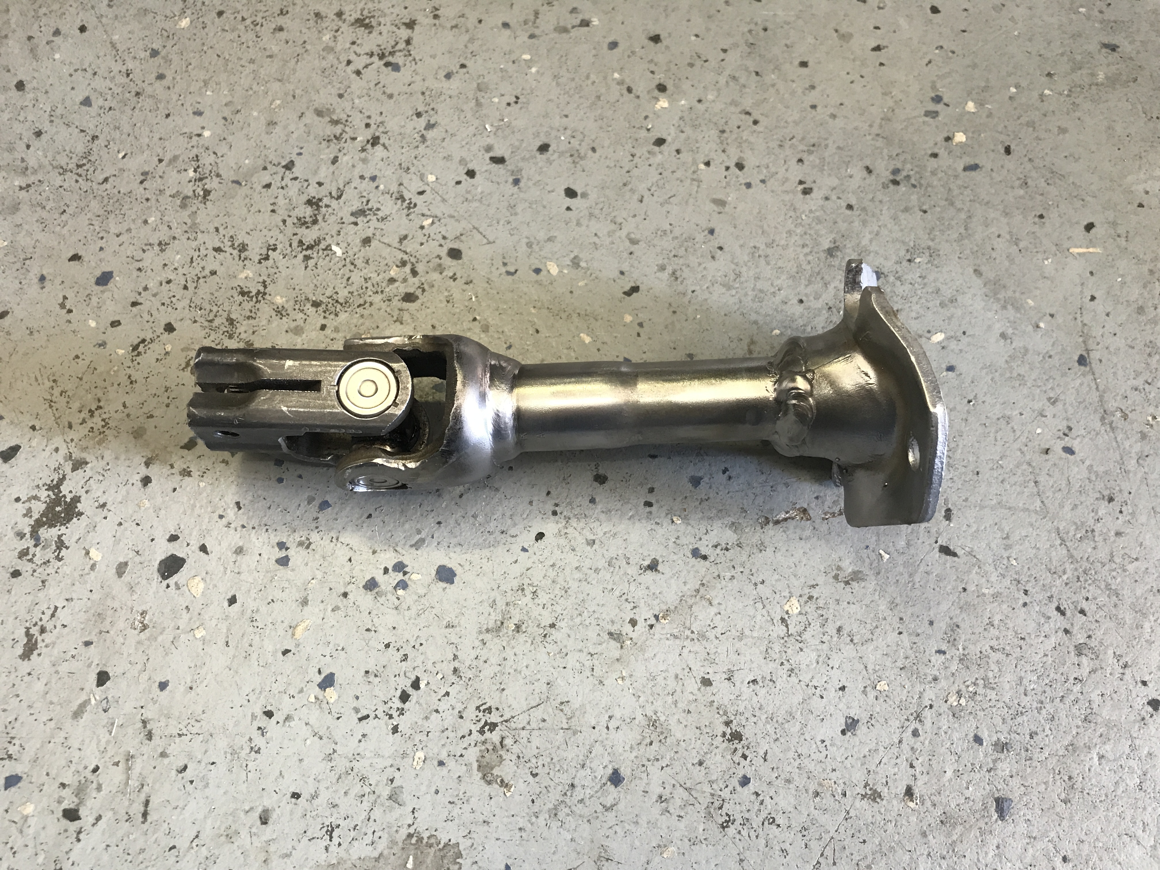

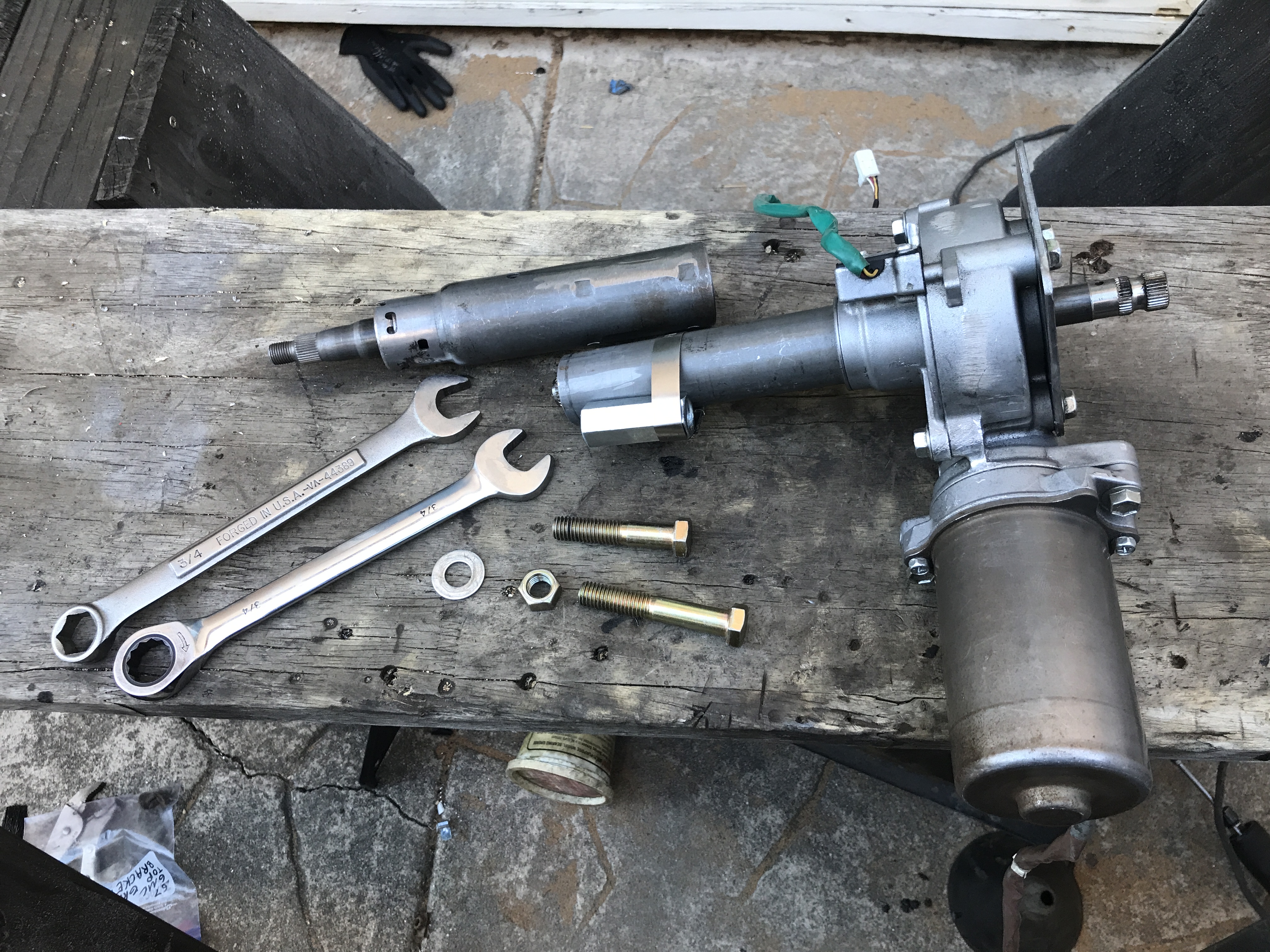

then we took on the Prius power assist steering and decided to graft it into the GM intermediate steering shaft
this end goes to the stock GM manual steering box connected via what is called a rag joint

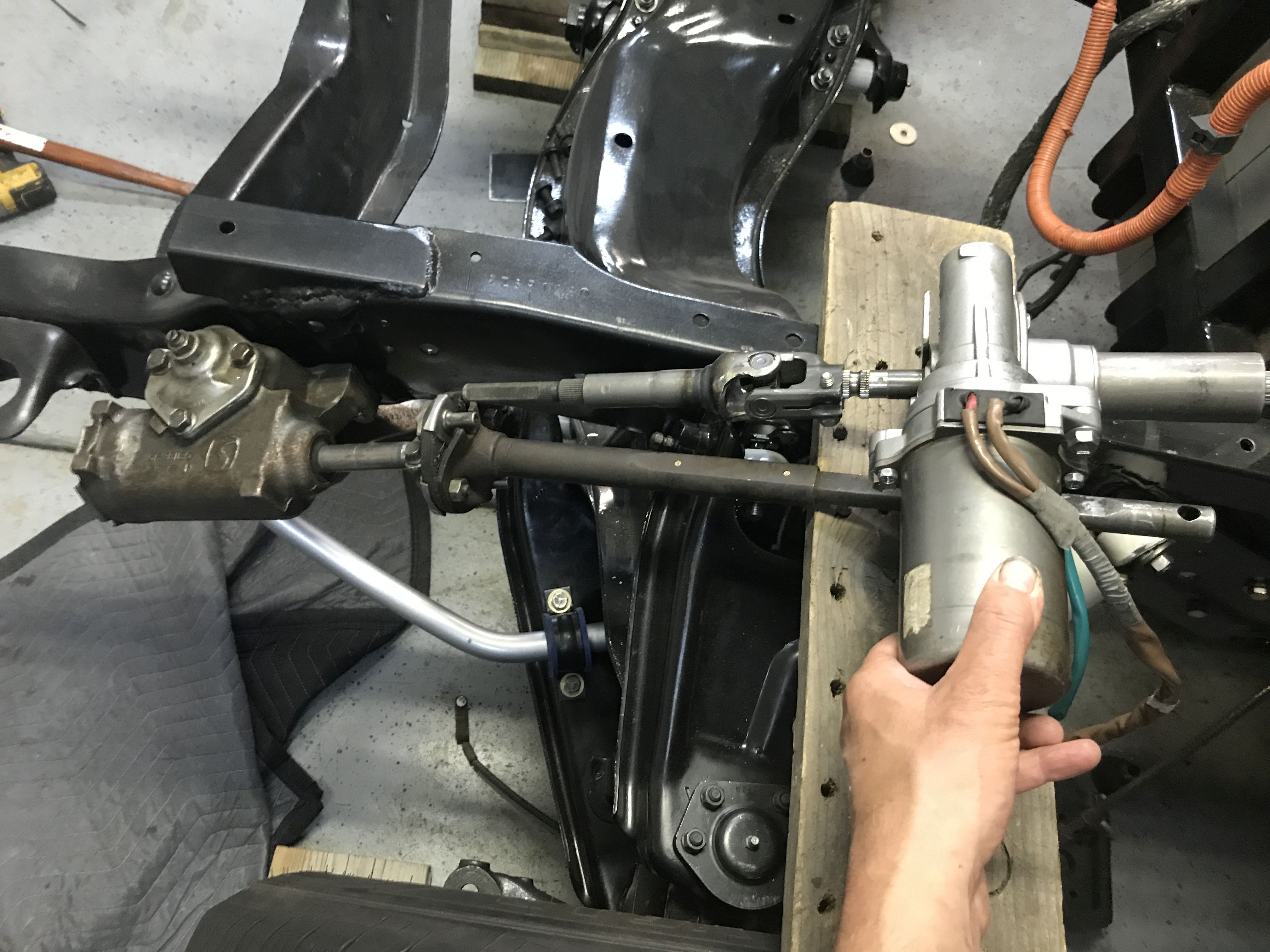

- Gregski
- Posts: 3161
here we are re clocking the Prius gizmo
