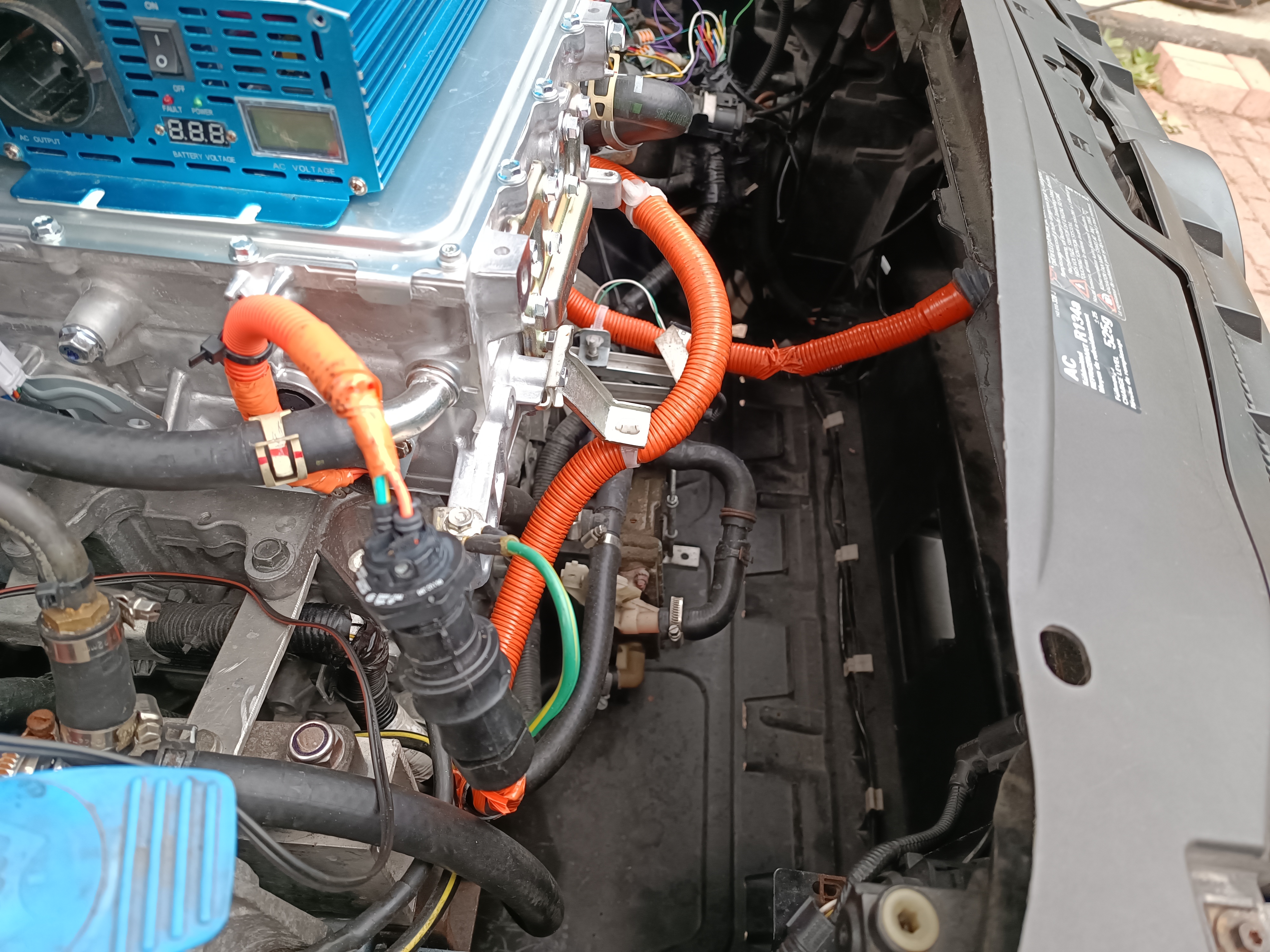

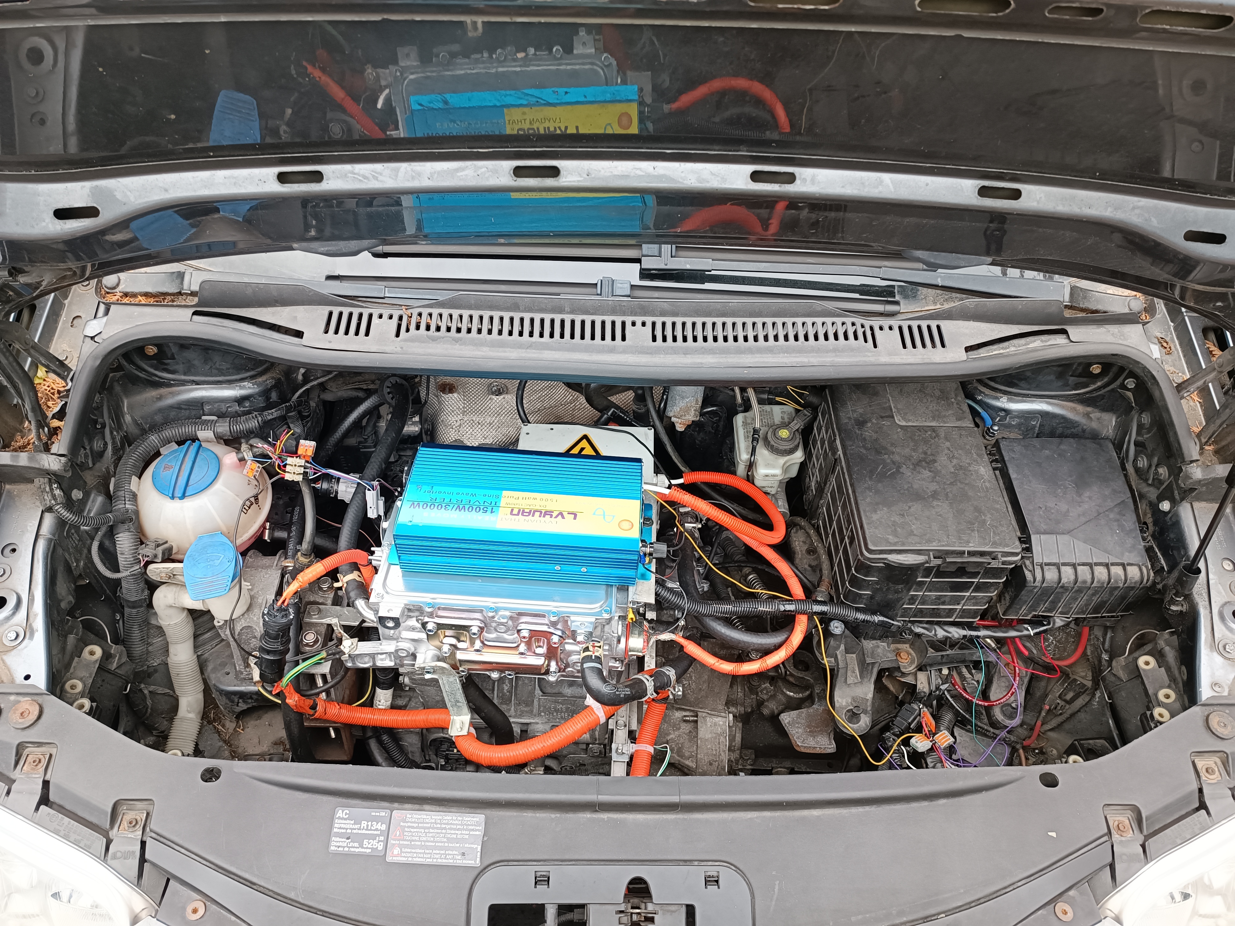

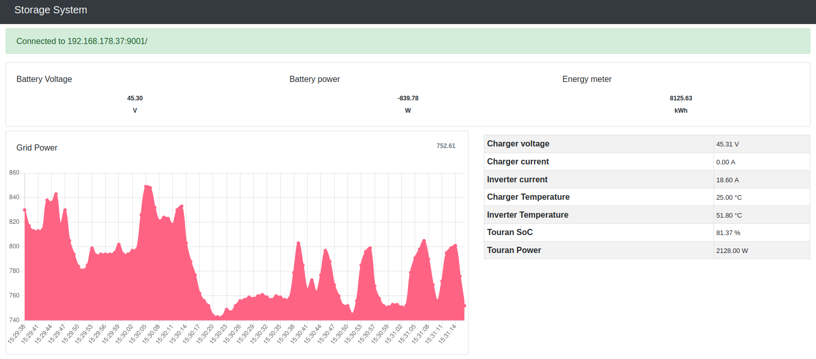

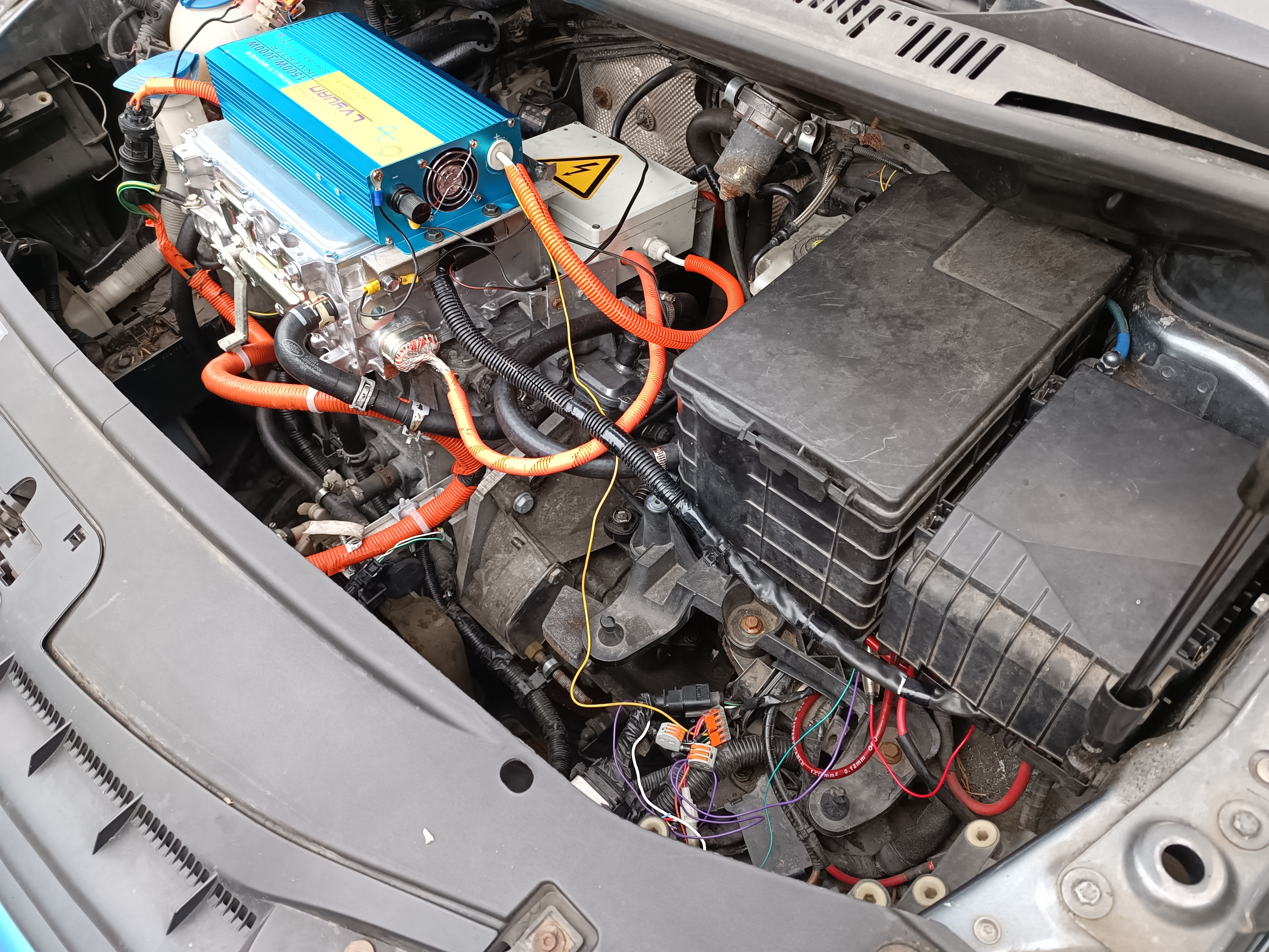

The the charger is in and charging, just one last (any annoying) connection missing, more on that later.
So first of all it turned out that the charger does NOT fit into the exhaust tunnel
So now I did it the more traditional way, connected it to the DC junction box, rewired the contactors so they can be powered with the ignition off and programmed the VCU to do precharging and contactor closing in charge mode.
Next I'm facing the good old "powering up stuff you need for charging"
1. pump, DC/DC converter, VCU, contactors, BMS => powered while driving (D), quick charging (Q) and AC charging (A)
2. VCU charge signal => powered in Q, A
3. inverter => powered in D
I went the Arber way and am using PP signal to pull down a P-mosfet gate that powers all the components in 1 and 2. Its output first goes to (2) and then via a diode to (1) because otherwise the charge signal would be active in drive also! Another diode brings ignition power to (1) to power them in drive mode. Quite a lot of complexity added there.
I used free cables in the Nissan harness to run signals from left to right.
The DC/DC converter, as predicted charges the battery to 14.5V which is too much for LFP. I connected the sense line straight to the output stud, so maybe while driving I'll get away with it. But I think while charging I'll toggle the DC/DC converter off and on depending on drawn current or something.
Also wired up the new signals in the VCU and found that the Olimex wifi module sits nice and tight on the unused engine harness connector
So routed all signals there, covered it with some shrink tube and now have a much stronger wifi signal.
Oh, why did I highlight BMS above? Because I forgot about it. It currently does not power up when the charge plug is inserted. I'll have to get to the junction below the rear seats to fix that. So right now: ignition on, plug in charge cable, ignition off.

Check my CAN code for aux voltage sensing. I use DCDC while charging but it is shutoff untill i sense 12.6V then it starts for 5 minutes. It is enough for keeping aux battery alive and not too much to cook it.
As for PP sensing i tried with Pmos but in the end i went with relay. So PP shows GND to small relay which turns on 12V power for other stuff. PP connection is quite enough for that.
Also i use that signal to pull my notaus signal and disable the car.

Hm, the charger does not fit in the exaust tunnel but it's HV output can still be permanently connected behind the contactors, or can't it? Even if that means extending HV cable? Just wondering if the charger is permanently connected and it's caps are always filled with voltage does that affect longevity of them?johu wrote: ↑Sat Sep 03, 2022 4:30 pm So first of all it turned out that the charger does NOT fit into the exhaust tunnelSo now I did it the more traditional way, connected it to the DC junction box, rewired the contactors so they can be powered with the ignition off and programmed the VCU to do precharging and contactor closing in charge mode.
- Posts: 3660
- Has thanked: 145 times
- Been thanked: 368 times
Hm.. i would need to inspect my wiring, but i think pin4 is the sense and pin7 is actual enable for DCDC. Also i figured if i connect charger supply pin8 together with DCDC sense pin aux voltage is less. Can you test? If true we have to correct wiki.
- Posts: 3660
I have it permanently connected via 20A fuse in my Mazda. No issues to date. Either from charger or dcdc.m.art.y wrote: ↑Sat Sep 03, 2022 7:14 pm Hm, the charger does not fit in the exaust tunnel but it's HV output can still be permanently connected behind the contactors, or can't it? Even if that means extending HV cable? Just wondering if the charger is permanently connected and it's caps are always filled with voltage does that affect longevity of them?![]()
Edit: i think charger, heter and inverter are made to be independently connected...

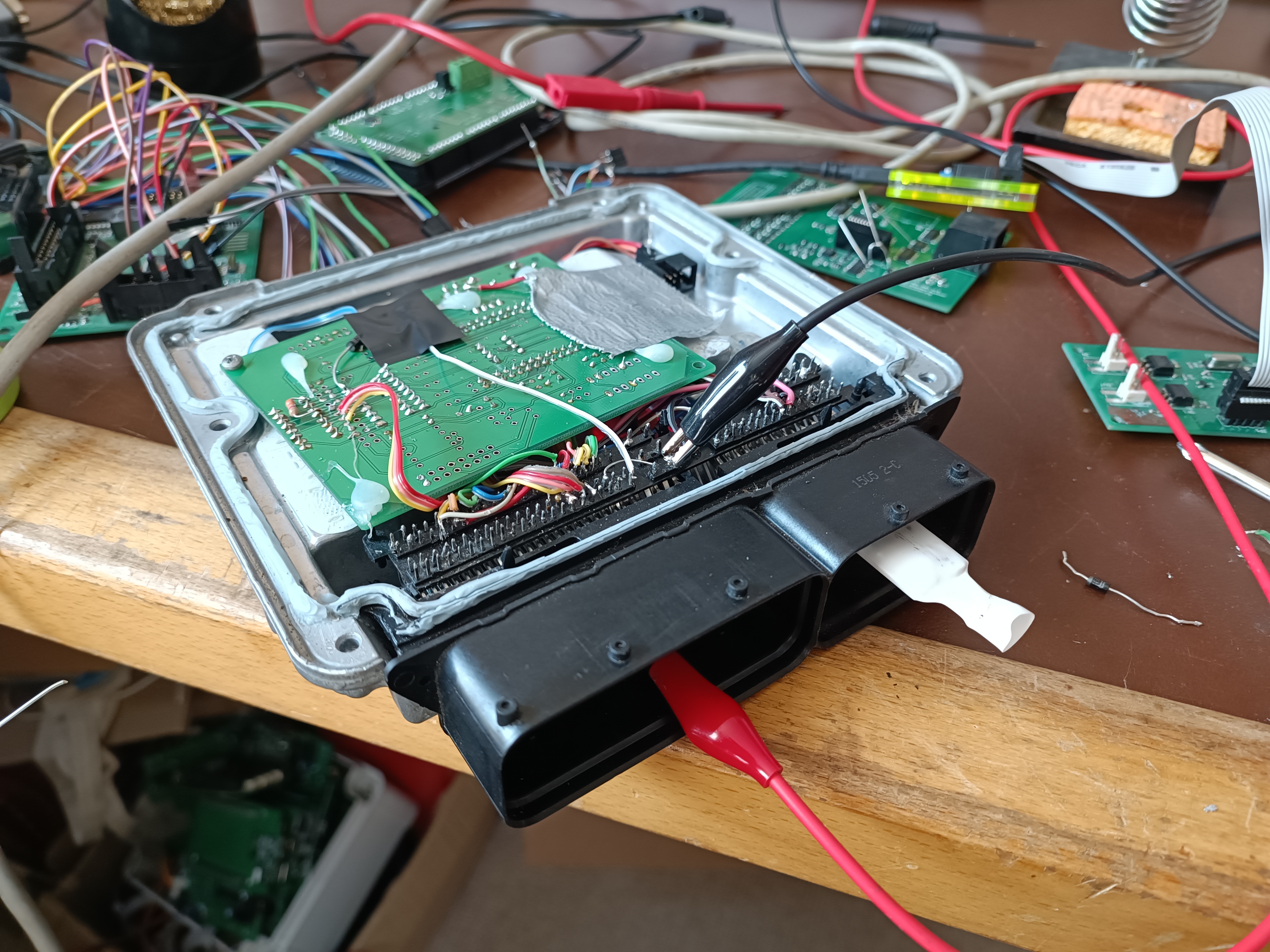

Remember when I said that I had colliding CAN messages between the car and the new charger? And I said it didn't matter.
Well, today my wife took off to work and returned 5 minutes later "the car brakes much too hard!". Regen braking that is.
At first I suspected she had been driving in 1st gear or something. I drove around a bit only to find out when I came off throttle the car would continue driving. Or brake really hard. Then I saw the green cruise control light on! So that colliding CAN message was actually the one from the cruise control switches. So then basically cruise control would randomly engage. Say it engaged at 10 km/h and you came off throttle at 50 km/h it would quite aggressively try to reach 10 again as I allow it quite a lot of regen.
So simply grabbing four bits from the CAN bus no longer works and VW wouldn't be VW if they hadn't done this properly, here is a round of CC messages:
So there are two counters in nibble 1 and 5, cruise buttons as a bit field in nibble 2 (the "1") and a different representation in nibble 0 (the "D"). So now I check for the counters and that both representations match. Fixed!
I also introduced the new CAN module that has floating point gains and allows specifying an offset. See here: https://github.com/jsphuebner/stm32-car

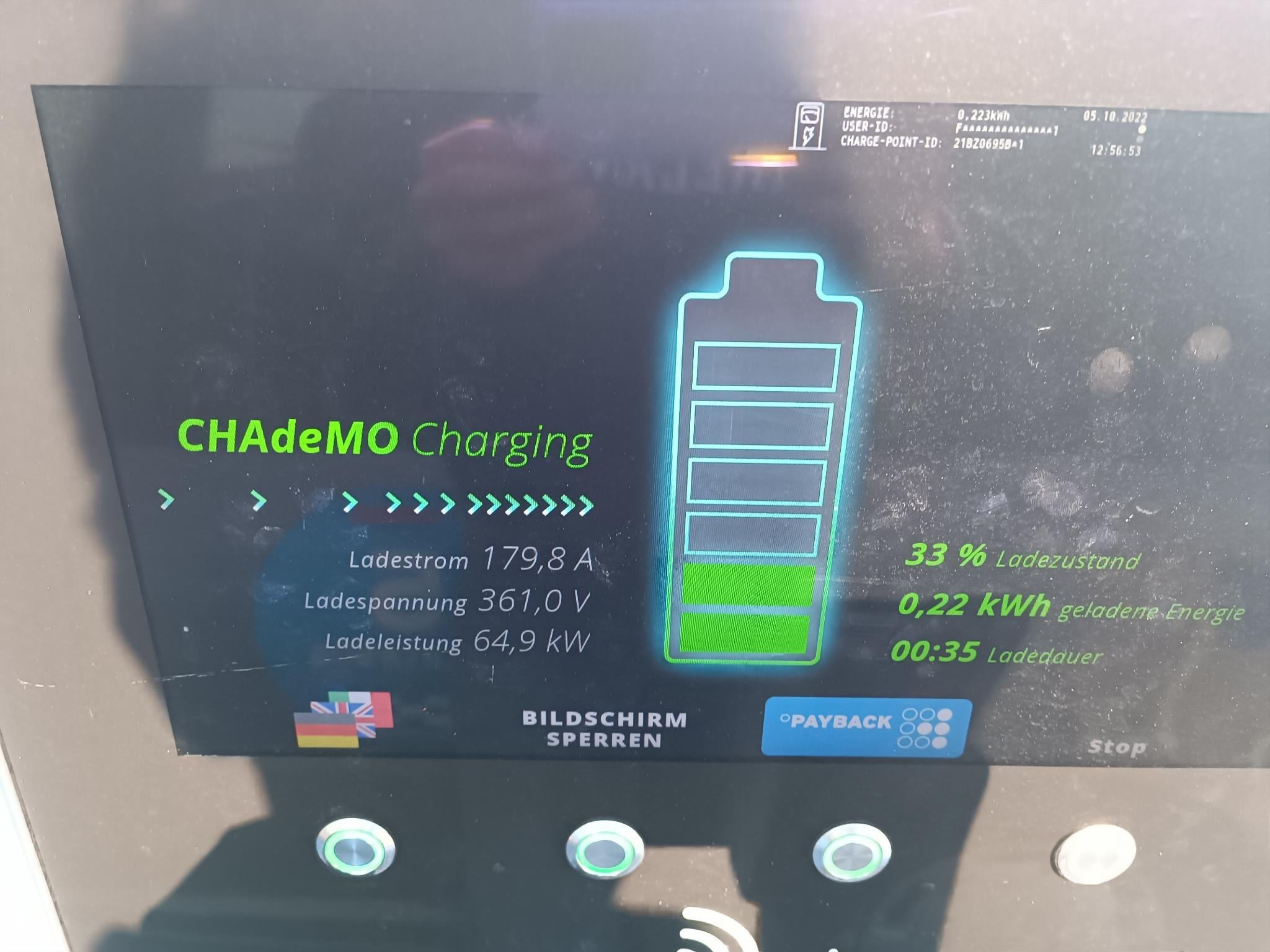

I'd consider myself back from holiday now even though I'm not quite home yet. Read below

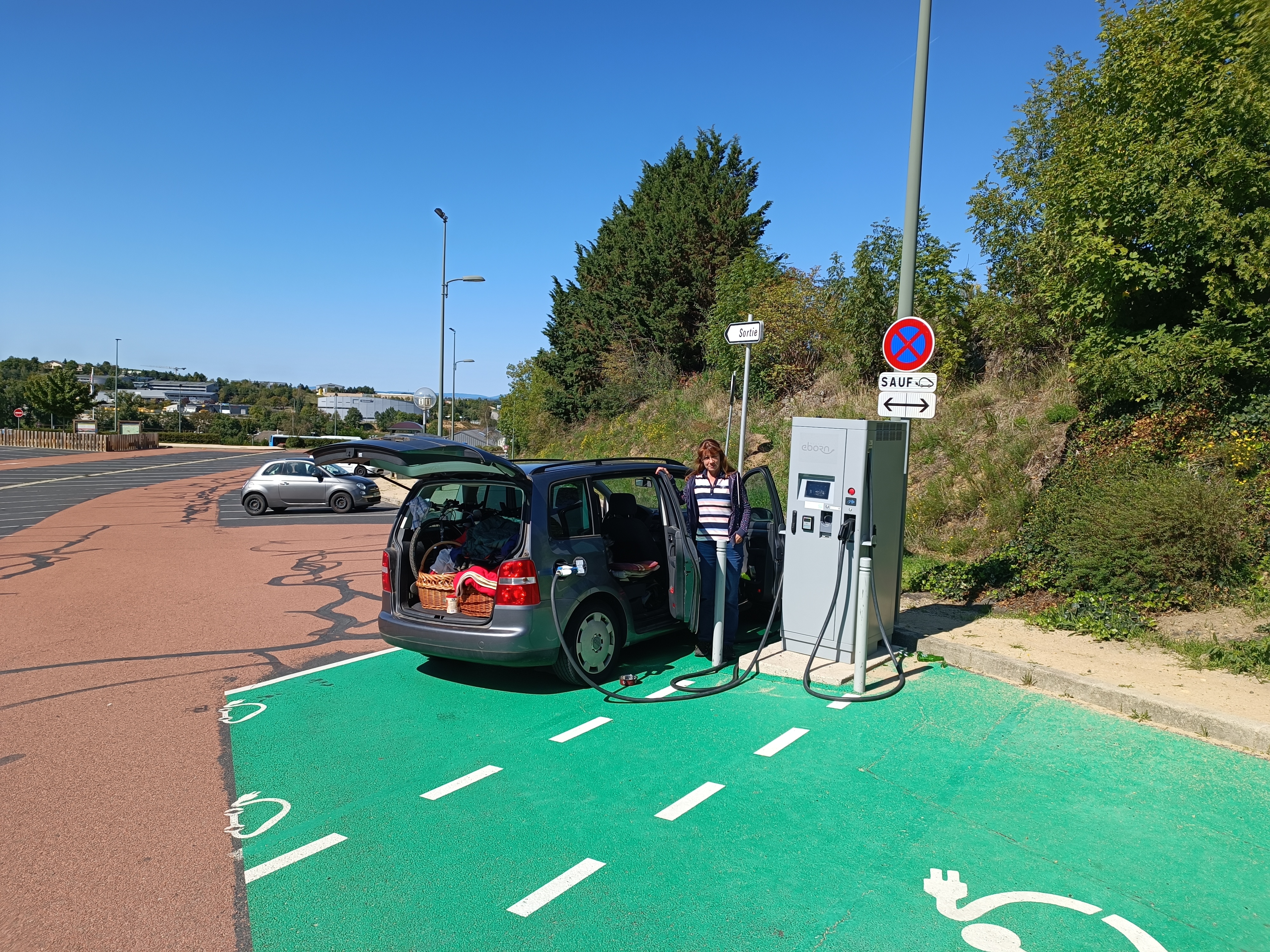

So, the latest 3000 km road trip to South France in all its glory.
We took off Monday 3 weeks ago and just did the quick drive to my dads place (360 km). The take off was already delayed. I noticed the DC-DC converter wasn't working. Checked all wiring and found nothing. Then I went for a short drive and saw the converter jump to live - it doesn't turn on above 400V and the fully charged battery is 403V. Strange enough that the charger charges that high. Anyway, quickly fixed after all.
On the first charge stop we walked the dog and had some lunch, after that the battery was back at 100%. We noticed some strange ringing sound from the rear. At the next charge stop we found the rear wheel scorching hot. I removed the wheel (while charging, of course) to find the metal sheet that apparently ducts the air to the disk was so rusty it had come off its mounts and was touching the disk. Also think it was pressing the hand brake lever which created all that heat. Checked the other side to see that the air duct was already removed there
We've got regen, who needs air ducts...
Stayed in the region till Saturday and took off Saturday afternoon towards Dijon, another 350 km. Had to wait on the first charger so I took out rich man's charger and set it to charge at 15 kW. Just as it started to overheat the DC charger became free. In Dijon I was looking forward to an AC charge site with 26 outlets. Only to find - nothing at all. So instead we let the extension cable hang out of our cheap hotel room and charged at 2 kW. Needless to say the car wasn't full on the next day. So we went to a nice "Aire" (French for service station) had breakfast there and charged. Next stop Lyon, charging while grocery shopping.
And finally Yssingeaux where we charged while having lunch.

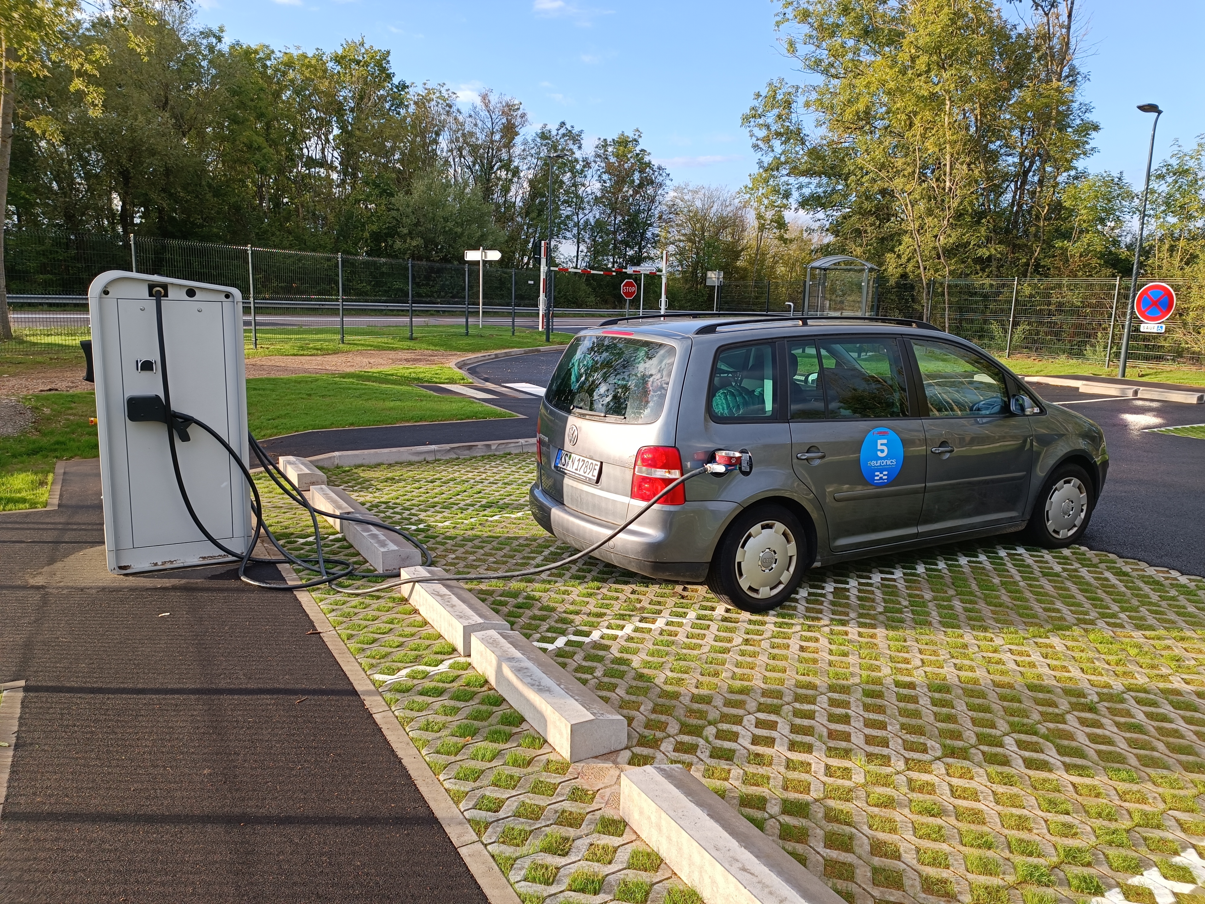

Then I noticed something strange. As usual the batteries are quite hot after that many charge stops but they weren't "derating hot". But suddenly while hill climbing long after the charge stop I got a 25 kW discharge limit. So what happens is that second battery brick is obscured by the first. So the first is cooled rather well by the air stream from the exhaust tunnel. After a while the first one will sit at 35°C while the other is still at 47°C (or so). Apparently the BMS thinks that is worrying and kicks in that ridiculous limit. So I implemented an override that removes any discharge limit and kind of mimics Nissans charge curve while charging (50 kW to 60%, dropping off to 25 kW at 80%) as long as the highest temperature is below 56°C.
During our two week stay we were allowed to charge at our hosts garage. It takes a whopping 17 hours to charge from near empty to full. Driving electric in hilly terrain is super satisfying, even when descending serpentine turns you can get away without using the friction brakes. Consumption could be as low as 120 Wh/km due to the low average speed. On our last trip I was rather nervous when we arrived 30 km away from home with just 15% left - but on top of a mountain! So in the end we arrived home with 13% - due to charging back up to 20% on the hill descent.
Then came the day of return. We covered 500 km without any issues, only had to activate my BMS override at and after the last charge stop. Only thing that did come up was a humming noise from one of the front wheels. Oh well.
Next day there was just 300 km to cover, one charge stop in Nancy and back to my dads place. Sounds easy, right? Well it wasn't. For the first time it was raining heavily which may have been part of the problem. The first charger, a Veefil, reported communication error 122. There were two more chargers just 200m away. They also faulted out within a second of connecting to the car. So I broke out rich man's again and charged at 12 kW for a while until it overheated. At least we had reached 50% by then. Rich man's uses the CHAdeMO port as well, so why was it working but not the regular chargers? Before me a Nissan Leaf had charged successfully. I never found out but we did decide to leave and retry our luck at Metz. To my surprise it was now working again.
While charging I lifted up the front wheels to find the right one very wobbly. The wheel bearing is not in good nick
So now I'm here at my dad and decided to not drive back to Kassel on a wobbly bearing.
So over all I was quite happy with how it went but that last day ruined it a bit and it's what my spouse will tell people when they ask about the trip I'm afraid
EDIT: the stats
Total km driven 2457, total kWh charged 382 -> 155 Wh/km
DC kWh 212 at 109€ -> 0.51 €/kWh
AC kWh 170 at 42€ -> 0,27 €/kWh
So roughly 6€/100 km
The days of free charging are over. Even our hosts asked us to pay for electricity. Still I'm very happy with over all cost and consumption figures.

I really think it's about time to get rid of the CHAdeMo Port and install a CCS Port
m.art.y
- Posts: 672
- Location: UK/EU
- Has thanked: 37 times
- Been thanked: 36 times
This is kind of a known problem with Leafs, moisture gets into the sense pins at the back of the Chademo port, it usually starts working again when moisture is cleaned off the contacts, perhaps some sealant would help or other method to prevent water from getting in.johu wrote: ↑Sat Oct 01, 2022 5:29 pm Well it wasn't. For the first time it was raining heavily which may have been part of the problem. The first charger, a Veefil, reported communication error 122. There were two more chargers just 200m away. They also faulted out within a second of connecting to the car. So I broke out rich man's again and charged at 12 kW for a while until it overheated. At least we had reached 50% by then. Rich man's uses the CHAdeMO port as well, so why was it working but not the regular chargers? Before me a Nissan Leaf had charged successfully. I never found out but we did decide to leave and retry our luck at Metz. To my surprise it was now working again.
Regarding slow Type2 charging, it can be made faster if more than 10A is allowed but the wall socket has to be able to handle it.

I am now back in Kassel, no further incidents but a very nice and quick CHAdeMO session
