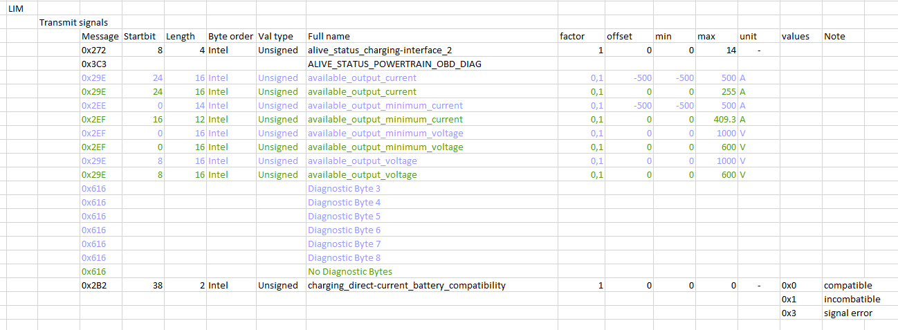

I think I'll let the CCS unit handle the CP and PP. I just need a charger interlock signal for my Orion BMS, so as soon as a plug is detected i need a bit turn from 0 to 1 or similar.
0x272 CCS contactor state and charge flap open/close status
0x337 Inlet lock status
Can someone tell me where i can see in detail which exact message i could use?

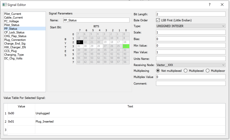

I'd look at CAN message 0x3B4 from the LIM and within that at the PP_Status.
0x01 for plug inserted

Post by Zapatero »
Wow, that was quick :)
So this will be 0x00 when no plug is inserted and 0x01 if Type2 or CCS plug is inserted, even if no charging occurs.
Just want to prevent ripping that cable out of the station :x

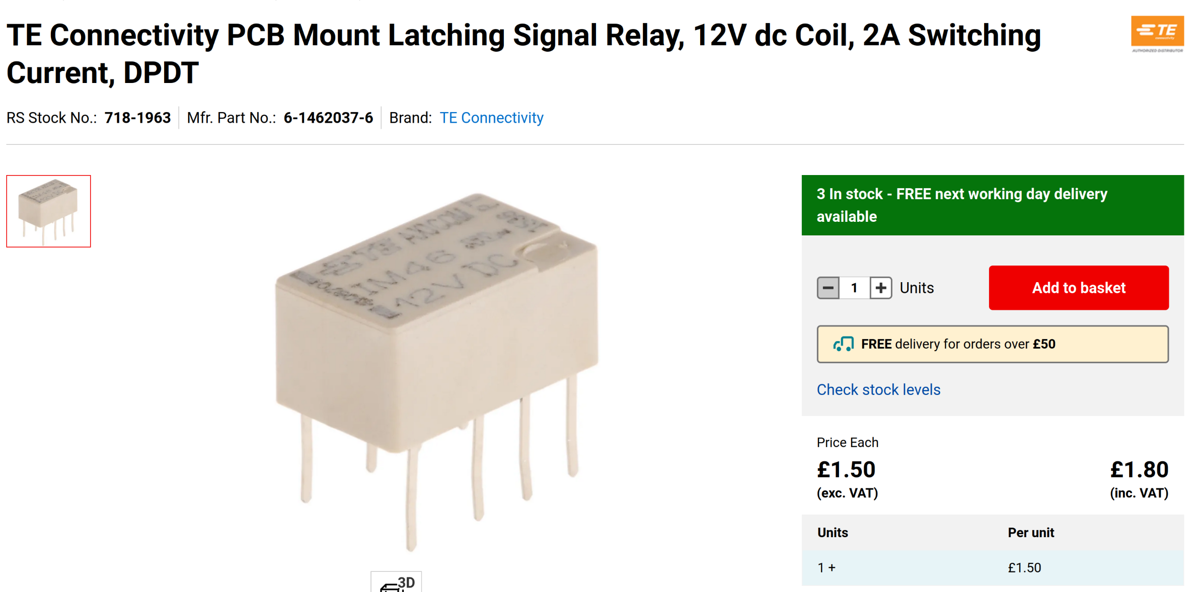

Zapatero wrote: Sun Nov 27, 2022 6:21 am If I decide to switch CC and CP signal with a relay, what would be the indicator for the relay to know if it's open or closed. Which signal can i use to recognize if a Type2 or CCS plug is plugged in?
I hadn't given this a lot of thought. My situation is that I have an old "OEM" EV that has no DCFC, and I'm adding it. I'm thinking that I'll use a bistable relay ("latching" relay) and a SPDP switch. The relay will remain in whatever position it is set, without drawing power.
https://uk.rs-online.com/web/p/signal-relays/7181963
For the relatively infrequent times I need to DCFC, I will flip that switch to "CCS", disconnecting CP & PP from the OEM onboard charger and connecting them to the BMW i3 LIM. I don't think that I need to automate beyond that . . . but if I could cover all the situations with automation, that would be more clever.
[Hmmm. With the CP/PP connected to my OBC, my EV has drive-away protection. With them connected to the LIM . . . perhaps not. I have not thought his through.]
I do like the idea of code querying the LIM to determine if we're plugged in, then further using code to decide that AC is present, then switching the CP & PP to the AC onboard charger, but I can see some difficulties that make using a hardware solution (switch + bistable relay) attractive.
For example, once the LIM has told you that you're plugged in and there's AC present, you take the CP/PP lines away from the LIM and give it to your OBC, and tell the OBC/BMS to do its thing and initiate charging. How/when do you return the CP/PP to the LIM? When the nozzle's unplugged? When the BMS cuts the OBC? I'm foggy on the multiple scenarios that could occur.
Al Savage

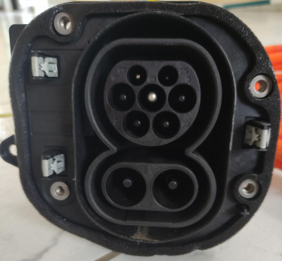

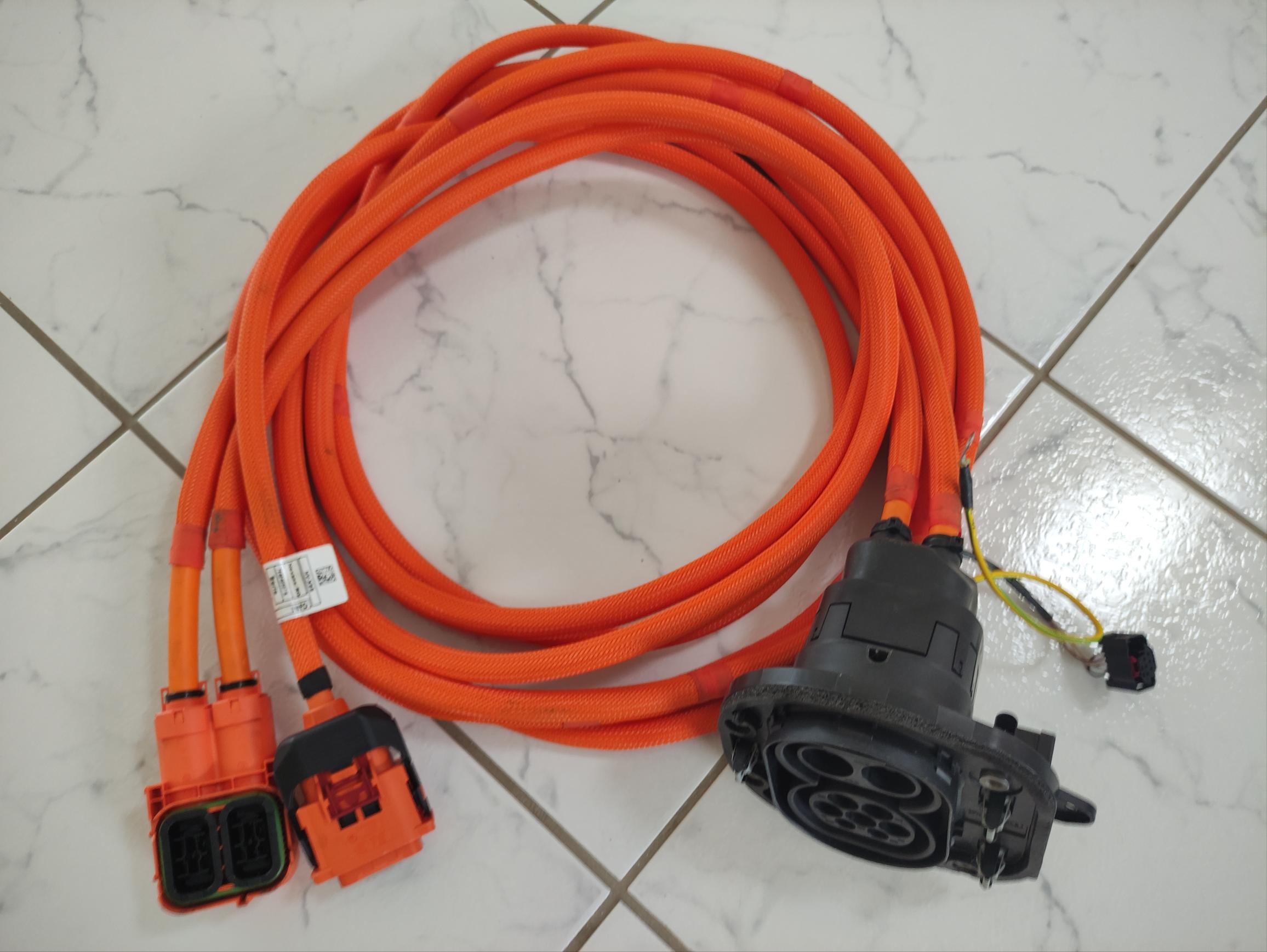

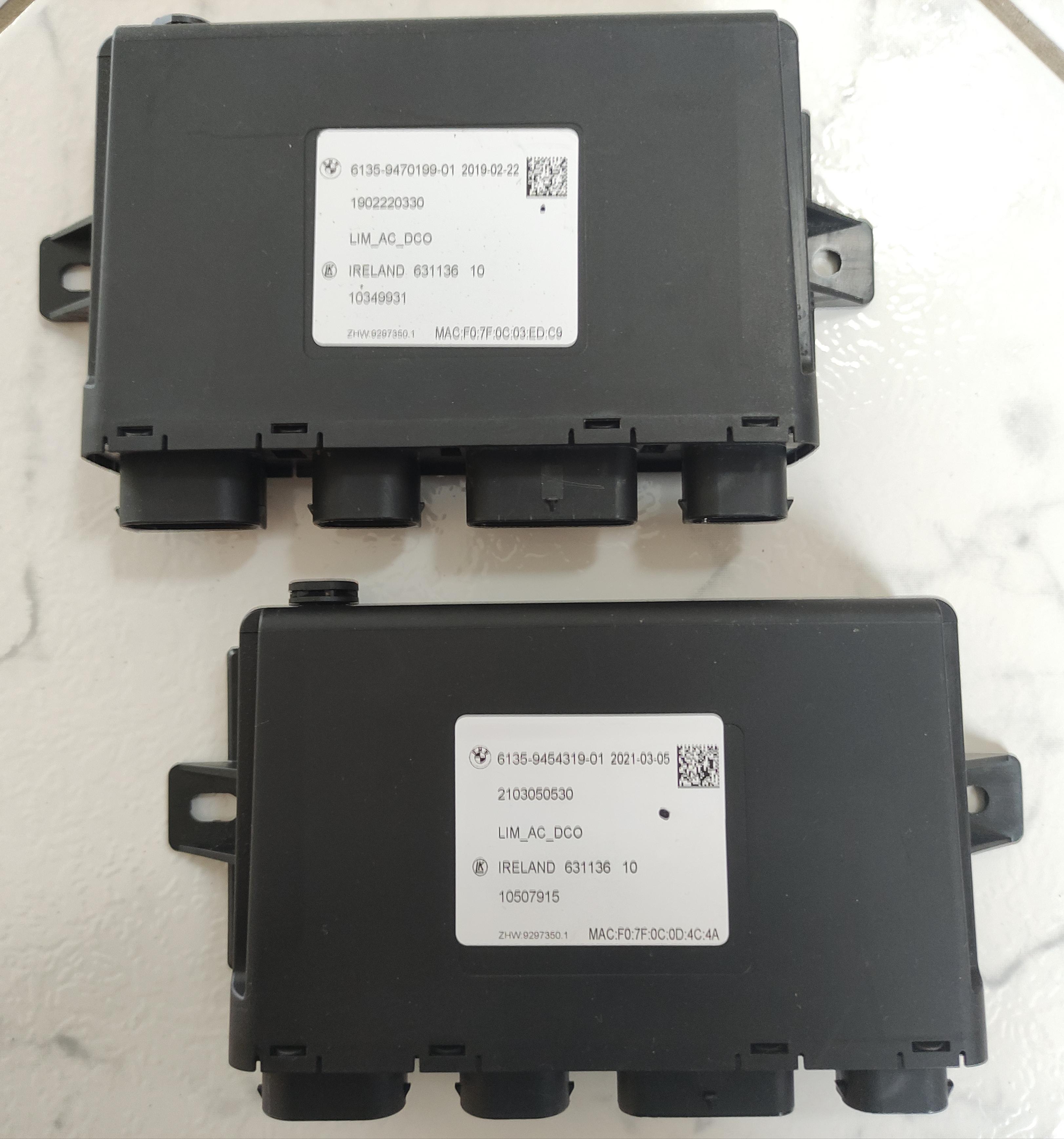

Hi Guys, I am pleased to share with you the hardware I received:
Two ISO15118 compatible LIMs, one CCS2 socket from a BMW MINI-E, and some of the needed connectors.
My project would be to get it working at first with Mitsubishi Outlander BMS slaves (80S1P) and SimpBMS or EVS-BMS, then go to 220S1P for a 920V setup and finally ramp up to 220S2P, 220S3P, 220S4P for a 460KW CSS capable trailer mounted ESS.
The pros of using a Combo socket from a BMW MINI-E is definately LIM compatibiliy but also cable length !
Jeff - FRANCE & GERMANY

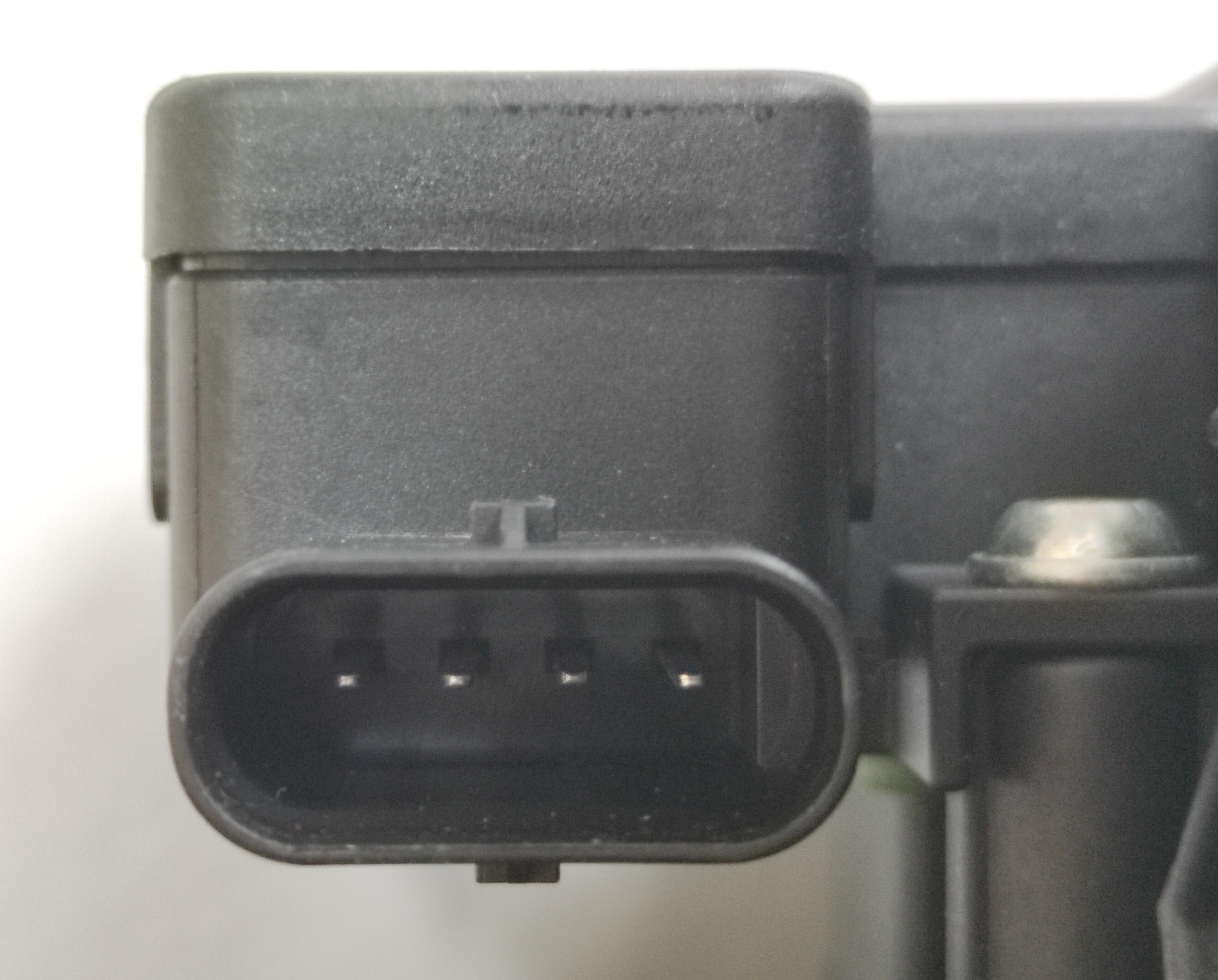

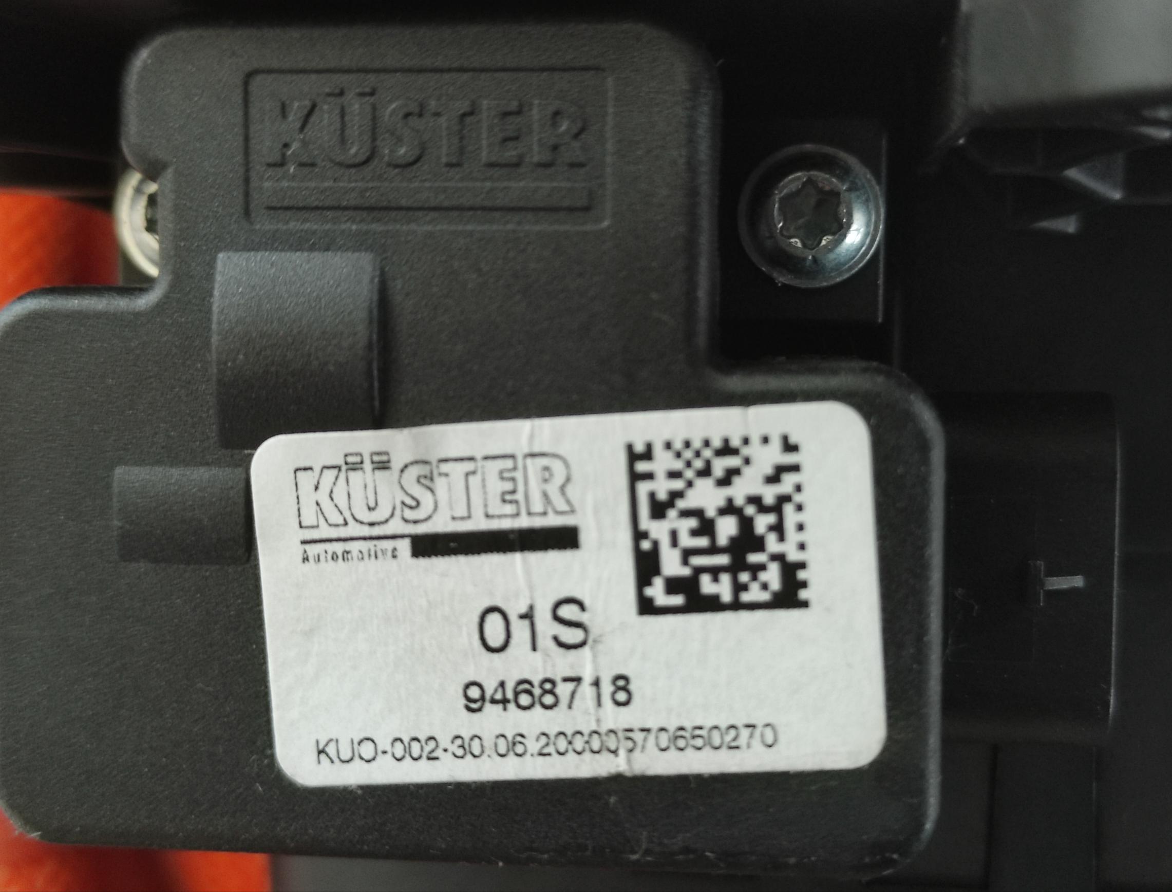

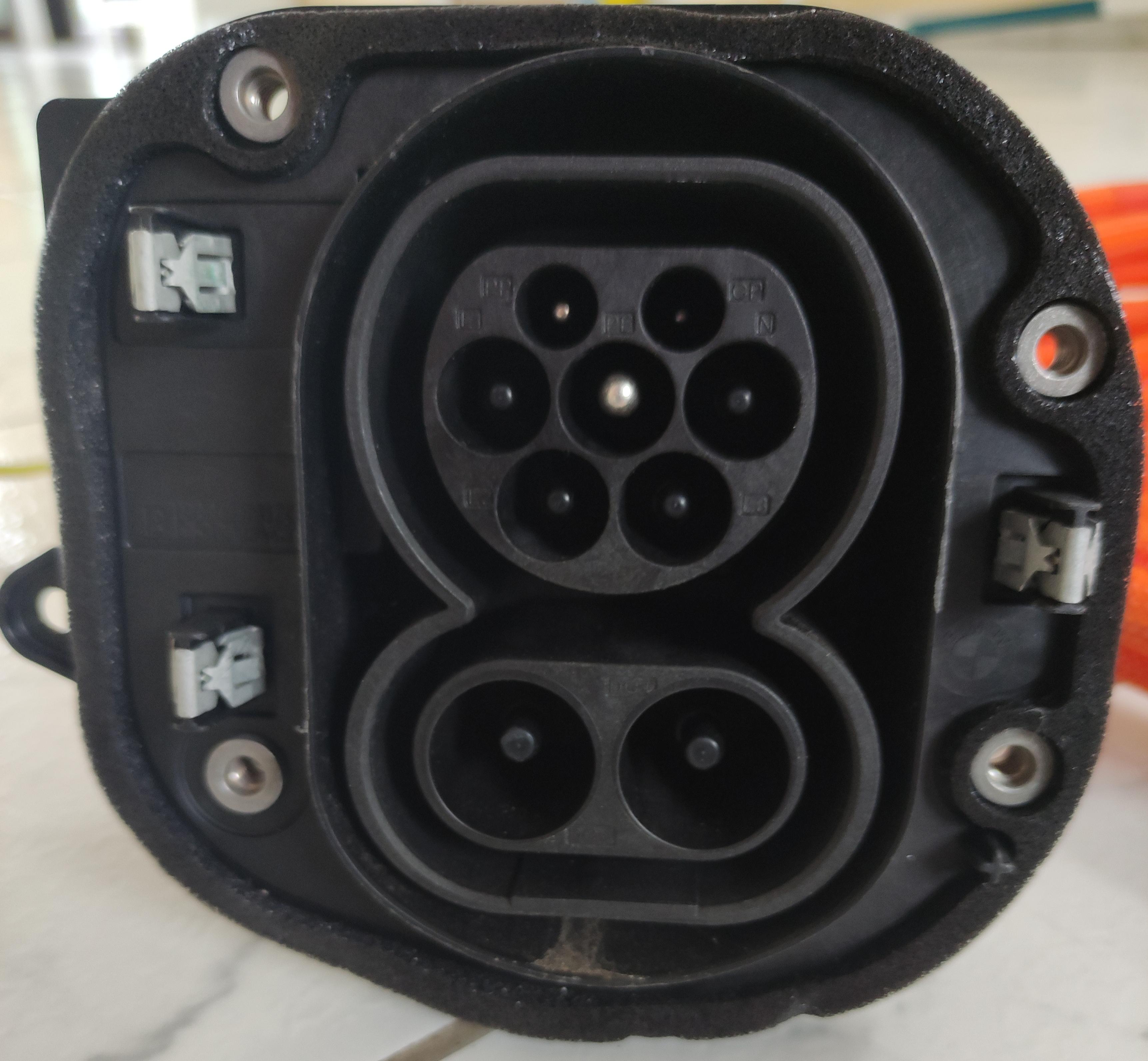

Here some details on the Mini-e charging socket:
the Charge port lock is mounted on the side making the whole thing quite compact.
Same Kuster Lock as on the i3, and I guess same connector for Inlet temperature... ;)

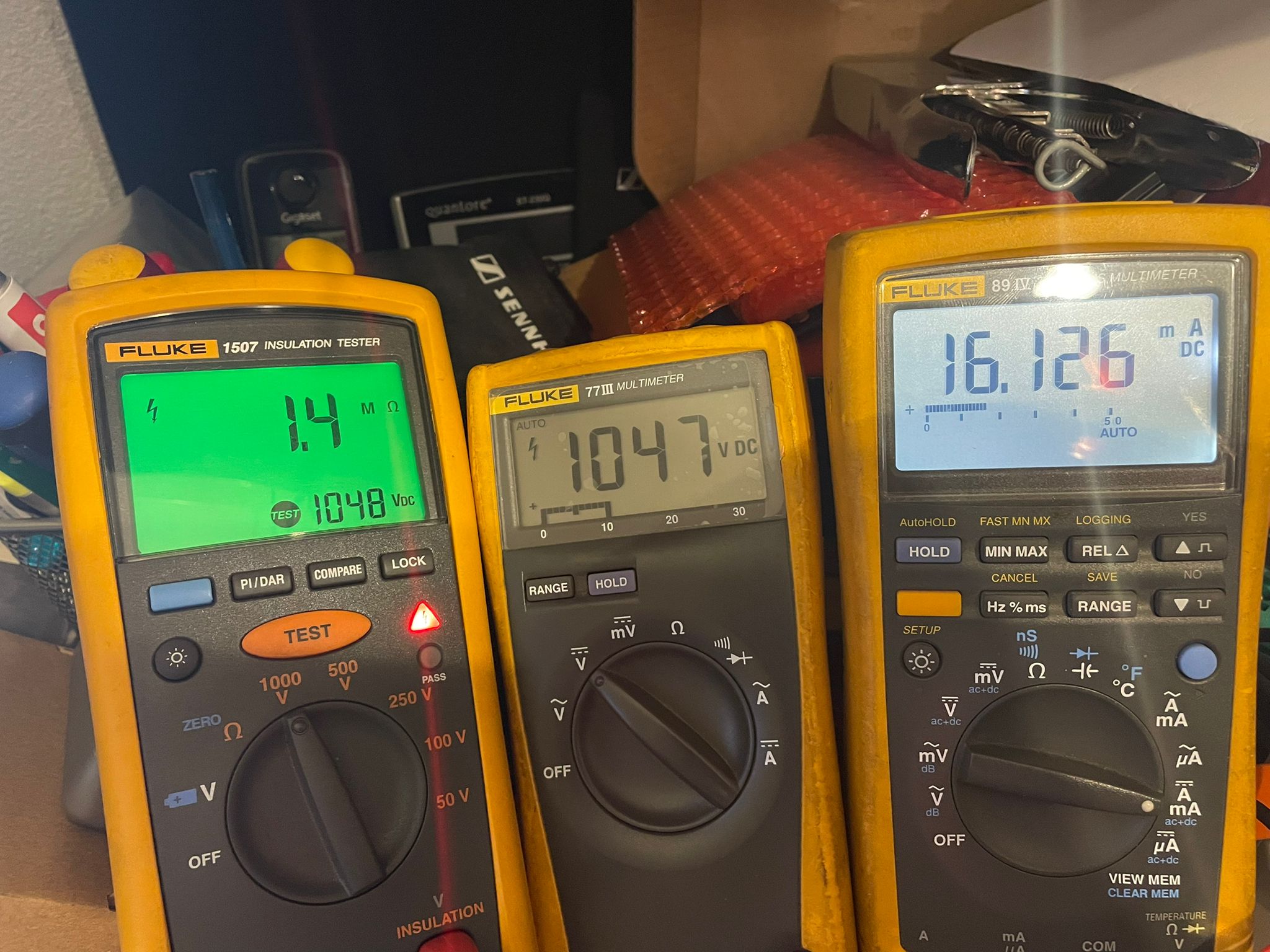

tom91 wrote: Wed Nov 30, 2022 3:06 pm The higher voltages however, due to the way the DC fast charge bus sensing works feels like this will be the hurdle.
The measuring range of the Voltage sense board is determined by two factors:
1) the supply voltage
2) the input range of the current sensing basic isolated amplifier
Factor one should be good with our board since our supply voltage is 12V which exceeds the minimum of about 7,6V to produce the 16mA current around 1000V.
However factor two is going to be tight as well as isolation barriers / voltage ratings of components used.
For testing we went up to 1047V and did get 16 mA but it might not be accurate and is not recommended.
In the end it was a kit intended to use as a replacement of what the KLE does (and thus work in a 96s setting).
But you can of course (re)design a voltage sense board solving the remaining challenges.

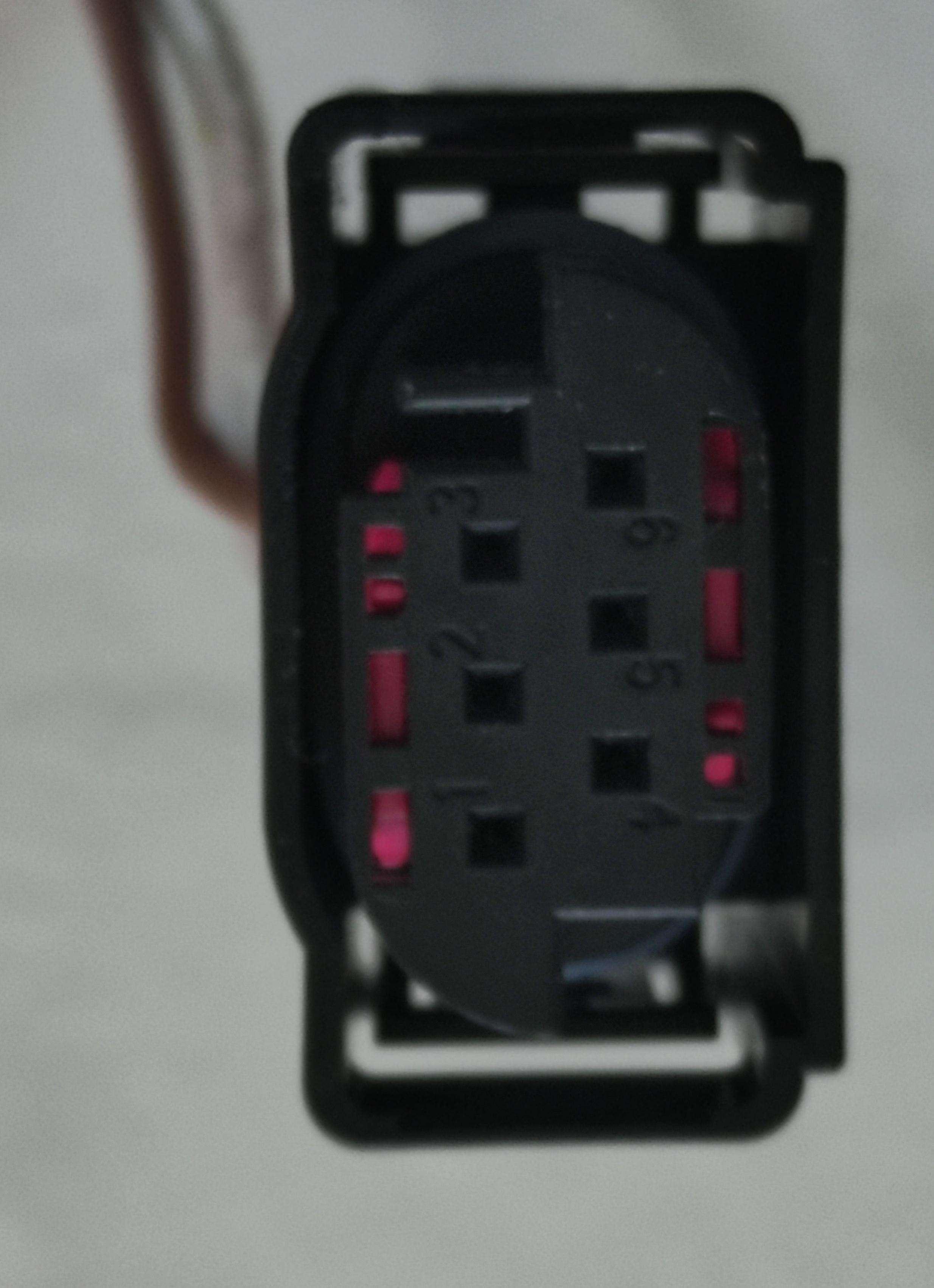

Talking about the Wiki, who is reponsible for updates ?
The advertised connector terminals for the Chargeport lock are wrong, it's not MQS but MCON 1.2 (1.2 SealStar MA Connector series from Hirschmann)
below more details about the original connector for the Chargeport lock from KRÜGER:
Hirschmann part number:
male 805-122-541 (4 way connector)
female 872-617-541 (4 way connector)
BMW part number:
male 12527549033
female 18302411427
using the Hirschmann ref will also help you to find really cheap connectors sets with terminals and seals ;)
