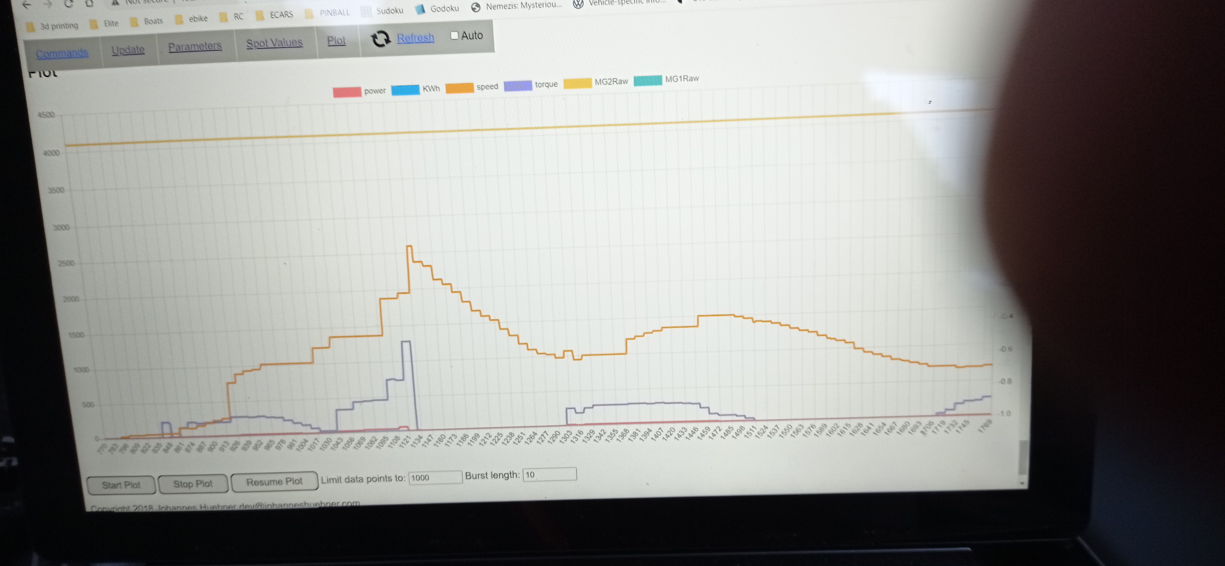

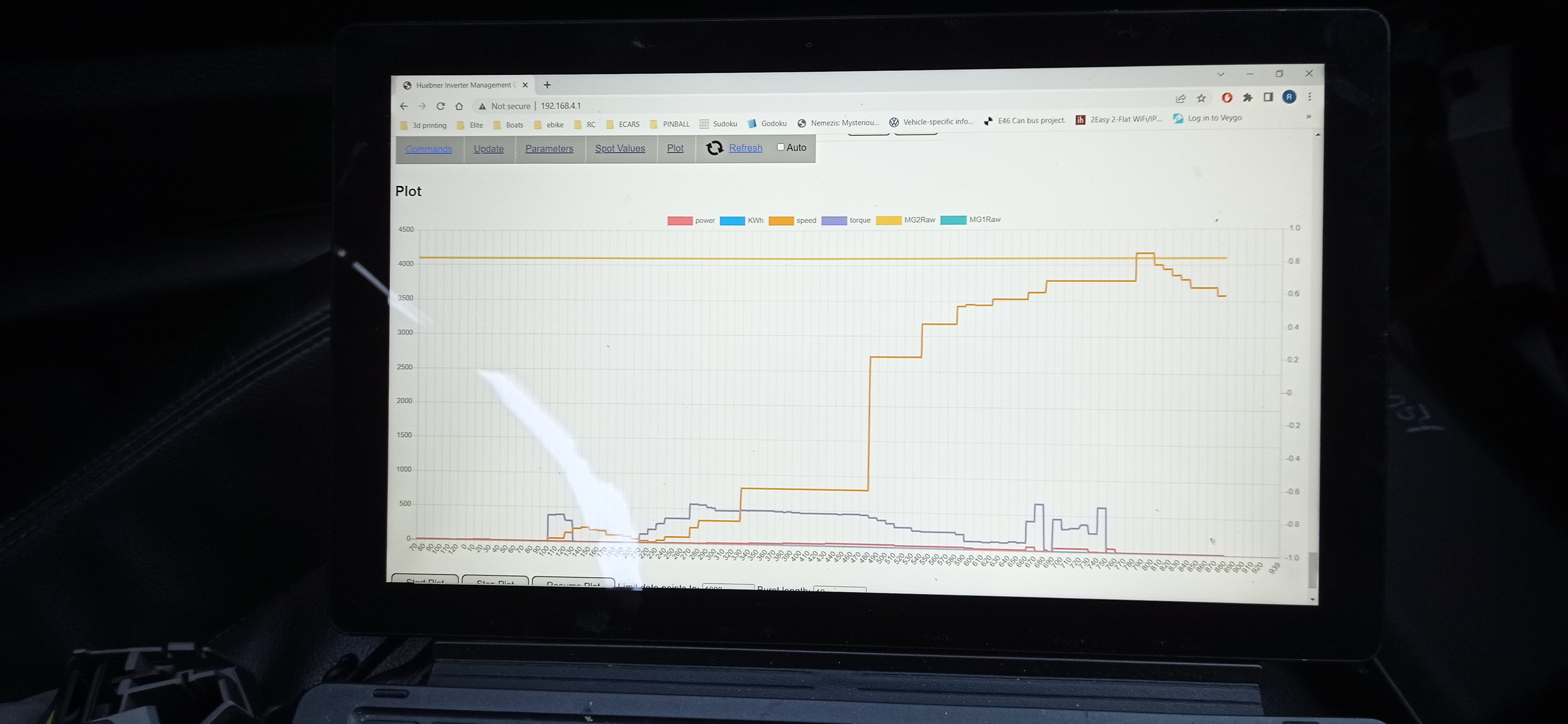

I have been chasing this problem for a while now.
Firmware version 1.10a Zombieverter
I have enclosed my parameter settings and 2 pictures of plots with differing speeds and throttle activation.
My observations are,
Even though MG1 and MG2 data are selected on the graph I can't see a plot for MG1 (top of graph).
The power plot (very low curve at bottom of graph, red) seems to show a jump then a flat line then a drop off before the Torque drops to zero.
Any thoughts or observations would be greatly appreciated.

Re: GS450h Cuts Out on Heavy Throttle Application
Maybe transciever is deaf? See if your can/control wires are twisted in the same direction.

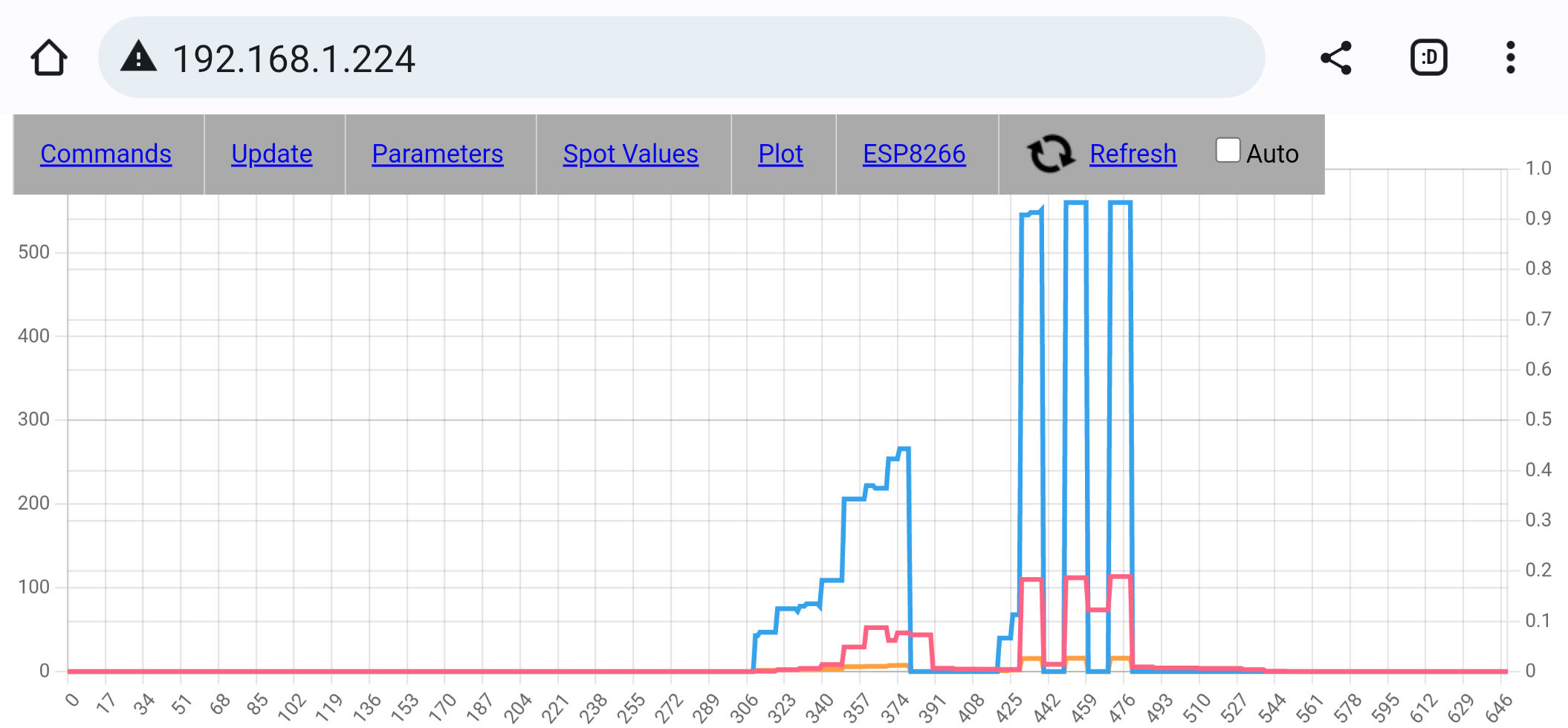

Re-continuing problem,
The plot included shows, Torque (Blue), Power (red) and Potnom (Orange).
I think this problem is related to the power of my battery pack, 52Kwh. You can see that the system is cutting in and out because of a limit.
Could the reason be that Damien is not seeing this issue is because his pack is 22Kwh and so he is not reaching the set limit?
I can only stop the cutting out by reducing my throtmax to 16% or below which makes it drive like a snail.
So it looks like something's pulling potnom to zero, and the inverter is reacting to that? Any errors stored?
Checked the connections on your throttle sensor? A loose +5V connection, for example, could have the pot output drop to zero intermittently.
How's your throttle pot signal getting to Zombieverter? (Direct analogue connection, or over CAN? Scoping the analogue, or logging CAN messages may 'prove' that the Zombieverter input is good/not good)
The 'speed' readout in your first images looks strange. Some large intervals between updates? Noise/grounding issues? Or is your inverter cutting out and resetting?
If your throttle signal is getting to Zombieverter cleanly, then yes, I suspect you're hitting a limit somewhere. I think it can derate based on inverter temperatures, HV voltage, HV and/or AC current, and your BMS may ask it to derate. All of those require parameters to be set.
Your udc, idc, temp parameters look sensible (what is your minimum and maximum pack voltage?) Check your udcsw value.
Have you (re)set the throttle parameters (potmin potmax throtmin throtmax throtdead) since the recent-ish change to their usage?
Have you plotted/logged udc, idc, temperatures during these cutouts? If udc goes out of range/currents get too high/temperatures get too high, it'll derate quite hard.
Worth running through https://openinverter.org/wiki/ZombieVer ... nd_testing again, just to make sure.

Re: GS450h Cuts Out on Heavy Throttle Application SOLVED
This problem was definately due to a hard cut off by the VCU. This may be a design point to stop the transmission being over powered. Unfortunately rather than tapering the power off there is a hard cut. This causes a massive shock through the transmission and could do more harm than good.
Having finally managed to get a compiled version of 1.10A with the line in util.cpp,
Throttle::IdcLimitCommand(finalSpnt, Param::Get(Param::idc));
edited out (//) I have a driveable car.

I also refer to your post of Sun Dec 11, 2022 10:18 am
"I would encourage you to consider that as a 'workaround' at best, that function is supposed to protect against a number of possible problems. There's either a bug in the code, or a problem with your setup."
To which I replied on Wed Dec 14, 2022 2:18 pm
part of the reply was,
"Removing the line of code is, at best, a work around. My concern is that any total cut of torque in the drive line and its sudden return will not only rip gearbox mountings out but also put massive strain on the transmission.
I understand the need to control power for various reasons i.e. over reving, excessive torque, overloading batteries and inverters but surely a gradual cut is needed in all cases. A bit like when you over rev an I.C.E. engine the drop is slight and if you keep your foot down all you get is another minor cut."
Why is it that you find my comments about coding and forums upsetting?
Do you have a car that you have spent a year working on with a Zombieverter ECU and a GS450h gearbox that is sitting on a drive with in excess of £10000 spent waiting to drive safely on the road apart from software issues? If you have then please advise me on how to proceed.

Im happy to test in the land yacht with zombie to confirm if there is an issue I haven't seen yet. Can you outline what the issue you are having specifically is and what you think causes it and I will test that scenario and get back to you.
- Posts: 211
- Has thanked: 2 times
- Been thanked: 13 times
Also bringing torque to 0 means adding 0 torque and freewheeling so a bit surprised that it broke something , sounds like a different issue.
- Posts: 211
Have a test of this , Damien has provided an update , my have be an issue with how current direction is signed.
https://github.com/damienmaguire/Stm32- ... /tag/1.11A
Let me know how you get on and I'll be updateing to test over the weekend

Hello all,
I have a gs450h zombie-verter and am experiencing the same violent cut in power.
I have just flashed zombie to V1.11A and sadly the fault is still there. Just thought id share that I am experiencing the same troubles.
I will try to resolve. If I get anywhere ill be sure to post on here.
Jack
Jack
UPDATE - I have just tested with removing the current limit from the code and it still unfortunately has the same issue.Jackk wrote: ↑Tue Feb 07, 2023 2:42 pm Hello all,
Jack
It only happens when I really boot it generally at higher RPM. it burns rubber just fine from standstill but there is less current needed to do this from what I understand so it does seem to happen at higher current levels.
Can anyone suggest what to do next?
One thing I'm reluctant to do is change my serial wiring (going to be a bit of a ball ache). The run of the wiring is relatively short id say less than 1m. They are twisted pairs but NOT shielded. Could non shielded serial wiring be the cause? My gut feeling is a code issue as others have experienced the same.
any suggestions would be great

I have set my car as per Damiens video with the 1.11 update and it has fixed my torque drop. My RPM was set at 6000 and
the rev limit was noticable but not violent. Other settings when I drove the car were, as far as I can recall, throtmax 50% and throtramp set at 1.
I have not tried the car with any settings changed as yet.
Hope that helps
Hope that helps
