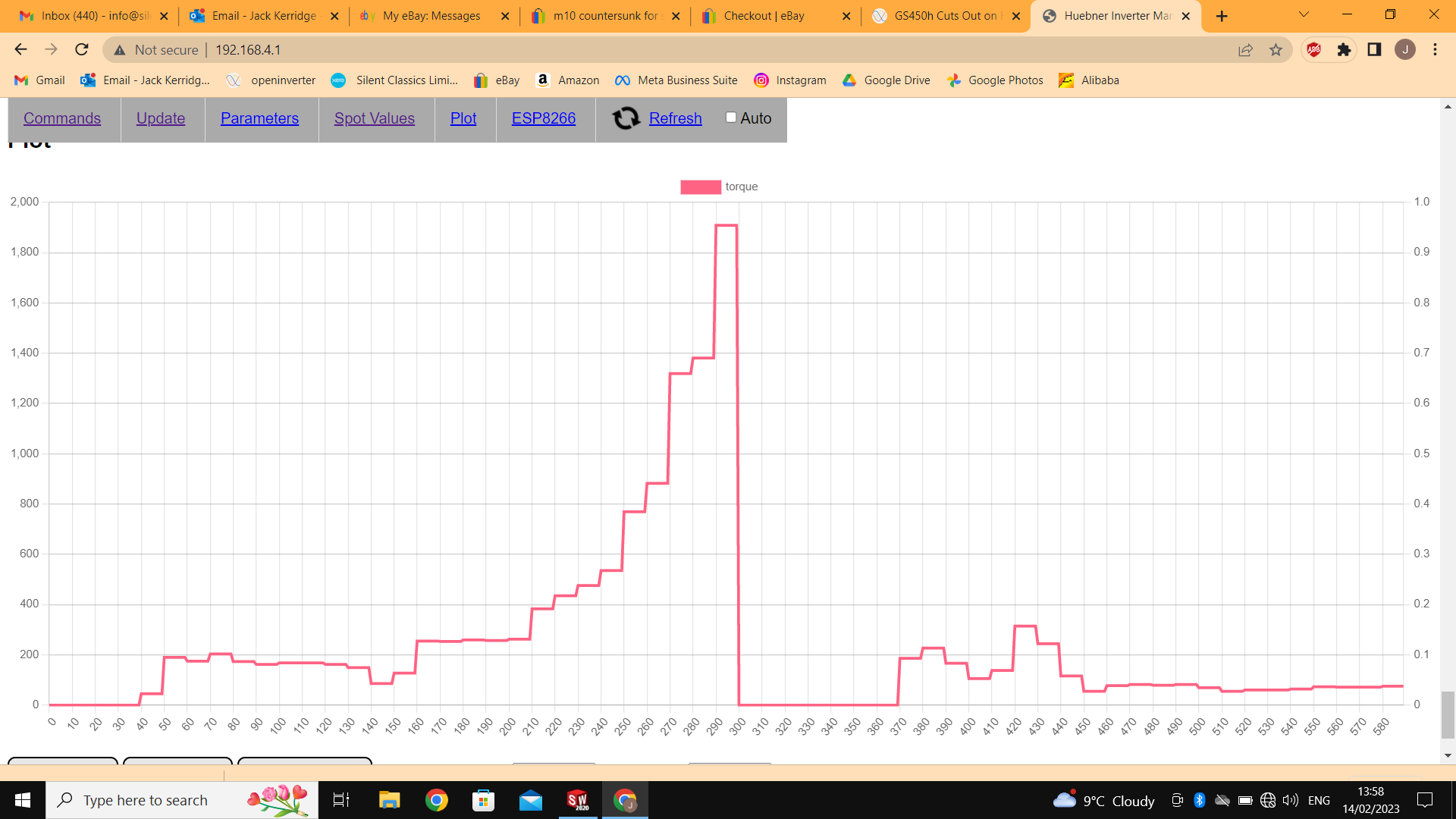

I have been chasing this problem for a while now.
Firmware version 1.10a Zombieverter
I have enclosed my parameter settings and 2 pictures of plots with differing speeds and throttle activation.
My observations are,
Even though MG1 and MG2 data are selected on the graph I can't see a plot for MG1 (top of graph).
The power plot (very low curve at bottom of graph, red) seems to show a jump then a flat line then a drop off before the Torque drops to zero.
Any thoughts or observations would be greatly appreciated.

Re: GS450h Cuts Out on Heavy Throttle Application
Maybe transciever is deaf? See if your can/control wires are twisted in the same direction.

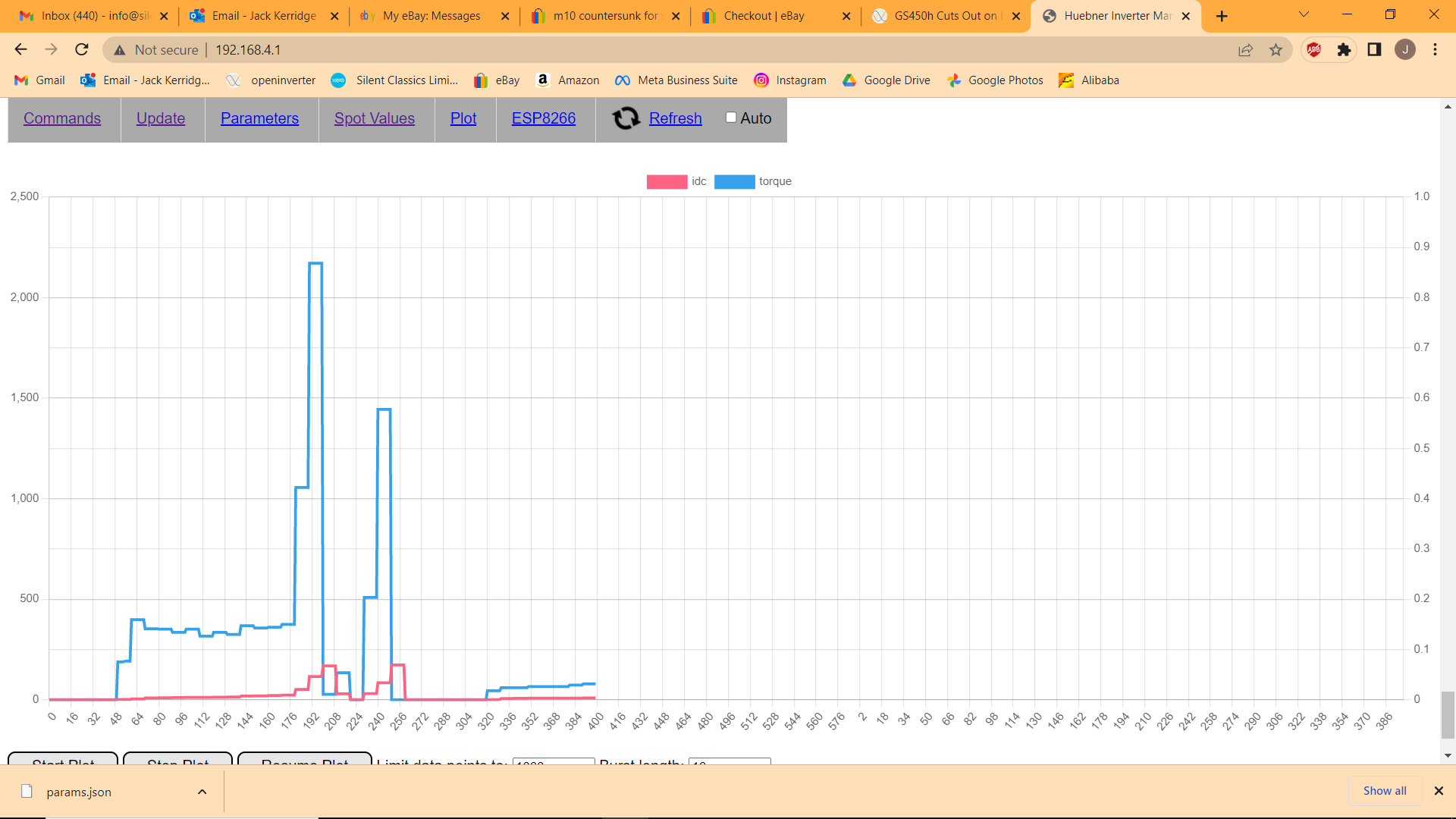

Re-continuing problem,
The plot included shows, Torque (Blue), Power (red) and Potnom (Orange).
I think this problem is related to the power of my battery pack, 52Kwh. You can see that the system is cutting in and out because of a limit.
Could the reason be that Damien is not seeing this issue is because his pack is 22Kwh and so he is not reaching the set limit?
I can only stop the cutting out by reducing my throtmax to 16% or below which makes it drive like a snail.
So it looks like something's pulling potnom to zero, and the inverter is reacting to that? Any errors stored?
Checked the connections on your throttle sensor? A loose +5V connection, for example, could have the pot output drop to zero intermittently.
How's your throttle pot signal getting to Zombieverter? (Direct analogue connection, or over CAN? Scoping the analogue, or logging CAN messages may 'prove' that the Zombieverter input is good/not good)
The 'speed' readout in your first images looks strange. Some large intervals between updates? Noise/grounding issues? Or is your inverter cutting out and resetting?
If your throttle signal is getting to Zombieverter cleanly, then yes, I suspect you're hitting a limit somewhere. I think it can derate based on inverter temperatures, HV voltage, HV and/or AC current, and your BMS may ask it to derate. All of those require parameters to be set.
Your udc, idc, temp parameters look sensible (what is your minimum and maximum pack voltage?) Check your udcsw value.
Have you (re)set the throttle parameters (potmin potmax throtmin throtmax throtdead) since the recent-ish change to their usage?
Have you plotted/logged udc, idc, temperatures during these cutouts? If udc goes out of range/currents get too high/temperatures get too high, it'll derate quite hard.
Worth running through https://openinverter.org/wiki/ZombieVer ... nd_testing again, just to make sure.

Re: GS450h Cuts Out on Heavy Throttle Application SOLVED
This problem was definately due to a hard cut off by the VCU. This may be a design point to stop the transmission being over powered. Unfortunately rather than tapering the power off there is a hard cut. This causes a massive shock through the transmission and could do more harm than good.
Having finally managed to get a compiled version of 1.10A with the line in util.cpp,
Throttle::IdcLimitCommand(finalSpnt, Param::Get(Param::idc));
edited out (//) I have a driveable car.

Hello all,
I have a gs450h zombie-verter and am experiencing the same violent cut in power.
I have just flashed zombie to V1.11A and sadly the fault is still there. Just thought id share that I am experiencing the same troubles.
I will try to resolve. If I get anywhere ill be sure to post on here.
Jack
Jack
UPDATE - I have just tested with removing the current limit from the code and it still unfortunately has the same issue.Jackk wrote: ↑Tue Feb 07, 2023 2:42 pm Hello all,
Jack
It only happens when I really boot it generally at higher RPM. it burns rubber just fine from standstill but there is less current needed to do this from what I understand so it does seem to happen at higher current levels.
Can anyone suggest what to do next?
One thing I'm reluctant to do is change my serial wiring (going to be a bit of a ball ache). The run of the wiring is relatively short id say less than 1m. They are twisted pairs but NOT shielded. Could non shielded serial wiring be the cause? My gut feeling is a code issue as others have experienced the same.
any suggestions would be great
