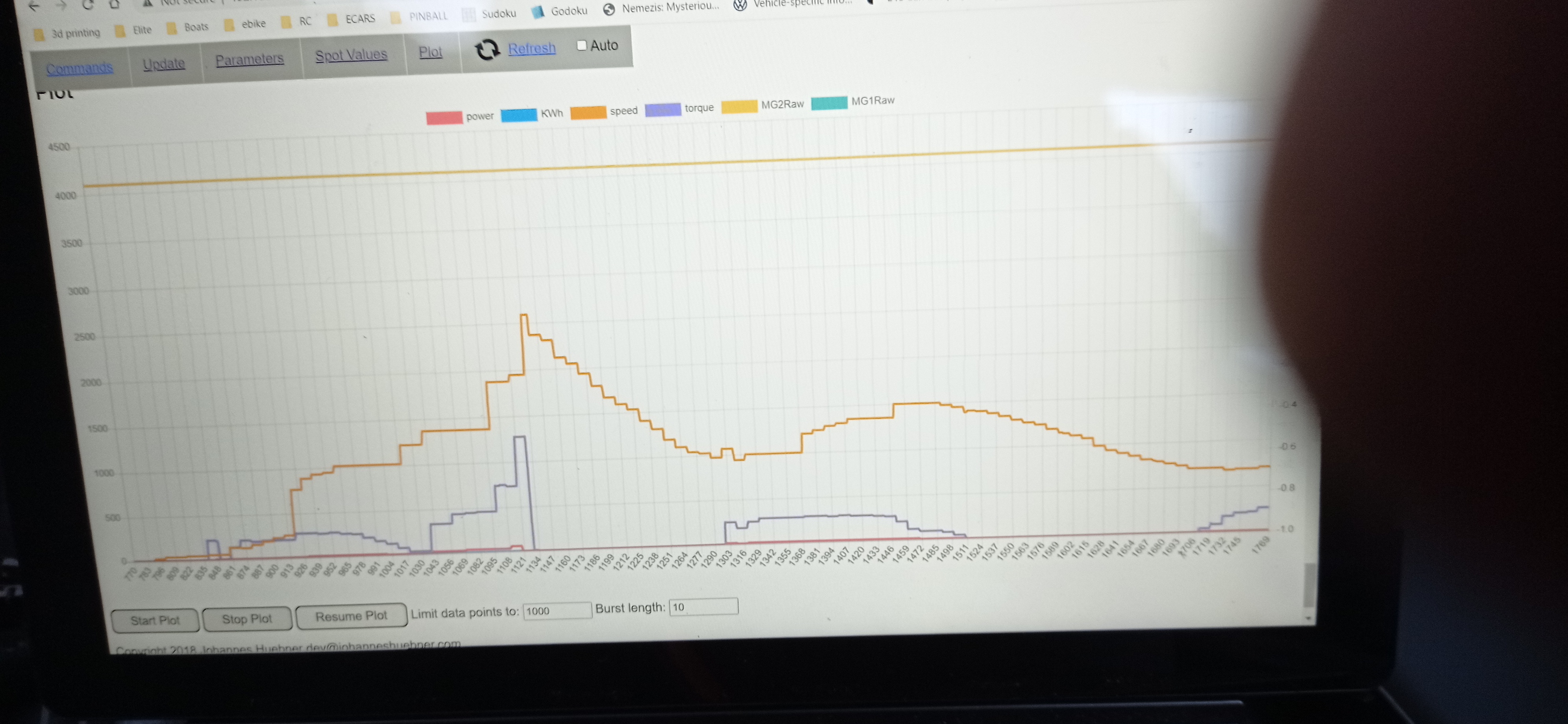

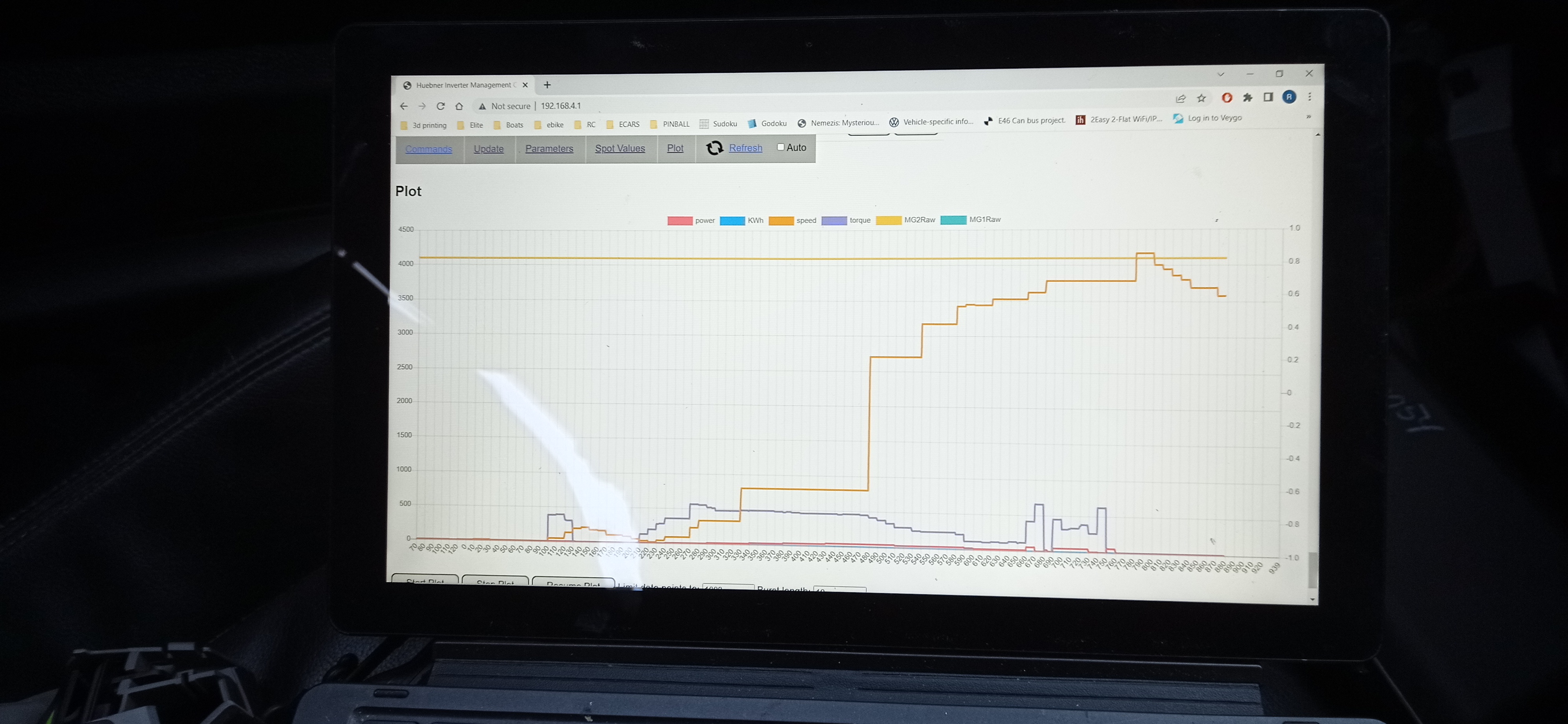

I have been chasing this problem for a while now.
Firmware version 1.10a Zombieverter
I have enclosed my parameter settings and 2 pictures of plots with differing speeds and throttle activation.
My observations are,
Even though MG1 and MG2 data are selected on the graph I can't see a plot for MG1 (top of graph).
The power plot (very low curve at bottom of graph, red) seems to show a jump then a flat line then a drop off before the Torque drops to zero.
Any thoughts or observations would be greatly appreciated.

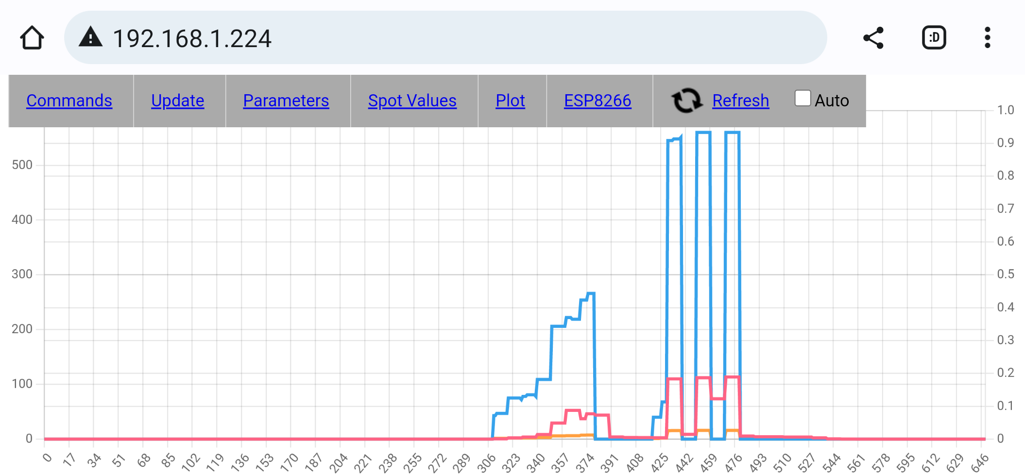

Re-continuing problem,
The plot included shows, Torque (Blue), Power (red) and Potnom (Orange).
I think this problem is related to the power of my battery pack, 52Kwh. You can see that the system is cutting in and out because of a limit.
Could the reason be that Damien is not seeing this issue is because his pack is 22Kwh and so he is not reaching the set limit?
I can only stop the cutting out by reducing my throtmax to 16% or below which makes it drive like a snail.
I have tried to edit out the line
310 Throttle::IdcLimitCommand(finalSpnt, Param::Get(Param::idc));
in the utils.cpp file to test this theory as per et0's post on 17th November but I am having trouble compiling a usable .bin file.
I must admit I am getting desperate as I have been chasing this issue for 2 months now. :?

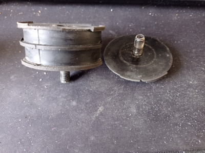

Regarding my previous posts about torque cutting, as per attached plot, the result of which is a massive negative load on the transmission, see enclosed gearbox mount image.

Hello all,
I have a gs450h zombie-verter and am experiencing the same violent cut in power.
I have just flashed zombie to V1.11A and sadly the fault is still there. Just thought id share that I am experiencing the same troubles.
I will try to resolve. If I get anywhere ill be sure to post on here.
Jack

UPDATE - I have just tested with removing the current limit from the code and it still unfortunately has the same issue.
It only happens when I really boot it generally at higher RPM. it burns rubber just fine from standstill but there is less current needed to do this from what I understand so it does seem to happen at higher current levels.
Can anyone suggest what to do next?
One thing I'm reluctant to do is change my serial wiring (going to be a bit of a ball ache). The run of the wiring is relatively short id say less than 1m. They are twisted pairs but NOT shielded. Could non shielded serial wiring be the cause? My gut feeling is a code issue as others have experienced the same.
any suggestions would be great

I have set my car as per Damiens video with the 1.11 update and it has fixed my torque drop. My RPM was set at 6000 and
the rev limit was noticable but not violent. Other settings when I drove the car were, as far as I can recall, throtmax 50% and throtramp set at 1.
I have not tried the car with any settings changed as yet.
Hope that helps
