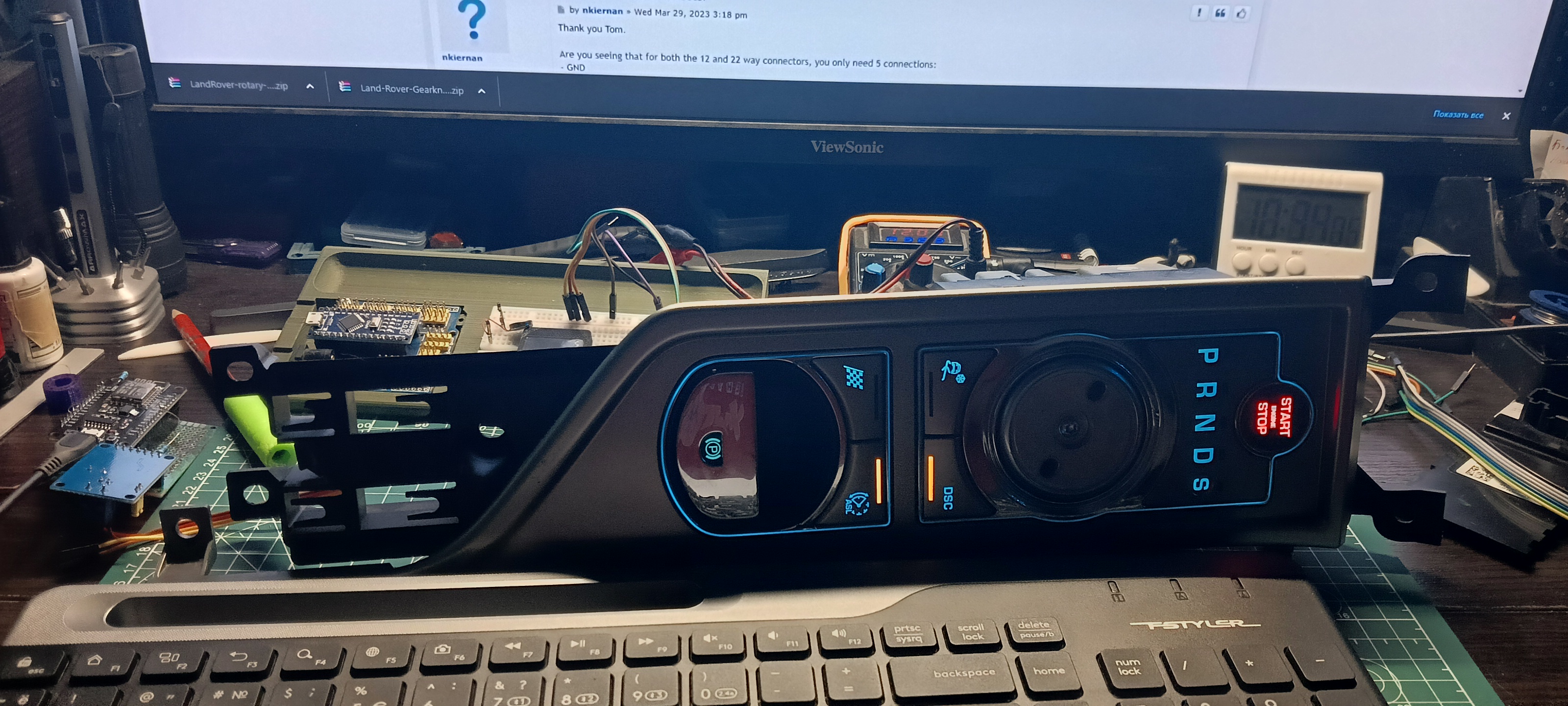

VanGogh
Posts: 41
Joined: Mon Apr 03, 2023 7:33 pm
Re: can id´s 4 Gear Selector
Post by VanGogh »
Hello friends. How long have I been looking for this topic in all the forums !!!! I'm trying to get it to work with a stepper motor for shifting gears in another car. I needed to find all the CAN bus codes and then I stumbled upon this forum. Happiness!!!
I found only 2 leds like in my picture

nkiernan
Posts: 560
Has thanked: 385 times
Been thanked: 81 times
Post by nkiernan »
tom91 wrote: Mon Mar 27, 2023 3:54 pm Arduino Uno with Canshield code to have full control of the shifter.
https://github.com/Tom-evnut/Land-Rover ... LRgearknob
Was having some compile issues (old CAN library installed, but when I updated to the latest, it required 3 arguments instead of the 2 used), so had to change below for my setup:
 while (CAN_OK != CAN0.begin(CAN_500KBPS, MCP_16MHZ)
to:
 while (CAN_OK != CAN0.begin(MCP_ANY, CAN_500KBPS, MCP_16MHZ)
Still to test on the gear selector

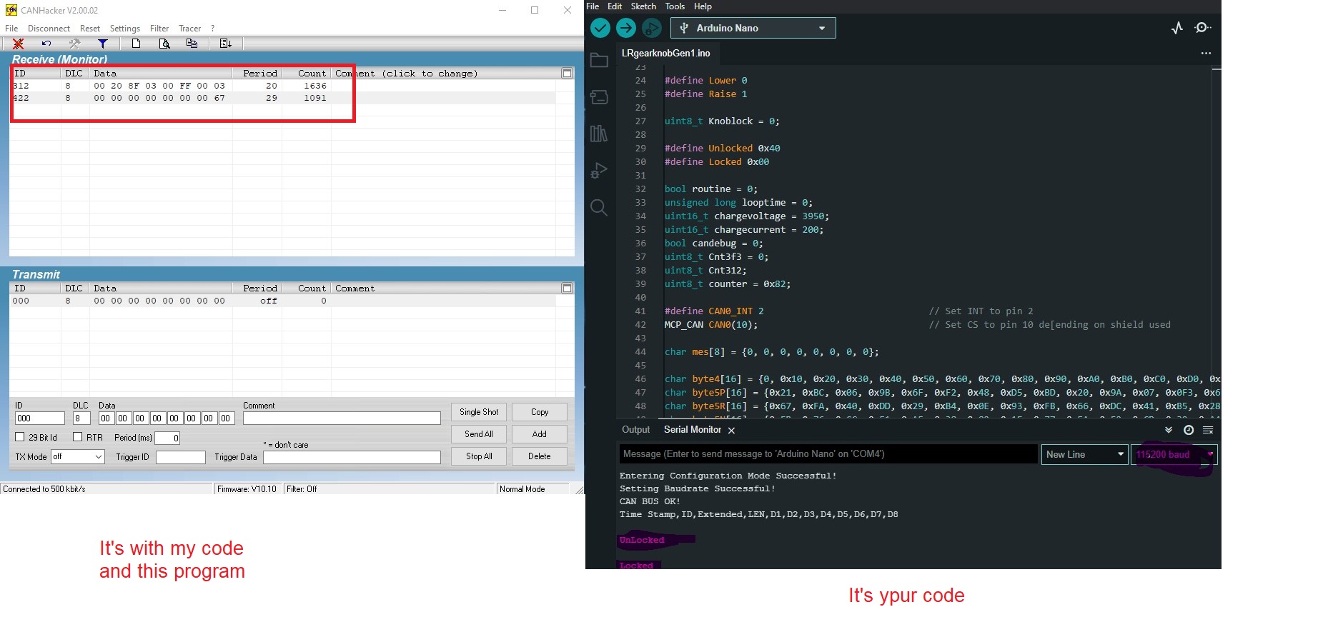

VanGogh
Posts: 41
Post by VanGogh »
I don't understand. Maybe my GSM doesn't work with this code? Because on the video of the seller from Aliexpress there is no mine. Does anyone have a video review of working GSM with arduino? How to make the knob move? I haven't been able to move it for 2 weeks now((((
I Send it the letter 'd', but nothing. Then 's', then 'w' and nothing(((
nkiernan
Posts: 560
Post by nkiernan »
VanGogh wrote: Tue Apr 04, 2023 8:08 pm I don't understand. Maybe my GSM doesn't work with this code? Because on the video of the seller from Aliexpress there is no mine. Does anyone have a video review of working GSM with arduino? How to make the knob move? I haven't been able to move it for 2 weeks now((((
Couple of suggestions. You have the CAN lines connected between the arduino CAN shield and the Jag unit and did you check the resistance between the lines ( approx 60R). Think I added a 120R resistor between the lines because my CAN shield didn't have the termination resistor.
You're applying 12V+ and GND to relevant pins and are you applying the 12V+ ignition signal also? When you open serial monitor in arduino and connected to the UNO, this is what would print when first powered up or reset (baud rate is set to 115200 yes?):
  • Entering Configuration Mode Successful!
    Setting Baudrate Successful!
    CAN BUS OK!
    Time Stamp,ID,Extended,LEN,D1,D2,D3,D4,D5,D6,D7,D8
Looking at the SerialComms function in the code, I don't think 'd' is specified as CAN debug? But 's' should raise knob and 'q' should lower it. I need to test but think when ignition is applied selector knob would raise (tbc).
Posts: 2410
Location: Bristol
Has thanked: 209 times
Been thanked: 572 times
Please show us your wiring setup, as wiring can be an issue.
Have you ever gotten canbus from it using anything else?

VanGogh
Posts: 41
Post by VanGogh »
Thanks I tried.
I have another code for arduino and used canhacker 2.00.02 to find signals without 120 ohm resistor. But he could not find the signals to raise the knob. Found your code and can't get any results with it. There is no resistance between the CAN bus contacts. I added a 150 ohm resistor and no change (or do you need 120 ohms?). I sent a letter 'w' and the port monitor says "UnLocked" and "Locked" but I don't hear the solenoid valve inside.
When I send other characters nothing happens at all
