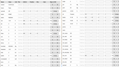

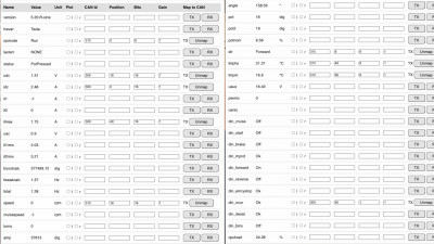

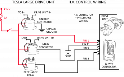

Thanks for the reply! I just watched your "Beginner’s guide to spinning a Tesla Large Drive Unit for EV Conversions" on Youtube. Congrats on the build! I noticed from your video that I don't have my encoder wired up yet. Could this be the issue?
Here's a picture of my temporary wiring setup:
I'm not seeing any errors on the interface.

Okay. So you need to follow the wiring diagram on page one of this viewtopic.php?t=76 thread and most certainly wire-in the encoder. Otherwise you will damage it.

First, before you do anything else, set tripmode=1 (Keep DC switch closed). Any other setting can cause serious damage to the inverter in the event that you hit an overcurrent error.
bkkona wrote: Thu Mar 09, 2023 5:53 pm I've tried setting udcmin and udcsw to 368 and 330 respectively, as well as 0 and 0. The rest of the parameters are defaulted to those listed here: https://openinverter.org/wiki/Parameters
You say you set the parameters to their defaults, but in the screenshots you seem to be using an LDU config. Did you apply the correct LDU config later? If you were running with defaults, that would explain why everything shut down when you started to apply throttle.
Next, you're seeing a DC voltage of 468.93. I assume this is wrong, but you need to work out why. Your udcgain seems to be correct (or close enough) but this voltage reading is way too high.
Next, you need to make 100% sure your main contactor is actually closing. Check the wiring here, and test the whole precharge / main contactor setup with the battery disconnected and test that each contactor closes when it should (using a resistance / continuity meter). I'm confused by your screenshots because the "ignition" and "start" documents appear to be identical (ie they're both BEFORE start).
Finally, in your 50% throttle screenshot, the voltage seems to have dropped to near zero. This suggests that something is still very wrong with your HV contactors. If the voltage drops when then the start button is pressed, then most likely your main positive contactor isn't closing, and you're losing high voltage when the precharge contactor opens.
Flashes and bangs from your HV system are very bad. The reason this happened is because you've set udcsw to zero. Please never do this when testing with high voltage. This allowed your main contactor to close without precharging when you attempted to restart, which will have caused a spectacular arc inside your positive main contactor, definitely enough to damage it, and also dangerous for the drive unit itself, though it doesn't seem you did any damage to that if it still works at low voltage.

Next, the LV contactors wiring from https://openinverter.org/forum/viewtopic.php?p=515#p515
12v+ from "Ign" to contactors. Your video link is now dead, so I can't see it. If your contactors are powered like this diagram, and the main positive contactor closes during pre-charge, then . . .
Boxster EV wrote: Wed Mar 15, 2023 8:50 pm There is either an issue with your LV wiring, or something awry with the board
