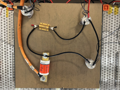

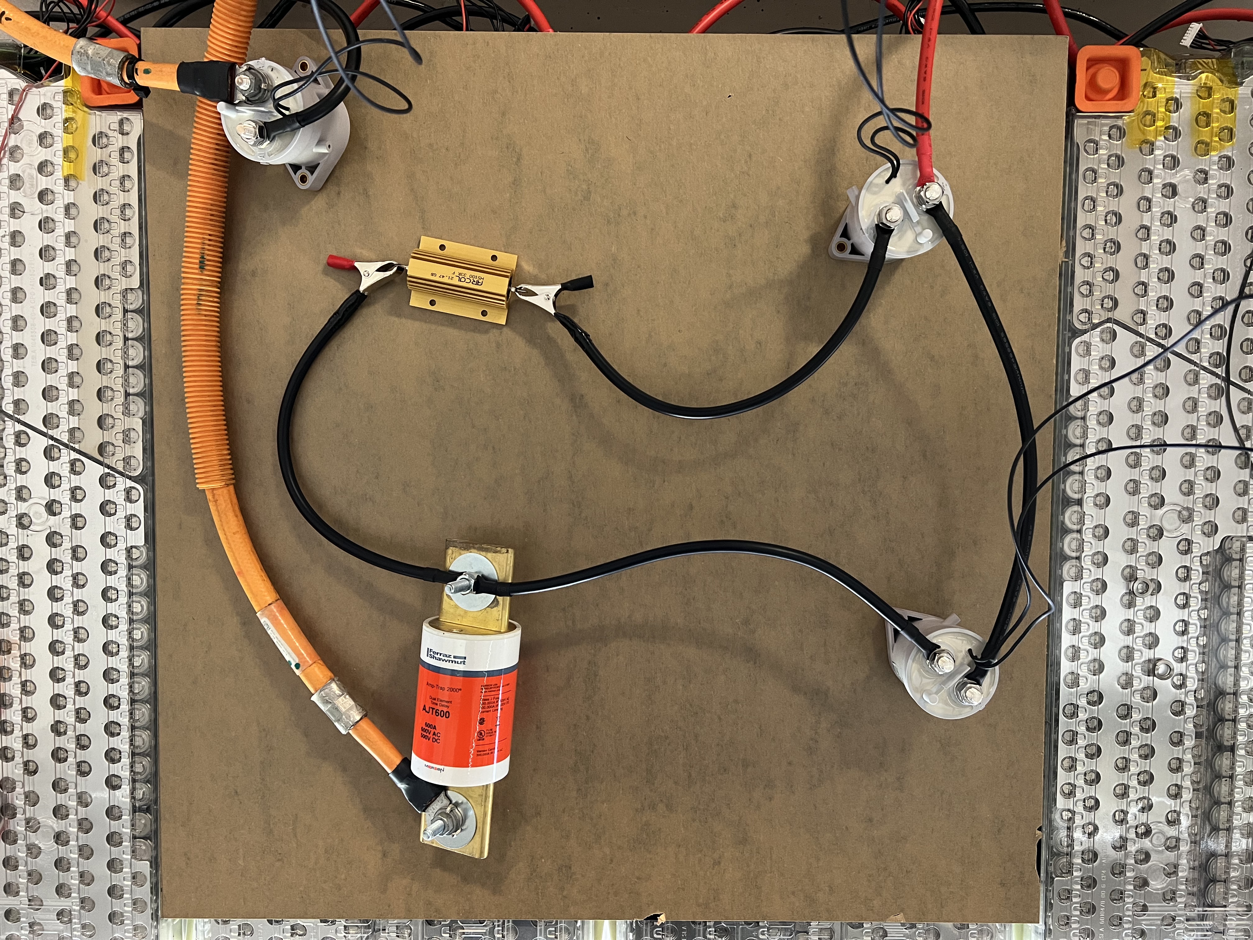

Apologies in advance if I missed the answer to this somewhere in the forum.
I have three TE EV200 contactors, an Arcol HS 100 watt / 33 ohm resistor, and a Mersen 600a 500v fuse making up the HV wiring.
The ignition contactor A1 terminal is connected to the 378v battery negative terminal and the A2 terminal is connected to the LDU negative terminal.
The main contactor A1 terminal is connected to the positive battery terminal and the A2 terminal is connected to the fuse, before continuing to the LDU positive terminal.
The pre-charge contactor A1 terminal is connected to the positive battery terminal and the A2 terminal is connected to the resistor, before continuing to the fuse.
All three contactors are being fed 12v from a power supply with the main and pre-charge also connected to pin 6 and 3 respectively. If I'm reading the HV diagram correctly, the wiring is verbatim.
I've tried setting udcmin and udcsw to 368 and 330 respectively, as well as 0 and 0. The rest of the parameters are defaulted to those listed here: https://openinverter.org/wiki/Parameters
I have a potentiometer wired as the throttle and have set the potmin to 16 to match the spot values I'm seeing.
When I first tried to spin the motor, nothing moved despite seeing the throttle values change. When I throttled up, say past 20%, I heard a contactor close. I tried pulsing 12v to start again and saw a spark, accompanied with a *pop*, coming from the direction of the HV wiring and battery. I checked the connections, didn't find any damage, but changed out the contactors with new ones. It turned out I had the contactor A1/A2 terminals wired backwards.
I'm reading 378v exclusively on the A1 terminals, however, on ignition, I'm reading 378v on both A1 and A2 terminals on the main and pre-charge contactors. When I pulse 12v to start, both A2 terminals lose 378v. What am I missing?
I'm still able to run the motor in manual mode, using a 30v power supply, with fslipspnt set to 1 Hz and ampnom to 20%.

What does the last error say within the interface?
Worth ensuring the contactors all work properly before connecting HV.
Got a good picture or video of your set-up?

Here's a picture of my temporary wiring setup: I'm not seeing any errors on the interface.

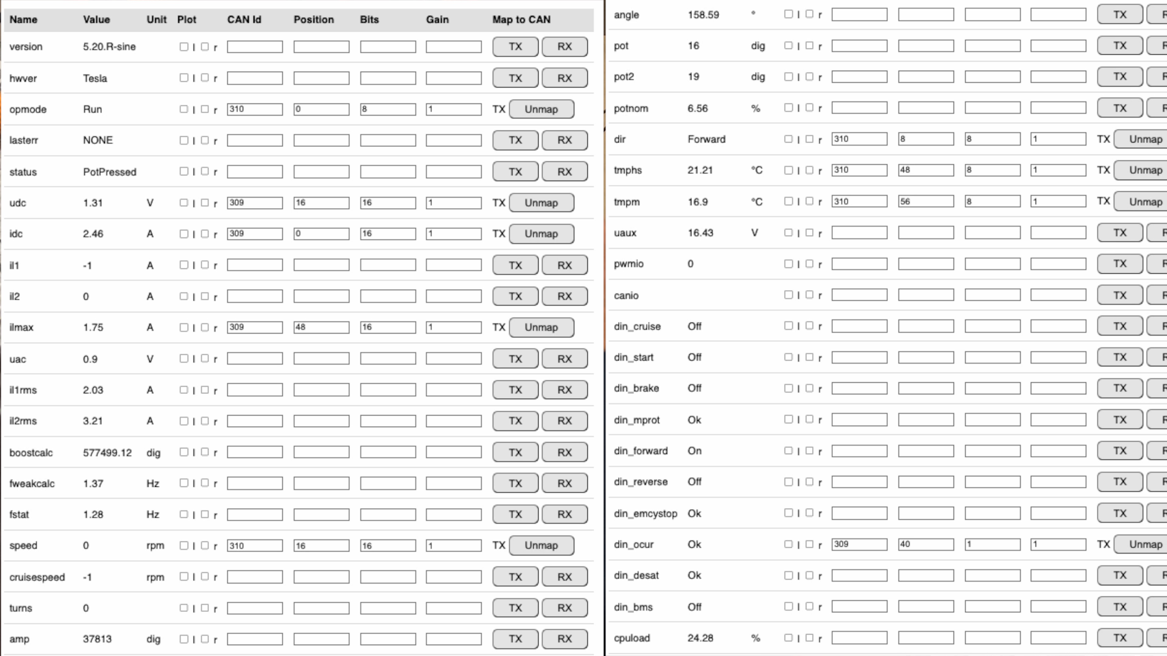

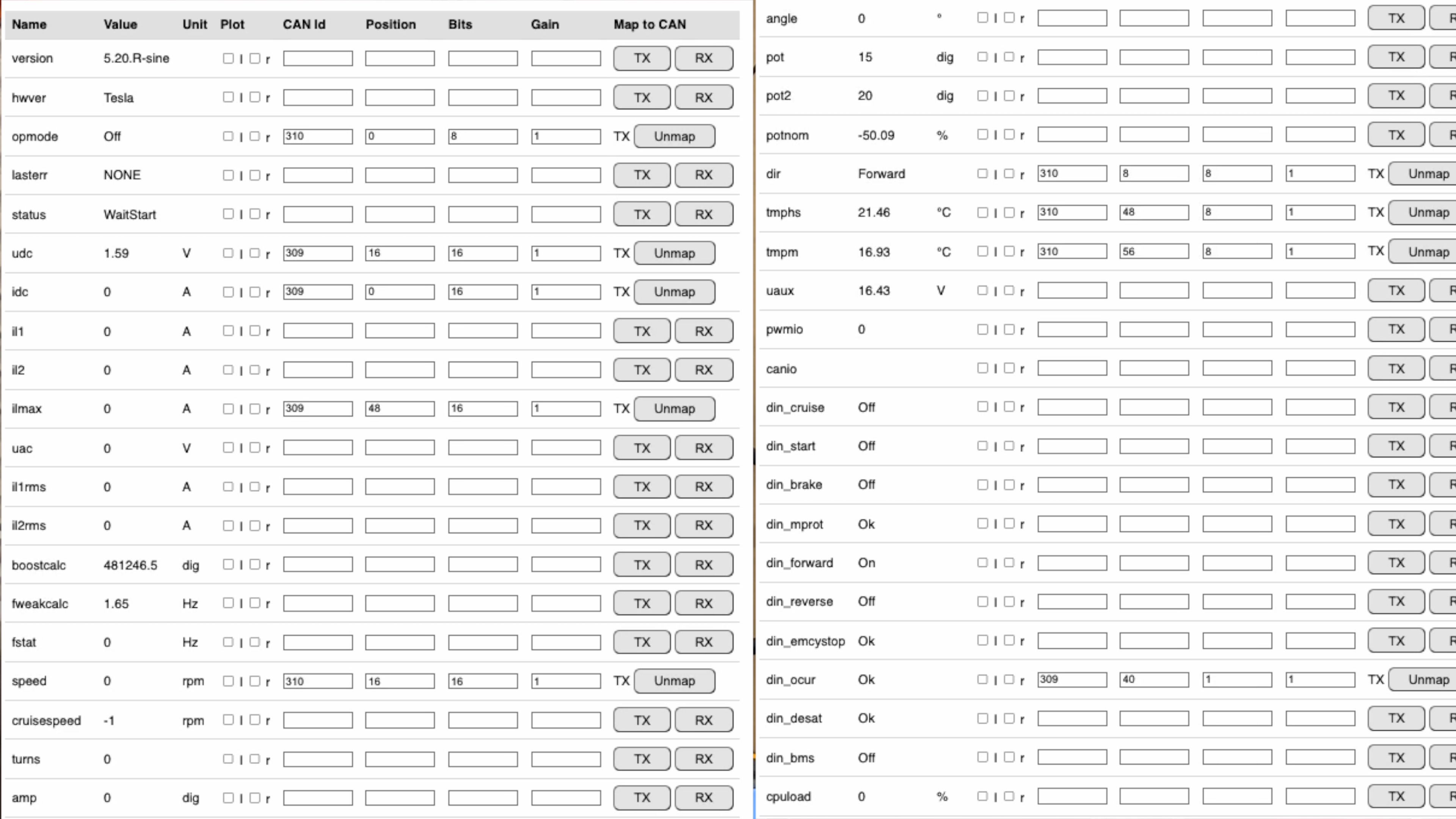

Here's the interface on ignition: Start: 50% Throttle:

Okay. So you need to follow the wiring diagram on page one of this viewtopic.php?t=76 thread and most certainly wire-in the encoder. Otherwise you will damage it.

First, before you do anything else, set tripmode=1 (Keep DC switch closed). Any other setting can cause serious damage to the inverter in the event that you hit an overcurrent error.
Next, you're seeing a DC voltage of 468.93. I assume this is wrong, but you need to work out why. Your udcgain seems to be correct (or close enough) but this voltage reading is way too high.
Next, you need to make 100% sure your main contactor is actually closing. Check the wiring here, and test the whole precharge / main contactor setup with the battery disconnected and test that each contactor closes when it should (using a resistance / continuity meter). I'm confused by your screenshots because the "ignition" and "start" documents appear to be identical (ie they're both BEFORE start).
Finally, in your 50% throttle screenshot, the voltage seems to have dropped to near zero. This suggests that something is still very wrong with your HV contactors. If the voltage drops when then the start button is pressed, then most likely your main positive contactor isn't closing, and you're losing high voltage when the precharge contactor opens.
Flashes and bangs from your HV system are very bad. The reason this happened is because you've set udcsw to zero. Please never do this when testing with high voltage. This allowed your main contactor to close without precharging when you attempted to restart, which will have caused a spectacular arc inside your positive main contactor, definitely enough to damage it, and also dangerous for the drive unit itself, though it doesn't seem you did any damage to that if it still works at low voltage.
You say you set the parameters to their defaults, but in the screenshots you seem to be using an LDU config. Did you apply the correct LDU config later? If you were running with defaults, that would explain why everything shut down when you started to apply throttle.bkkona wrote: ↑Thu Mar 09, 2023 5:53 pm I've tried setting udcmin and udcsw to 368 and 330 respectively, as well as 0 and 0. The rest of the parameters are defaulted to those listed here: https://openinverter.org/wiki/Parameters

To be specific, this situation means the precharge contactor is opening, but the main contactor is never closing. Check the wiring to all 3 contactors, particularly the main positive contactor.
Please fix your udcsw and tripmode values before you do any damage though!
I'd suggest making sure the contactors all work with your low voltage power supply before attempting to connect the high voltage supply again. Focus your attention on whether the positive main contactor is closing when you press the start switch.

- asavage
- Posts: 373
- Has thanked: 359 times
- Been thanked: 118 times
Re: Tesla LDU HV wiring

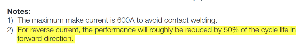

I can't tell where the leads that go off-screen go, they need labeling in this shot. I mean, I can see some components, but I can only see their wiring in relation to each other, not to the what feeds them or what they power.
While I'm not certain, I fear that you may have your negative contactor's HV reversed. You always want the more-positive lead to be on screw terminal A1, which means that on the negative contactor, the lead to your battery negative should be on A2 of that contactor.
TE's datasheet for the EVCnnn series is explicit about this:
I don't find that warning in the EV200's datasheet, but the arc quench mechanism seems to be unidirectional in most HV DC contactor designs, so maybe double-check your HV wiring.
In ideal circumstances, you're never making/breaking the contacts with any significant load, and the polarity issue is nil, but it's still good design practice to wire 'em the way the mfgr recommends, and TE builds a lot of EV components . . .
None of which has anything to do with your system's other issues, but this caught my eye.
Next, the LV contactors wiring from https://openinverter.org/forum/viewtopic.php?p=515#p515
12v+ from "Ign" to contactors. Your video link is now dead, so I can't see it. If your contactors are powered like this diagram, and the main positive contactor closes during pre-charge, then . . .
Boxster EV wrote: ↑Wed Mar 15, 2023 8:50 pm There is either an issue with your LV wiring, or something awry with the board
