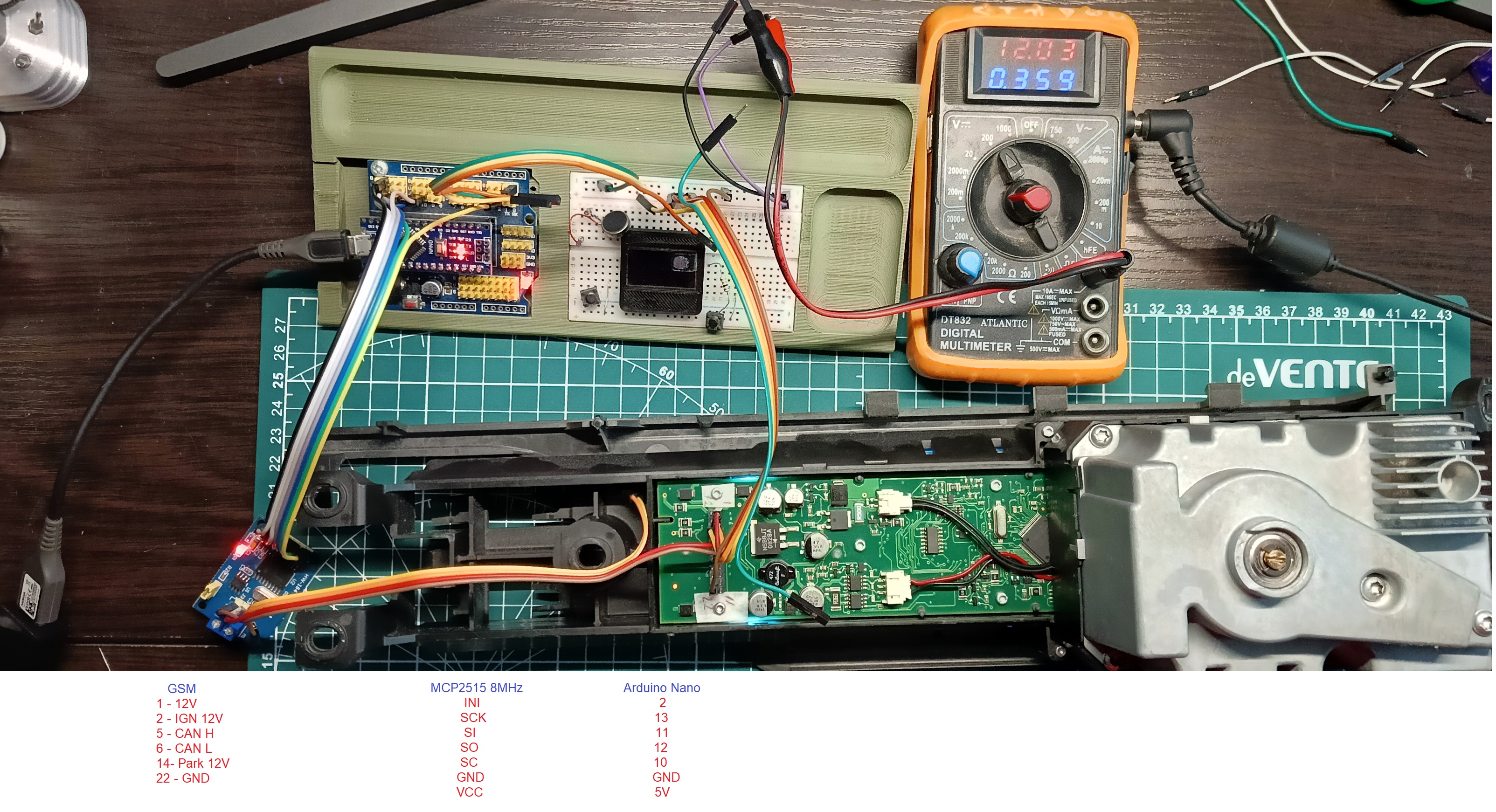

Maybe I bought a broken GSM? But if I apply 9V to the motor or solenoid pins, the knob rises and the solenoid releases its movement.

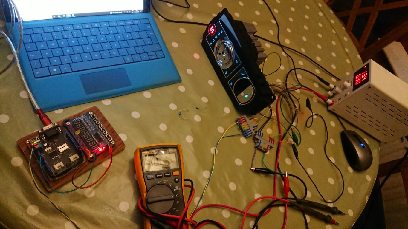

tom91 wrote: Tue Apr 04, 2023 8:51 pm Please show us your wiring setup, as wiring can be an issue.
Have you ever gotten canbus from it using anything else?
Loock at my first post Mon Apr 03, 2023 11:32 pm
Posts: 2425
Location: Bristol
Has thanked: 209 times
Been thanked: 578 times
Re: can id´s 4 Gear Selector
VanGogh wrote: Tue Apr 04, 2023 9:30 pm Loock at my first post Mon Apr 03, 2023 11:32 pm
You show pictures and the module tester. Do you have a module tester?
It is not clear how have it wired, as in all the wires.

My setup is wired as flowing:
Pin Signal
1-12V
2-12V (ign)
5-CAN H
6-CAN L
14-12V
22-Ground
With the Arduino sending the canbus, the knob will raise when ignition is supplied with 12V and will lower when it is removed.
You can even have the canbus not working apply power to all the 12V inputs then turn on the canbus or connect it and the knob raises.
The knob does not get raised based on canbus content it just needs to be correct and 12V "ign" needs to be provided.
I have removed the old bits of code from Gen 1 now as it confuses people they are artifacts from the Gen 2 knob where canbus can lock and move the knob up and down.

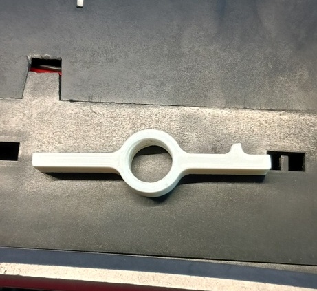

I bought this GSM on ebay and Lifting Gear Lever was broken. I printed it on my 3D printer and installed it in place.
Checked motor and solenoid. Everything works and moves. Maybe some microcircuit burned out and therefore there is no signal to the motor to raise the knob?
