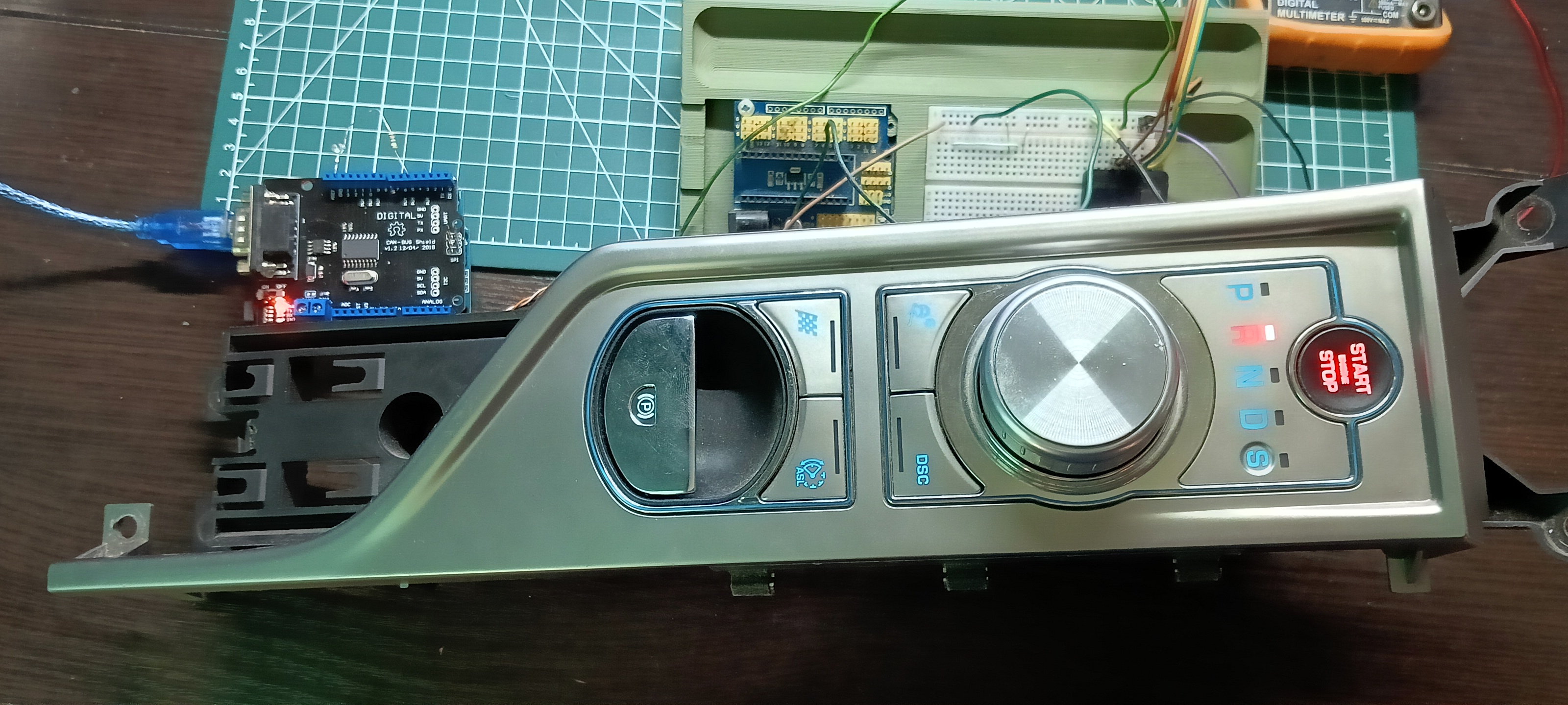

I'm going crazy!!! :x Bought a new GSM JLR EH22-7E453-AB. Uploaded Gen2 sketch to Arduino nano. Knob does not leave when sending 's'.
Connection: PC - USB - Arduino Nano - MCP2515 - CAN GSM.
Connection GSM:
1 - 12V,
2 - 12V (IGN),
5 - CAN H,
6 - CAN L,
10 -12V,
12 -Ground
What's wrong? Please tell me

That part number looks like mine which runs on the Gen 1 canbus messages. Try that script.
Unfortunately I don't have a Nano version for my script. But it's fairly basic so you should be able to port it over, or write your own based on that or Tom's code.

YEHAAAAAAA !!!! The second GSM works with Gen1 :D
Knob rotates and LEDs light up
But the first doesn't work at all (9X23- 7E453-DA)

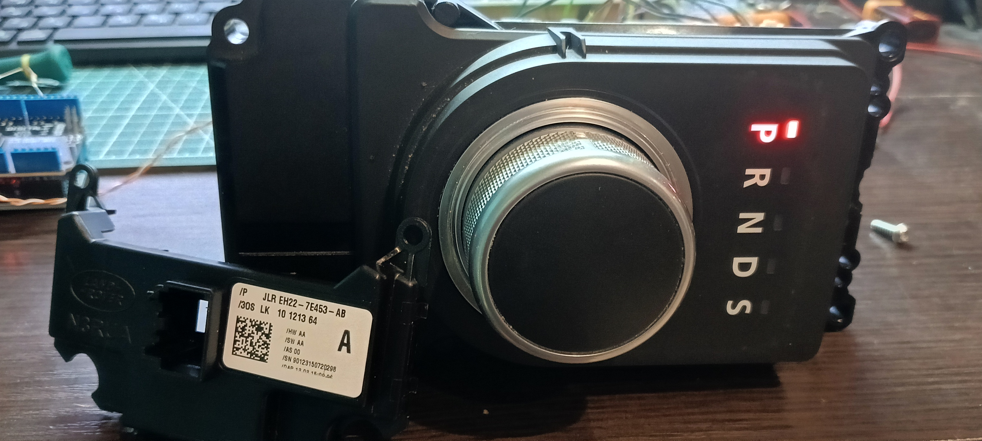

My joy was short lived. It was possible to launch only 2-3 times. 2 days I can not understand the reason for the failure to turn on. Replaced all wires, removed arduino dupont and soldered mcp2515 with arduino outputs. Replaced the TJA1050 chip but nothing. Sometimes the green light comes on.
Nothing helps.

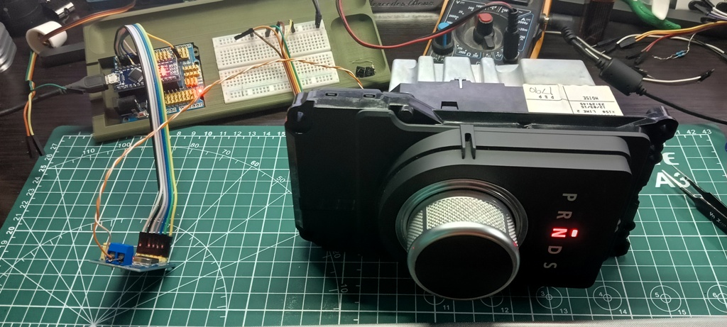

Hi.
I connected another NodeMCU with mcp2515 in parallel and read data between Aruino with mcp2515 and the GSM. Attached are 2 logs from different GSM. It seems to me that the Park wire (14 pin for a 22 pin connector or 10 pin for a 12 pin connector) is not working.
Jaguar.txt
(9.55 KiB) Downloaded 993 times
LandRover.txt
(5.64 KiB) Downloaded 856 times

Hi guys. I adapted LRBen's code for Arduino Uno with CAN shield. Now everything works, but there are a few nuances. When I return the knob from the R to P position, the program crashes for a few seconds and then it works again. Sometimes the situation is the same with position S.
Could you look at the code and help me? I also don't know how to add a brake pedal to lock/unlock the knob.
