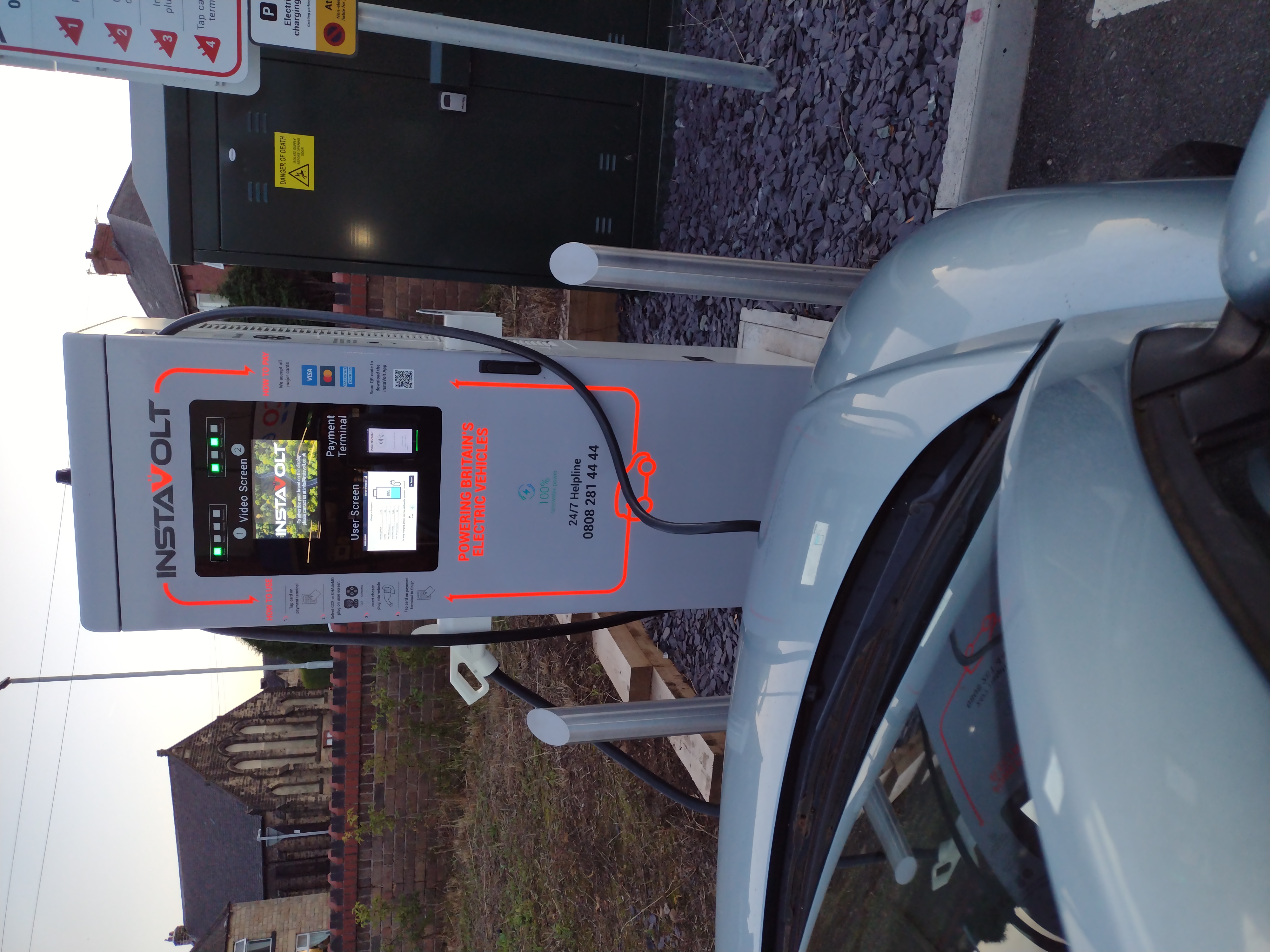

I'm struggling to get the BYD units on instavolt working, everything else seems fine, the other Instavolt units work, they seem to take ages for them to put 12v on the IN1 input too :S
EDIT - It looks like the current request never goes above 0 for some reason, but playing back the log of 108 and 109 my controller does start ramping the current request.
InstavoltBYDFail.csv
(58.84 KiB) Downloaded 385 times
Posts: 1787
Has thanked: 83 times
Been thanked: 431 times
I'm thinking it was a faulty unit?
Went to another BYD Instavolt and charged happily. Still takes a good 40 to 60 seconds for it to put 12v on Start 1 though.

These BYD units seem very flakey, I've always assumed it was my implementation, but now not so sure.
Looking at the log again, it doesn't raise the voltage to 450v before closing contactors for the isolation test, so maybe that's an indication that something's broken
