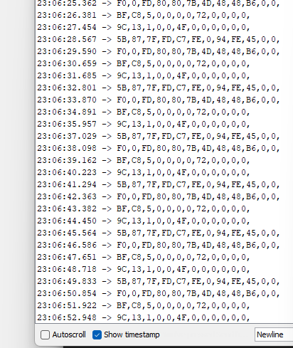

Oh My god, thank you so much, right on time as i was asking around for a sketch.
i will now play with and see if we have lift off.
thanks again.
Karim

golfdubcrazy wrote: Sun Apr 02, 2023 7:10 pm After making lots of adaptors and brackets im ready to start testing my AC setup. I decided to use a watercooled condenser and evaporator.
ESP32 for commutation. once i know its reliable and wont try to blow up anything I will put the code on my GitHub.
I have also found the actual datasheet for the pressure sensor will add it shortly needless to say the error i had from my data was 0.0001 :D 8-)

Hey Guys,
SO im back at coding and getting the Heater and AC compressor to work.
I copied Meuhl sketch and it was missing bunch of variables i added them up and now we have working Setup.
I can send the control messages and ping the response messages and the is spot on. Both control and response.
Here is the couple of issues i got:
1- it looks like i have a variation of the AC compressor. Mine came off Audi Etron A3 2017.
since i didnt know the messages i tried one by one from the IDs in the table previously.
I found the Status for this compressor is on ID27, ID Hex 0x1B and PID 0x5B.
now i cant find the control ID so dont know what to do else. i tried like i did on the status ID but it looks like the format on the control message is different than posted here. and the response message as well is reporting different than what the Byte should indicate so if im sending to an ID i don't know if it is the actual ID message cant see difference on the response message.
2- the heater message both control and response they are spot on. but im not sure if we set the power is it in hex or decimal?
or how we set the power level anyway on the heater ?
for the reference i attached a screenshot of the serial monitor for the messages. I powered them on and no HV is connected to any of them
as well the Part number of the AC compressor if it make any sense
12E820803D and the HW and SW numbers are 04 and 02 not sure which one is which.
any ideas how to proceed?

for the AC im using a diffrent SW/HW number and might need help as those Ids didnt match my ac compressor.
i verified the LV connection to match the donor vehicle. just the IDs are diffrent.
I managed to find the feedback/response for the compressor i got which is PID 0x5B.
and i can confirm that the baud rate is 19200 for that SW/HW revision.
that ac compressor came out of Audi A3 Etron 2017. and it is the same PN like posted here but only rev D
@muehl, do you have any strategy to try and get the control ID ? i tried sending the control message you put in your code to all the IDs but the feedback never changed.
HV was not connected.
thanks, Karim
Hammer, Duct tape, WD-40 that`s it :D
1973 Beetle with SDU swap.

i tried all the addresses one after the other to find the control address and noticed a change in the response to the correct one.
7yatna
Posts: 78
Joined: Wed Jul 06, 2022 2:49 am
Location: San Diego, CA
Has thanked: 5 times
Been thanked: 11 times
Re: VW A/C Compressor
Post by 7yatna »
muehlpower wrote: Tue Jul 04, 2023 7:52 am i tried all the addresses one after the other to find the control address and noticed a change in the response to the correct one.
i did the same thing but it looks like the control message format for my compressor is a little bit diffrent so no change in the feedback message.
i will take another try at it or i will go tesla can controlled compressor.
thank you for your help on the heater it worked as you mentioned.
