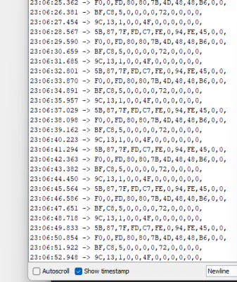

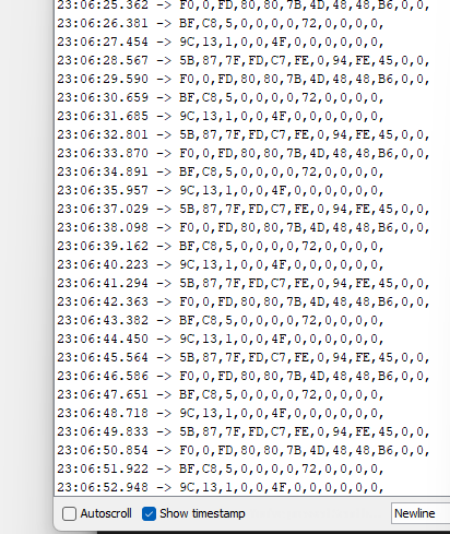

Hey Guys,
SO im back at coding and getting the Heater and AC compressor to work.
I copied Meuhl sketch and it was missing bunch of variables i added them up and now we have working Setup.
I can send the control messages and ping the response messages and the is spot on. Both control and response.
Here is the couple of issues i got:
1- it looks like i have a variation of the AC compressor. Mine came off Audi Etron A3 2017.
since i didnt know the messages i tried one by one from the IDs in the table previously.
I found the Status for this compressor is on ID27, ID Hex 0x1B and PID 0x5B.
now i cant find the control ID so dont know what to do else. i tried like i did on the status ID but it looks like the format on the control message is different than posted here. and the response message as well is reporting different than what the Byte should indicate so if im sending to an ID i don't know if it is the actual ID message cant see difference on the response message.
2- the heater message both control and response they are spot on. but im not sure if we set the power is it in hex or decimal?
or how we set the power level anyway on the heater ?
for the reference i attached a screenshot of the serial monitor for the messages. I powered them on and no HV is connected to any of them as well the Part number of the AC compressor if it make any sense
12E820803D and the HW and SW numbers are 04 and 02 not sure which one is which.
any ideas how to proceed?
need to identify the control message for the Compressor and the format for control messages both Heater and AC compressor.

Hi Guys,
here is an arduino scketch based on Muehlpower code i just added couple of things. this did control my heater and ran it about 720W. and it the log i posted earlier was from this code session.
for the AC im using a diffrent SW/HW number and might need help as those Ids didnt match my ac compressor.
i verified the LV connection to match the donor vehicle. just the IDs are diffrent.
I managed to find the feedback/response for the compressor i got which is PID 0x5B.
and i can confirm that the baud rate is 19200 for that SW/HW revision.
that ac compressor came out of Audi A3 Etron 2017. and it is the same PN like posted here but only rev D
@muehl, do you have any strategy to try and get the control ID ? i tried sending the control message you put in your code to all the IDs but the feedback never changed.
HV was not connected.
thanks, Karim
thanks, Karim
