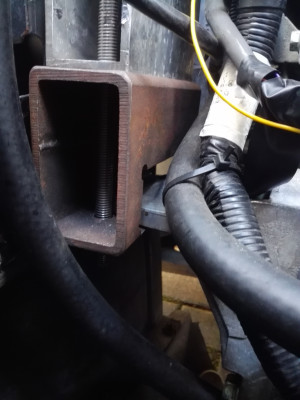

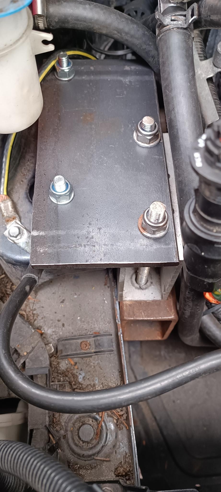

New motor mount!
And you know what? It still twists under load and touches the chassis :?

johu wrote: Wed Jul 26, 2023 3:10 pm New motor mount!
Yeah... I made all the same mistakes and i am mechanical engineer :(.
https://leafdriveblog.wordpress.com/tag/mounts/
You need to observe how the mount moves and then design a suitable box closed mount. The box will hold rigidity and the distance between walls will keep it from bending. I will assert you need a welder to do this, but when done it will hold.

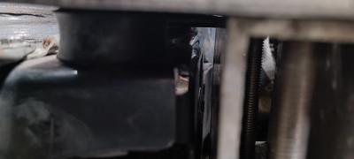

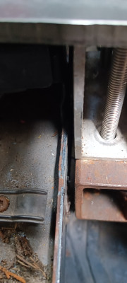

Not sure about welding here. The twisty part is this
The Nissan motor mount "tongue" only has one central hole and is made from alu.
I have more alu box but lost faith in it after the first attempt:
Since you asked
[media]https://openinverter.org/files/mount.mp4[/media]

OK... If you would remove the complete box and mount from the motor (!) and make a new CAD (cardboard) design of the arm from the motor to the car mount. You can then send me the drawing so i can make the arm from steel.
I actually got news my friend just got a Leaf motor here and it is EM57 so you can just make a rough design with dimensions between motor bolts and chassis bolts, i will take care of motor interface.
What you want is a mount that is as far from the chassis as possible. Ony from the top will it come in contact with the chassis mount/bolts. I recommend a Z shape. If you wanrt You can account for inverter mounting points as well.

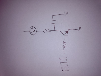

Bit off topic of your current discussion, but reading you wiki page for driving the fuel gauge. I've only get a single resistance for my sender, this schematic look like what you're describing?
https://leafdriveblog.wordpress.com/202 ... age-drive/
The point of the mosfet is to quickly put the dial in short in between the full/empty resistor. European cars normally have empty state at 330R and full at 20R. US cars in reverse.

Awesome. Thanks :D

Bigpie wrote: Wed Jul 26, 2023 7:50 pm Bit off topic of your current discussion, but reading you wiki page for driving the fuel gauge. I've only get a single resistance for my sender, this schematic look like what you're describing?
I've actually put the capacitor onto the transistor base, thereby the transistor is working in its linear region. Supposedly Tourans fuel tank sensor doesn't like PWM.
Now back to the motor mount. I ordered lower and harder rubber dampeners and these solve the problem as they don't let the motor move away so much. So I think I'll just leave it like that. You're still welcome to stop by :D When would that be?

johu wrote: Fri Jul 28, 2023 12:39 pm I've actually put the capacitor onto the transistor base, thereby the transistor is working in its linear region. Supposedly Tourans fuel tank sensor doesn't like PWM.
Don't suppose you could knock up a quick circuit sketch? Pwm'ing to ground bypassing a trim pot still oscillates. I've gone up to 20kHz but still jiggles. I struggle to understand transistors, can just about muddle my way to use them as a switch.

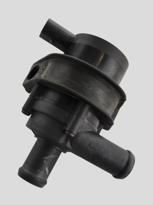

Repair day today. Since over one year I had occasional faulty cell readings on cell 90 and 91. They would come good for a second then suddenly one would jump up 100 mV and one down 100 mV. Quite obvious that this was a loose wire. I "fixed" the problem a number of times by poking around with a stick but of course it never actually cured it for long. The last poking action pulled the wire out completely so now I could no longer ignore the issue - power limits 0 kW and invalid SoC reading.
So today I put the car on a lift and dropped the front battery brick. It is surprisingly dirty on top and a few spiders nested there.
Anyway, when I re-arranged the cells from Nissans little towers to one single brick I needed to extend 4 cell tap wires by a bit and did so by inserting two wires into ferrules and then not using a proper crimping tool. I now use solder shrinks. That problem should be fixed for good or at least until I put in the next larger battery.
Plugged the car in for charging and noticed that after one hour charge power had dropped to 2.3 kW instead of 3.3. And also temperature had risen to 91°C. Oops. Went down and found the pump shaking but not pumping. Power cycling got it going again but on the next test drive it died again and couldn't be revived. It's the second pump of this kind (1K0965561F) that died on me:
Put in a little Bosch pump, lets see how that goes.

Did you consider using a larger pump? A pump that's not running at it's maximum capacity might live longer?
Were you using new pumps (cheap knockoffs?) or used original pumps?

I reckon cheap knockoffs because new and cheap.
It's a complete mystery how it can go wrong, it's brushless and the rotor is hermetically sealed from the stator. Maybe I'll open it.
Larger pump... I'll see as it would require some LIN or PWM to slow it down.

The larger vw Bosch pumps don’t need pwm ( although you can control them with pwm) if pwm pin is left unconnected the pump waits a couple of seconds then fires up at 100%, if the pump is dry and no load detected it will shut off again.
I swapped from one of those small vw copies to the larger vw Bosch as the small copy ones would randomly chose not to start
I run my larger one full speed, it doesn’t draw much more current than the little guy it’s no louder either

It seems that there are a lot knockoffs 1K0965561F floating around from AliExpress to ebay, I would say poor quality components

I must let the pump off the hook, it was my wiring. I joined to wires with ferrules and that didn't make proper contact because I chose the wrong size. Unfortunately I decapped the pump for finding out...
