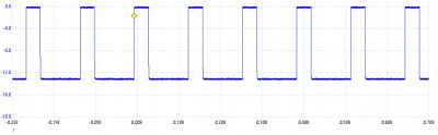

i intend getting voltages off of the DC/DC connector off the side of the inverter when i get a chance with either voltmeters and or with a picoscope. I have a Toyota Camry Hybrid 2012 on the lawn to test with. Will submit oscillographs here when i can.
I have just picoscoped either NODD pin 21 or VLO pin 11 of Power Management Control ECU and got the following mark space oscillogram. I think i have the wrong polarity. I could not tell because i did this work when it was nearly dark. will try to get more waveforms in next few days.
