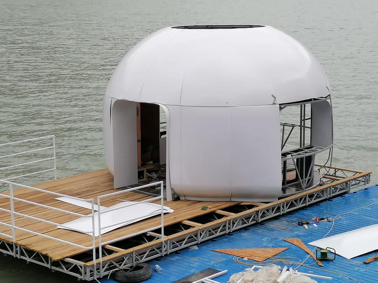

One more question in this direction. How do I enable the rotation speed control option, not the power? (this is important to me for use in a houseboat)

Re: question about bidir pedal control
Throttle speed mode, throttle sets speed rather than torque (also for boats)
this part of the description interests me))
bidir mode works fine.
but he controls the moment. it is not very convenient for rotating the propeller under water.
the described ability to control the number of revolutions of the motor instead of the torque would be ideal.
but how to turn it on?
cruise control = speed control
For a propeller it does work with speedflt=0 and speedkp=0.1, tested before on a boat.
it worked at speedkp 0.02 !
almost without hesitation.
Sorry, that cruise control stops working in this mode and it is necessary to make a control handle with a rigid fixation.
However, thanks anyway!
the following tests with higher voltage and already on the water!
I hope the house will float soon
