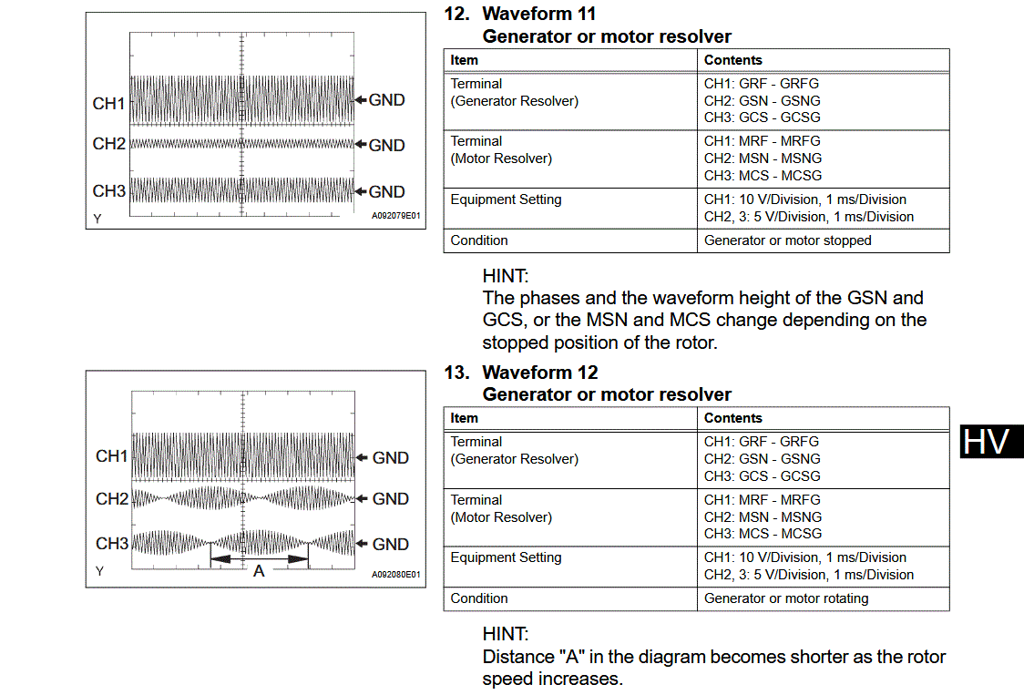

So while testing my updated stm32-car code, I've realized that the Toyota hybrid control ecu is not sending the can bus information I'm expecting because the ecu/car is not in ready mode.
I knew I would have to deal with this eventually but seems that time is now...
That leads me to two options:-
A) Spoof the inputs to the Toyota hybrid control ecu
B) Implement the functionality from the Toyota hybrid control ecu needed in stm32-car.
1) resolver/inverter
2) contactor/precharge charge voltages
3) Toyota BMS
1) shift leaver
2) key authentication
3) A/C control
4) All the other stuff I don't know I need yet...
I'll start with spoofing resolver/inverter. I've had a go at this in the past, but not successful
see [viewtopic.php?p=44241#p44241]. To trick the Toyota hybrid control ecu to stay in ready mode and drive, it has to get feed back from current sensors and/or resolver.
I've seen in [ Latula EV test his SDU card using a signal generator
I think my options are
I) By any chance is the Toyota hybrid control ecu sending any information over CAN that Open Inverter ecu can use as resolver information to drive the motor
II) Can Open Inverter ecu hw/sw be modified to use the resolver information generated by the Toyota hybrid control ecu
III) Update Open Inverter ecu to create spoof resolver information for the Toyota hybrid control ecu
Attached Toyota resolver information

OK, so this is the plan...
First attempt:
Use external excitation from Toyota VH ecu in OI
IO excitation is 9v peek to peek and 4.4 kHz
Toyota excitation is 20v peek to peek 10 kHz.
Plan is:-
HW:
1) Get Toyota excitation and resolver output down to ~3v peek to peek.
2) Get Toyota excitation in to stm32 (can I use "START" PB6/TIM4_CH1 see [https://github.com/jsphuebner/inverter- ... 2-v1.0.pdf])
SW:
1) Set OI excitation to 10 kHz (can this be done?)
2) Get Toyota excitation edge
2) Compare Toyota and OI excitation edge and add/subtract to resolverSampleDelay [https://github.com/jsphuebner/stm32-sin ... ncoder.cpp]?
20231120 updates removed OI resolver pico scope output (this was old data not OI resolver), both resolver output are kHz.
20231121 got an OI resolver pico scope output confirmed 9v peek to peek

turnip73 wrote: Fri Nov 17, 2023 9:10 pm 1) Set OI excitation to 10 kHz (can this be done?)
No luck so far changing the OI resolver excitation frequency.
If I comment out line:
https://github.com/jsphuebner/stm32-sin ... r.cpp#L471
      gpio_set_mode(NORTH_EXC_PORT, GPIO_MODE_OUTPUT_50_MHZ, GPIO_CNF_OUTPUT_PUSHPULL, NORTH_EXC_PIN);
there is no resolver excitation.
My assumption was that the interrupt frequency that sets the resolver excitation frequency was set some where above in the InitResolverMode function but I haven't figure it out yet.
Been thanked: 1918 times
Re: [FIRST DRIVE] Toyota Prius gen2 plug and play
Changing the excitation frequency is hard as it is indeed half the interrupt frequency of 8.8 kHz.
Not sure what you're trying to achieve on a higher level but if you want only excitation disabled you can switch to SinCos mode

johu wrote: Sat Dec 09, 2023 10:26 pm Not sure what you're trying to achieve on a higher level but if you want only excitation disabled you can switch to SinCos mode
I want to use an external resolver exciter from the Toyota HV ECU so both Toyota HV ECU and OI can use the resolver.
