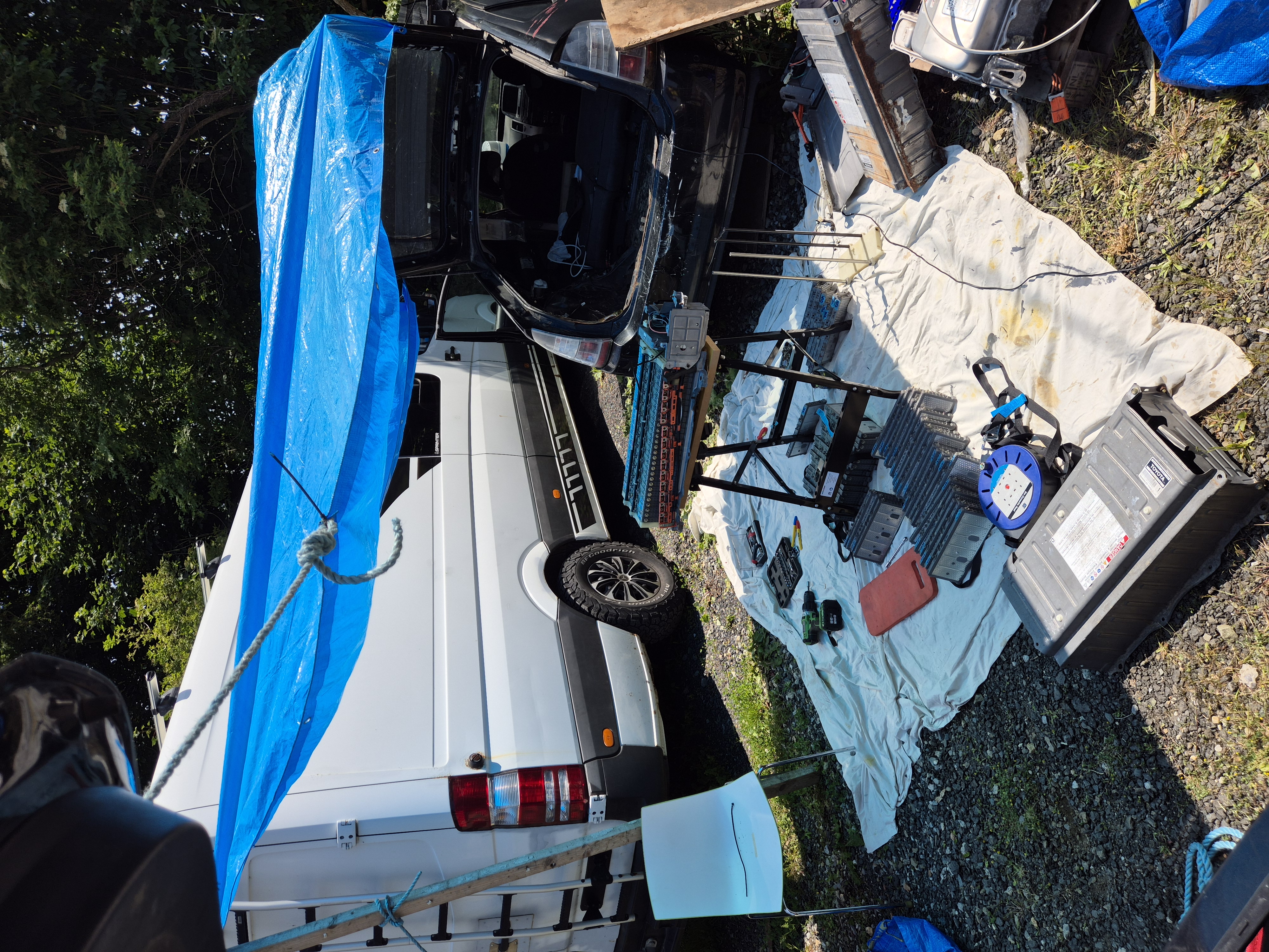

Had a busy couple of days working on the project. I replaced and balanced the cars original battery pack with some used ones I picked up. With the rest of the modules I started rebuilding a 2nd pack. I worked on the test setup for boost charging using the A/C inverter. I got as far as contactors closings and inverter and OI board in boost mode but ran into a issue. I was expecting the buck/booster converter to let power thought to the A/C inverter. I only have V1.1 cards and Johannes mentioned in a thread that the V1.3 will give you power to the A/C inverter and DCDC alt least in drive mode. I need at least 50V for the A/C inverter to start up or I fear it will just blow gates like it did for Johannes. Any ideas how I can get power to the A/C inverter to activate the gate? I also made a rudimentary web interface for the Battery ECU. The Current sensor setup also need some tinkering or maybe just use same setup as Johannes but that requires mods to the OI board.
